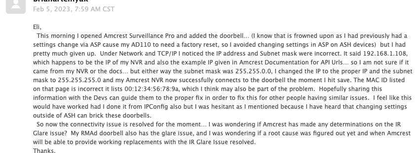

So I am seeing discussions regarding the IP address of the AD410 (192.168.1.108) so I just wanted to mention what I went through to help the next person who runs into similar issues.
- So I received my first AD410 December 30th, the doorbell itself worked fine both connecting to Home Assistant (Dahua Integration) and with Amcrest Smart Home. The issue I had was I was unable to connect the doorbell to my NV4216E-AI. No matter what did I could not add the doorbell to my NVR, every time it would behave just like my password was incorrect in the NVR Camera config, but would say "cannot find network host" (that may not be what the exact message was) when viewing the camera. I went through a lot of steps with Eli trouble shooting my network and wifi connectivity, both changing APS, switching whether it was connected to my Unifi AP, vs a different brand of AP with its own SSID, switching 2.4/5ghz, and even moving my Unifi AP to about 5ft from the doorbell. None of this allowed me to add the doorbell to the NVR. I was told that these doorbells do not work well with Mesh Networks and that was my issue.
My original contact with Eli was for the IR glare issue, but in the course of that conversation is when I realized I could not add it to my NVR.. so I had a replacement on the way for the glare issue and hoped it was a fluke and the new doorbell would work fine. It had the identical issue, worked fine in every aspect EXCEPT adding to my NVR. I tried the new firmwares as they came out, none of which corrected the issue. So I wrote it up as a loss and decided to just let the SD card record events and not add this to my NVR...
At some point February I was messing around again trying to figure something out and I opened the device config settings in SmartPSS (Dahuas version of Amcrest Surveillance Pro, I might have done ASP first then SmartPSS I don't really remember the particulars), I noticed that on the TCP/IP tab of the device settings the IP address was 192.168.1.108 and subnet mask was 255.255.0.0, now I was too surprised because I was aware that 108 is the default IP for Dahua/Amcrest devices, but I knew that was causing an issue because my NVR uses 108 (That was for ease of using commands out of the API docs in my early Amcrest days, I could copy and paste the urls out of the docs)... So in a last ditch effort I changed the IP and subnet mask and hit apply. The second I did that my NVR finally connected to the doorbell for the first time ever.
I shared this information with Eli on Feb 5th, shortly thereafter being notified that they finally had new stock that did not have the IR Glare issue (my first replacement still had the glare issue)
So I RMAd the second doorbell figuring now I knew how to fix the NVR connectivity issue so it wouldn't be a big deal. So when the 3rd doorbell came I attempted to do the same steps of changing the IP and subnet mask using Amcrest Surveillance Pro this time, it looked different (tried SmartPSS again also), the fields weren't populated as they were. So after a lot of messing around with SmartPSS, ASP, and IPConfig, hitting apply after populating those fields myself my 3rd doorbell now lost all network connectivity entirely. So after another factory reset it came to me that I had not updated the firmware on the doorbell yet. So ultimately trying to change those fields with the default 202210 firmware or whatever the original was will break your doorbell. After that factory reset, and firmware update with IPConfig, when going to the TCP/IP page of the device config in ASP those fields were finally populated as they were with 192.168.1.108, and subnet mask of 255.255.0.0, changing those to the doorbells correct IP and Subnet Mask, hitting apply instantly connected the doorbell to the NVR again.
My apologies if this is a long-winded and poorly written story, but just wanted to share my extremely frustrating couple months with these doorbells... so my IR glare issues have been resolved and I no longer have NVR Connection problems. Just wanted to share this so it can help people with similar issues, I know I did see a couple of others with NVR connectivity issues, contrary to Amcrests suggestion that the doorbells "Have trouble with mesh networks" this incorrect IP address and subnet mask was ultimately the cause for my NVR connection problem.
