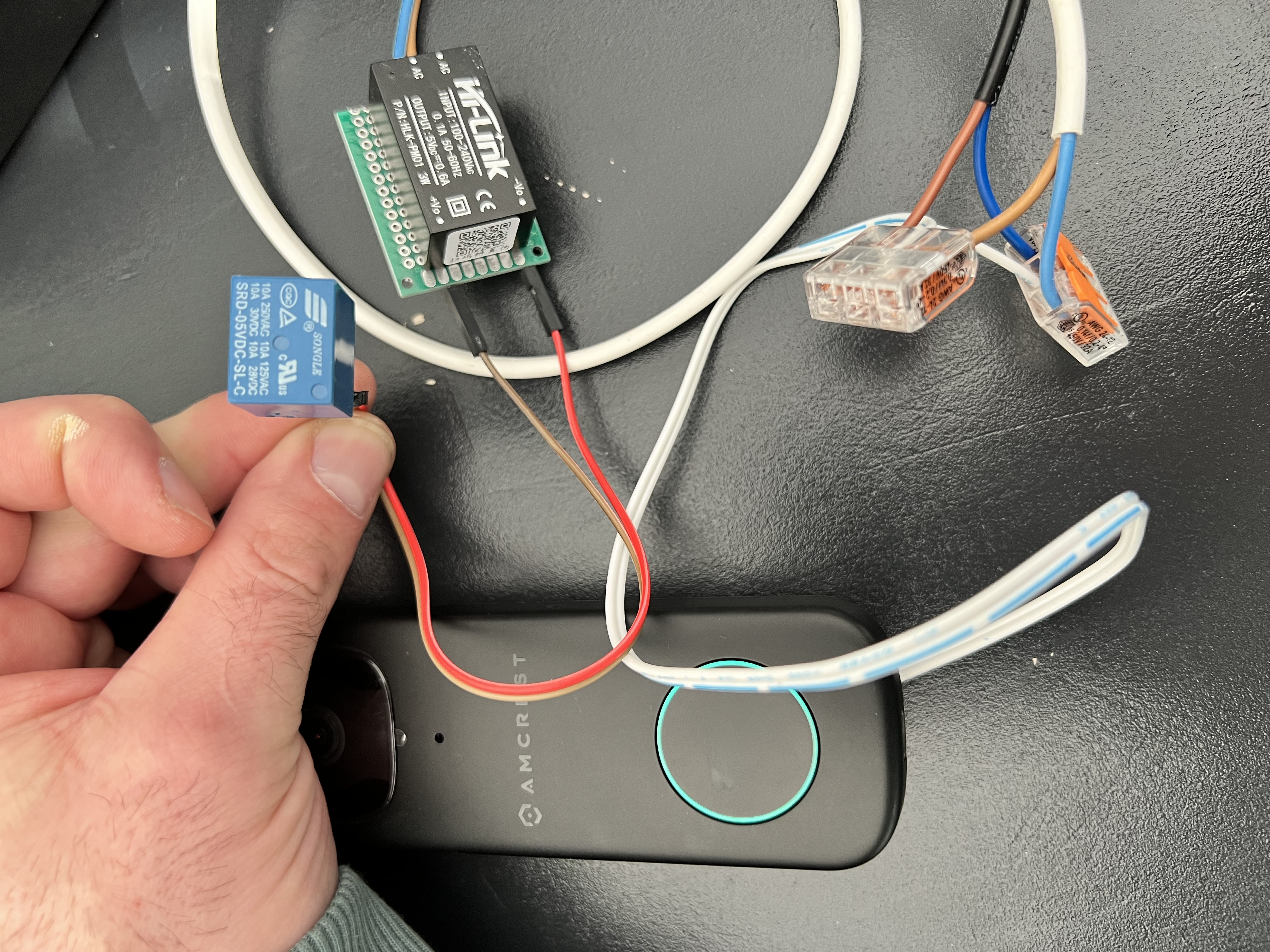

So if you want know when someone push button just active Amcrest Chime mechanic and make this assembly after each push contact blue change and you can surv with raspberry or other with gpio input mode and python script

That is an interesting approach you've come up with to monitor button push. But since you've mentioned using a Raspberry, you should look into Home Assistant or amcrest2mqtt. Button press and motion/human detection API events can trigger any automation/alerts you want - no clever electrical gizmo's required.

Yes with firmware can do that and last firmware can't .... So I make this assembly and he works very nice it's like chime but with little adaptation

I'm amazed at your inventiveness - as well as your impatience for a support reply!

And now I have doorbell full HomeKit HKV with rtsp record 24h/24h and two way audio on home apple and it’s wonderfull
