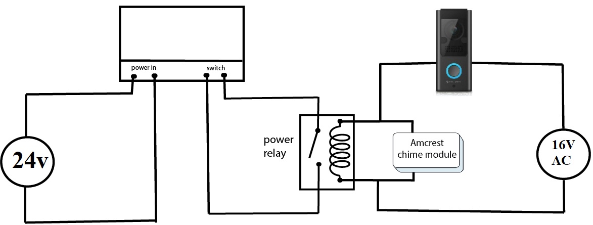

pcassidy, did you get the AD410 to work with your intercom? If so, how did you hook it up? My intercom (Nortek DMC1) behaves as you describe yours.
Re: DC Connection to AD410
My guess is you will want to pick up a ac relay and connect it like this.
However I am not sure how they have it setup so you might want to do some testing at the Intercom box of the button press. You may want to use a really good meter like something in the in Fluke family as a cheap meter might tell lies.
The reason for this testing is to check to see if there is a Voltage, or some type of Reference to voltage or ground. Meaning at times there are hardware devices that won't communicate with one another on just a normal Open and Closed switch loop. It might be looking for 15oHms. or some other value and just a closed switch might be ignored.
