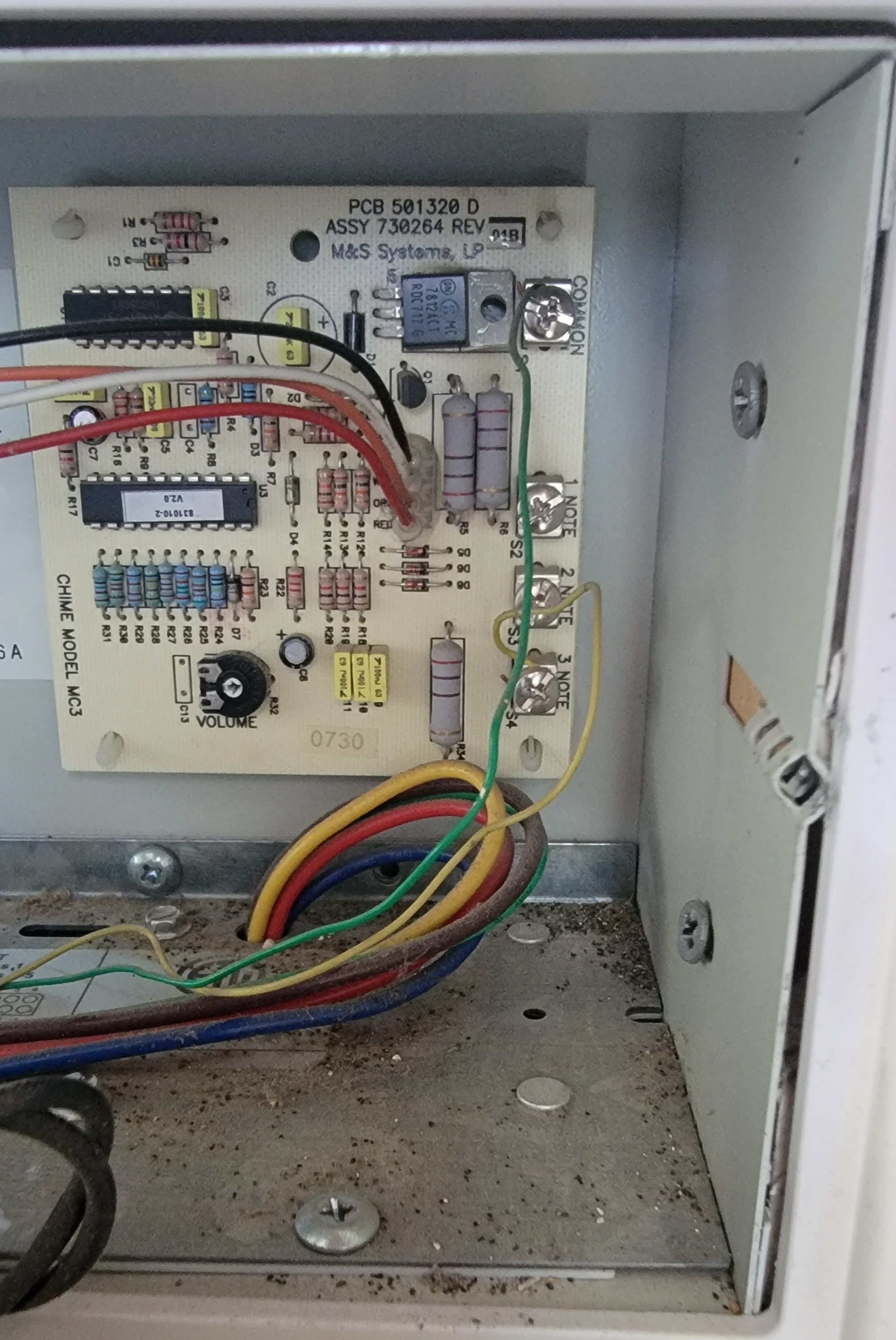

The doorbell pushbutton switch is connected to "Chime Module MC3" inside the intercom box via a green wire and a yellow wire.
The green wire connects to a Chime Module terminal labeled "Common" which is within 2 mV of intercom ground. The switch closes when pushed, bringing the voltage on the yellow wire's terminal down to ground potential (from 22.5 V) and the intercom chime module plays a doorbell sound over the intercom.
So your diagram seems that it should work fine as long as the AD410 expects its chime module to be in series with its power line and the AD410 chime module momentarily energizes the added relay in response to the AD410 button being pressed.

Yes, the door module has four wires. Red and black go to the speaker, green and white go to the button. The red and black connect to the intercom main board, the green and yellow connect to the chime module.
I shorted the yellow wire to the green wire right there at the chime module using a clip lead and it produced the intercom's chime sound. I'm pretty certain that the pushbutton switch is a lit (although the light is long since burned out) momentary short circuit switch, but will test the resistance tomorrow. I tried that earlier today but couldn't get a good reading due to oxidation on the switch screw terminals. I'll measure the resistance at the chime module terminals to get the wire resistance too. And will back the wire resistance out by connecting the green and yellow wires at the door module.

The doorbell switch resistance goes to just over one ohm when pressed. The wires between it and the intercom chime module add about 3.5 ohms.
