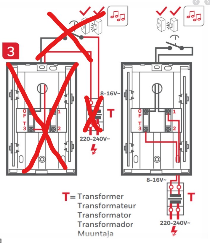

i have the AD110 doorbell connected and working but i had some problems with the chime kit so i have it running without my internal doorbell.
1. do i need the chime-kit with internal doorbell?
2 . i have this wiring, attached pic the one to the right! were would i connect the chime kit?
thanks Erik

so understanding this right, connect kit to 0F and 1?
Re: chime kit wiring
a small update, it works fine without the chime kit and connecting it to 0f and 1 on the existing chime works but also then chimes every ten seconds. i have a feeling that the wiring is old and really thin cables mybe replaceing them might help.

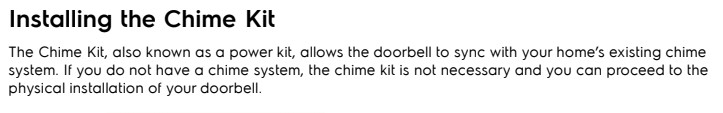

thanks for the explanation, but qouting your statement above "You don't understand.. The CHIME KIT is needed 100% without or with a Doorbell..." well i have had the device hooked up without chime and chime-kit for 8-9 months and its been working fine but i was missing my indoor chime. it clearly states in the usermanual the you dont need the kit when only running the camera without indoor chime!
but back to my original question how is the chime-kit supposed to be wired with my chime as described in the first pic. im gonna try to replace the thin cables and connect to 0F and 1 see if that works better.

OK Sorry I can't say what the Manual says seeing that it was what I used to say from what the manual said and as I said I used to tell people it wasn't needed...
HOWEVER I have since tested this and I can tell you that while you might get away from using a CHIME kit without damaging your Transformer I personally will not use it without..

However about connecting your Chime Kit.. It is hard to say... YOur system isn't the NORMAL F T B and I am going to guess that it would stll need to go across the terminals coming from your Transformer... Other then that I am not sure as it isn't a Normal Setup...

It looks like I have the same or similar chime. Was there a conclusion on which terminal to connect the chime kit?
John
