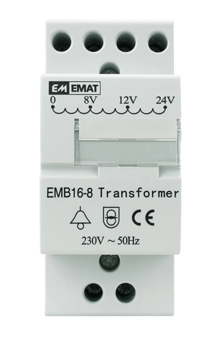

My transformer is a 8 - 12 -24 one, so it's on 24. I understand by reading this post, that could be the problem? (blown my chime kit?)
this is my transformer;
Scherm­afbeelding 2023-01-15 om 18.12.34.png (566.43 KiB) Viewed 2982 times

I personally don't know this Doorbell and have not had any luck to buy one to find out what and why or how it should work with this doorbell. 1 Do think that one of the issues is or can be that 24 vac is over voltage to this doorbell as it looks like it says it should be 8-16v and while it could work 24 normally with just a simple press of the button it might really be a bad thing if it was someone that might go up and hold the button as it would more then likely get enough of the over voltage to be an issue.

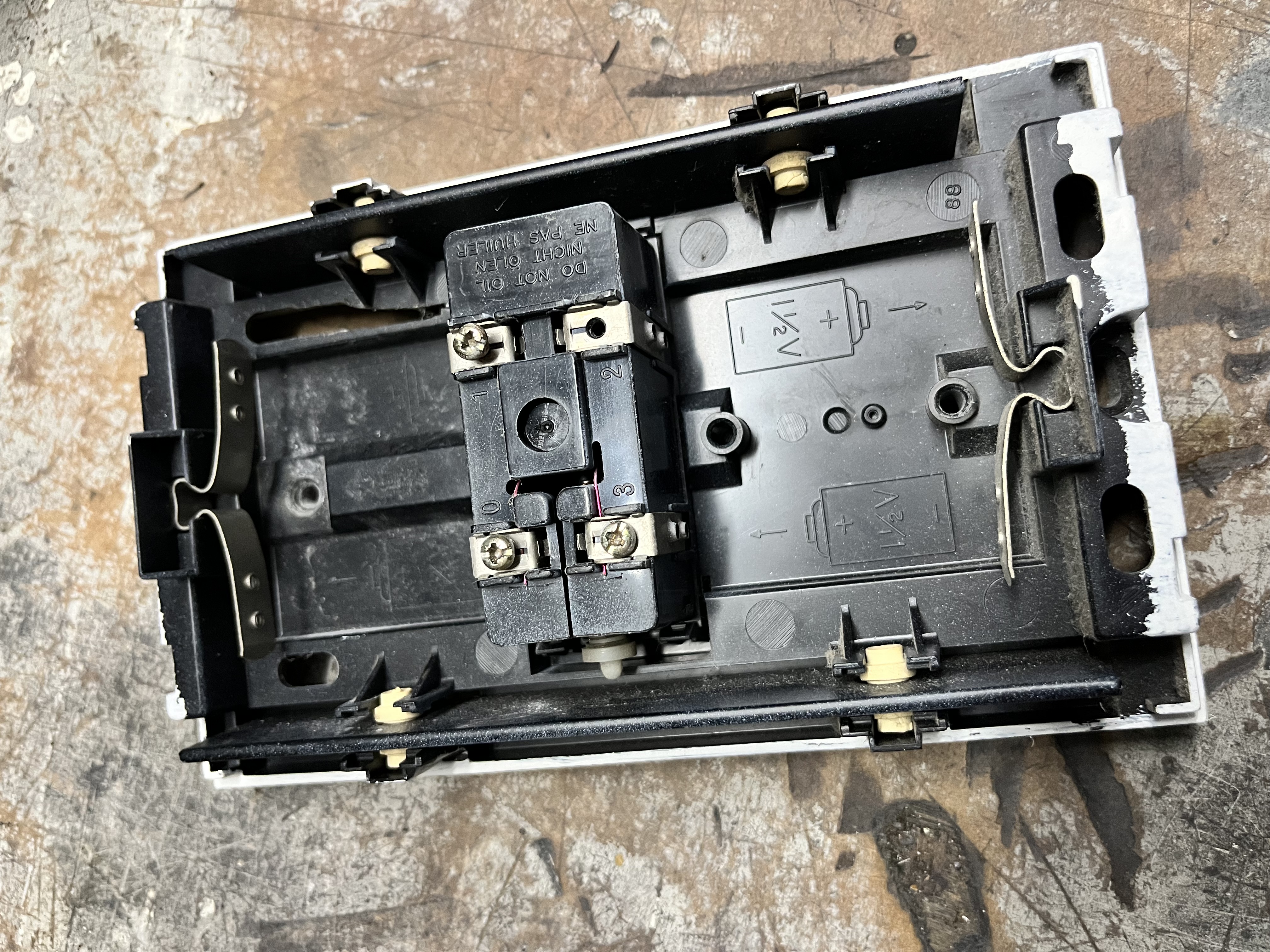

Main issue is. Your doorbell has 2 areas where the transformer connects and normally that isn't how the systems work. Normally there is 1 wire that goes to the T and the other wire that is going to the Button at the front door has the second wire from the transformer. then the second wire form switch going to the F on the doorbell. Then when the button is pressed it Completes the connection for the doorbell to make it's sound. So then the question is where to put the Chime Kit? Well normally it would be at T3 and Of. is what I would guess. However that would be what is X in the first picture really and is why this Doorbell is confusing. It makes me wonder what is going on in the doorbell itself. Is there leakage voltage at the OF terminal or is 1 and OF just causing the latch?
To be honest, I think the Picture where it is X out I think that is how it should be wired for the Doorbell Camera. Making that is easy. Connect the 2 wires that are going to 1 together using a Wire Nut or Waga Lever connector Without connecting to (1), and connect the Chime kit to OF and T3. I would double check the Voltage on the Doorbell because it looks like 24 is to much and needs to be 8-16v
Re: chime kit wiring
It might be like one of my Transformers that it does have 16vac by connecting to 8 and 24 as it causes the Voltage between. In that case then your fine as long as your using the 16vac lugs on the transformer.

Hi @Revo2Maxx thanks for your reply, I'll make a topic of my own the next time, Your suggestion to connect the wires from 1 without connecting it to 1 and connect the chime kit to OF and T3 is how it is connected this moment, That is the layout on the left (with the X)
