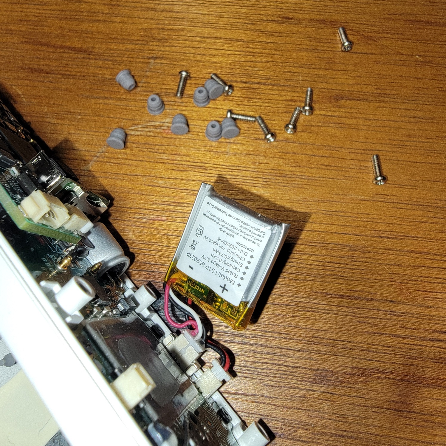

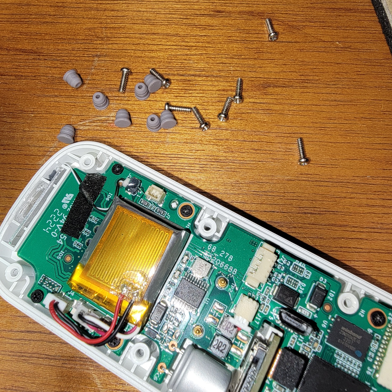

In theory every battery can be replaced. However finding the right battery type and size might be an issue. There is no Direct Replacement for the camera that one can just go and buy from Amcrest. However removing the back of the camera, Taking 8 screws out of the back that is behind the pads, will reveal the Battery that is being used. Doing a search for that battery might be able to find one that someone is selling. Keep in mind that you will want to double check the connections of the battery if you were to buy a replacement from another source. The connection for the battery might be different and when plugged in might end up being reversed from normal.

Thanks. I've taken it apart and removed the battery. I found one that is close enough on Amazon size wise and the same voltage and milliamp hour. Others has used it to replace batteries in Ring doorbells that have gone bad. I'm going to attempt what they have done and move the circuit board from the old battery pack to the new one.

Here are some pictures of the Lorex Version of the AD410. It has been a while since I had a Ad410 apart but if I remember right the 2 have the same battery. At first I thought it was ran with a Large Cap on a Wire. But that was one of my Other Doorbells, The Ad110 has 2 large Caps. However the Ad410 has a battery. Here is connections and battery type with Model Number
