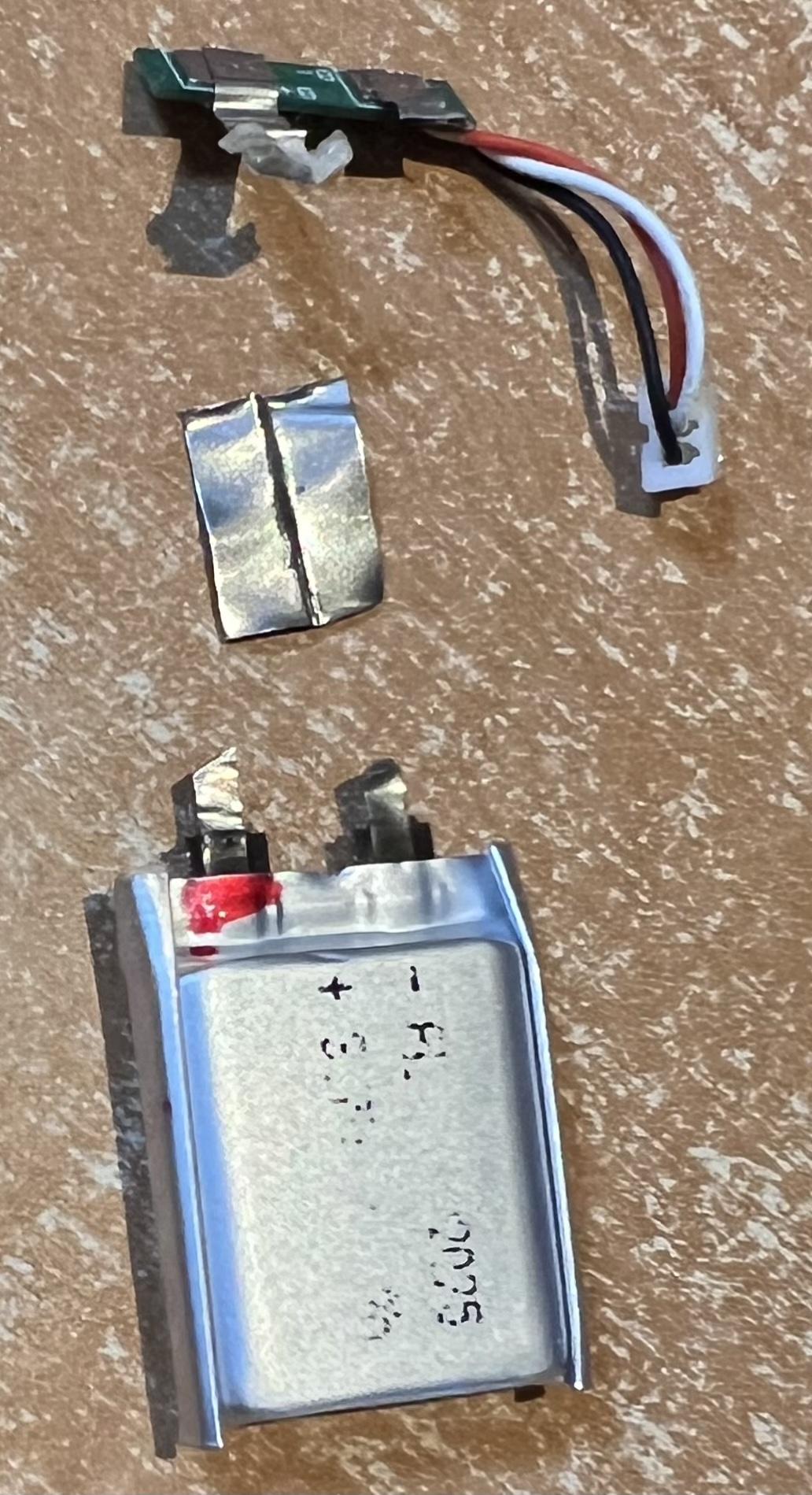

My doorbell had been going offline periodically, and we finally realized that we hadn't heard it in a while.
A little testing confirmed that it was rebooting on the button press, which felt like a battery issue -- I mean, how else could it close the doorbell circuit without going offline?

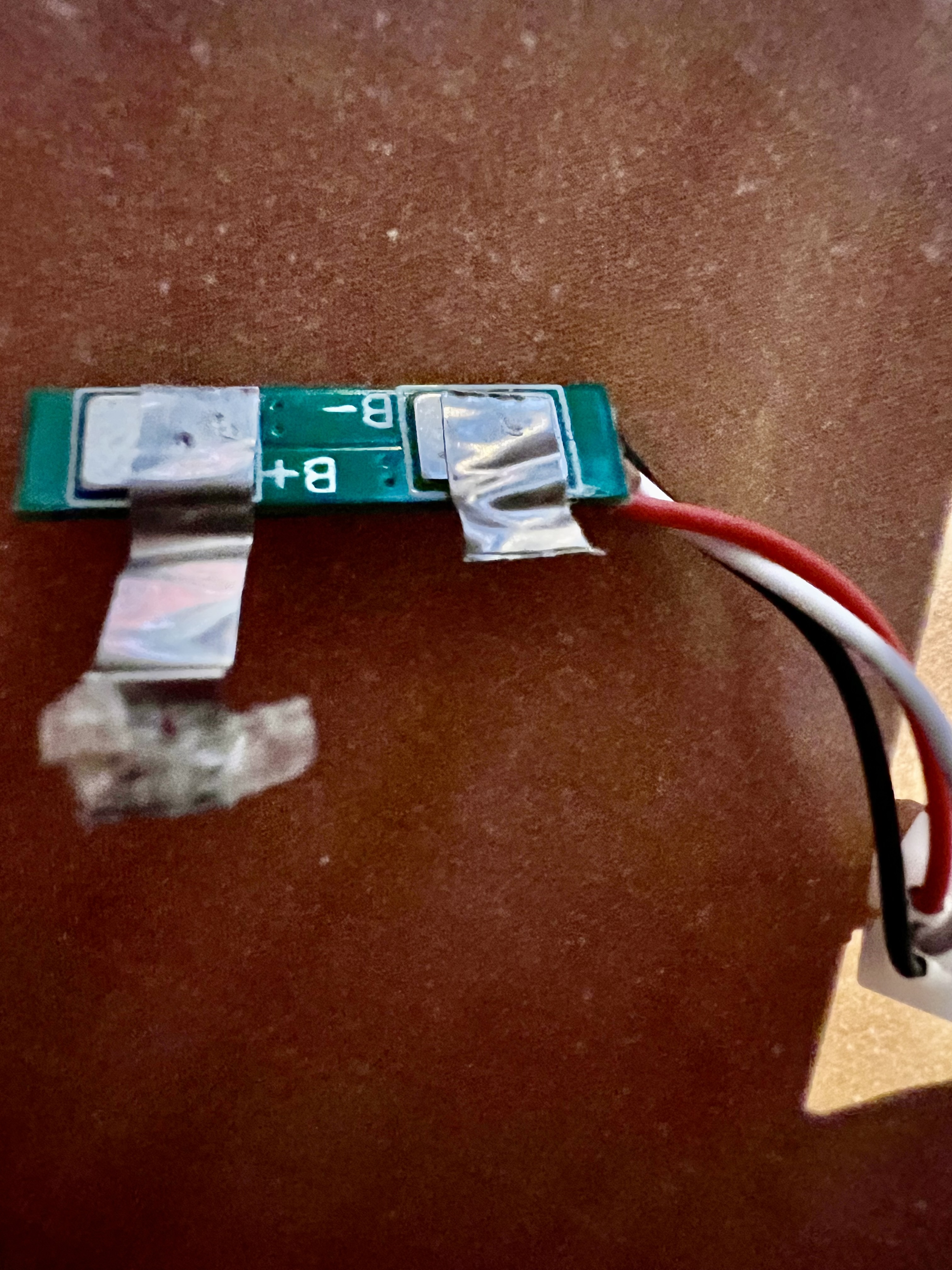

Found this thread, ordered the battery from amazon [602025] for $9, arrived the next day. The old battery was swollen, and it's been pretty cold this winter; doorbell was installed in 2021. Removed the battery manager chip from the old battery (easiest to remove with heat -- the welds are to the solder pads, not to the battery manager itself. If you heat the battery manager attachment pads, the old battery will detach), soldered it to the new one, attached the battery heater, reassembled, charged via usb for ~30 minutes, reinstalled.
After plugging in the doorbell to usb to charge, it powered on and resumed recording.
Everything is back in business: doorbell rings again. Great repair project...and only $9.
Thanks to everyone for their posts and pictures and advice!

Hi All,
First, Superdave4444 thanks for the great photos of your process. I just replaced my AD410 battery to solve the issue of my camera going off-line when the doorbell was pressed. Worked perfectly!
Battery: (https://www.amazon.com/dp/B07C9R84QS?re ... b_ap_share)
Just a note; the battery contacts are tack welded onto the circuit boards (old battery and new battery) so you will need to "peel" them off very carefully with pinch nose pliers. I used a fine file to "smooth off" the pads once I had removed the original battery. After that, soldering the new battery back onto the original board was pretty simple (assuming you have some previous soldering skills
Good luck!

I tried the Amazon and solder swapping the BMS, but I failed and the battery gets hot to the touch when I plug it in. I might have cooked my BMS, not sure. Polarity is matched correctly.
Re: AD410 chime kit replacement
I did a sanity polarity check off the new battery with a volt meter and the printing was incorrectly marked. Another resolder and mine is working again.
