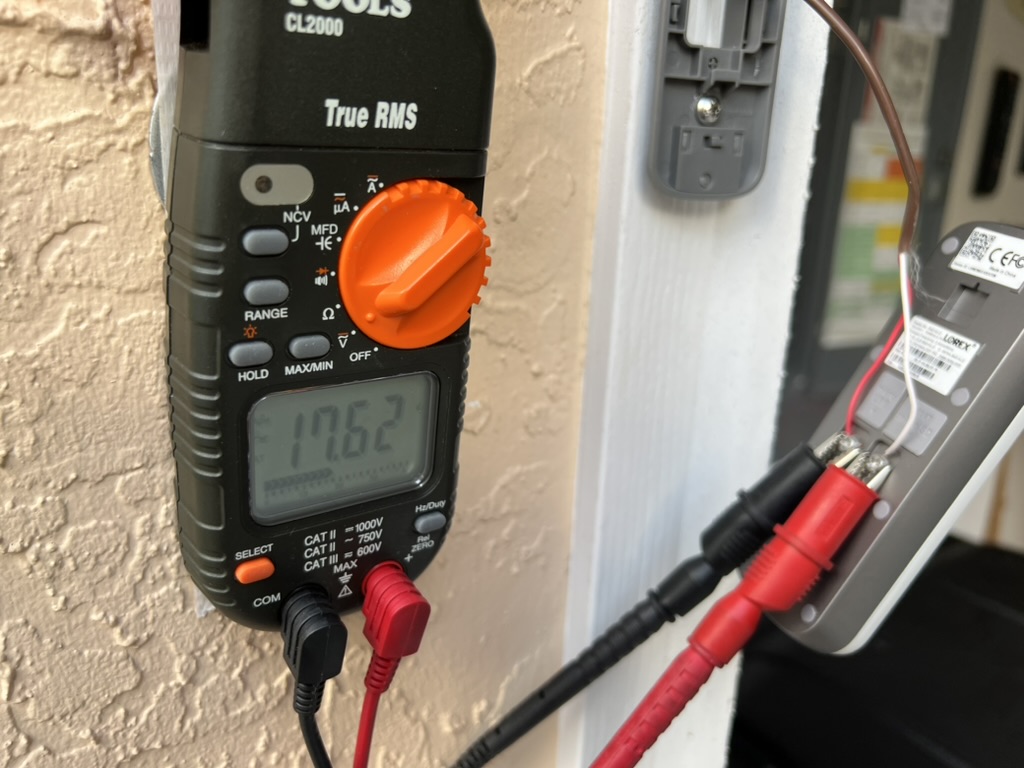

BACKGROUND
I purchased three Lorex B451AJD, which is a rebranded AD410. I have one mechanical chime with a front a rear solenoid, powered off a 16VAC/30VA transformer. Each doorbell only draws 0.25 amps AC and the solenoid another 0.25 to 0.5 amps peek, so I am well below the ratings of the transformer. I installed the chime kit across the terminals of the mechanical chime. When I connected the third doorbell, I connected in series with the rear chime solenoid, parallel with the other rear doorbell. All three doorbells worked without issue, but I noticed a buzzing sound emitting from the rear solenoid, so I also attempted to connect my third doorbell directly to the transformer. It worked until I pressed the button on the doorbell. It will power off the USB power connected, but not the transformer terminals. I reached out to Lorex tech support, who opened a case and determine the doorbell was defective and are sending me a replacement. Thinking the same thing, I mistakenly relocated one of my working doorbells connected to mechanical chime, to the same location. Now I have two video doorbells that do not function. Lorex basically said that they don't recommend connecting three doorbells to the same transformer. I silently disagreed with them, but agreed that I would connect the third doorbell to a separate transformer in order to get the second replacement.
DILEMMA
Without true root cause, my dilemma is do I risk damaging another doorbell? So I disassembled the video doorbell and the chime kit to try and assess what might be going on.
DIAGNOSIS
In order to for the video doorbell to actuate the mechanical chime, it must have a solid state relay briefly shorts across the transformer input. There is a huge capacitor inside the doorbell that will continue to power the doorbell for some number of seconds so that it continues to function. The chime kit has a differential comparator that monitors the AC signal and also has a solid state relay to locally energize the solenoid long enough for it to actuate. That is how the doorbell and the chime kit work together to work with your existing mechanical to electronic chime.
CONCLUSION
My conclusion is that because the video doorbell shorts the AC transformer input, when connected directly to an AC transformer, it results in a dead short, which likely destroys the solid state relay or the AC rectifier in the doorbell.
POSSIBLE SOLUTION
I think the solution is we need to add a 25 ohm, 50 watt resistor in series when powering the doorbell directly off the transformer, which will add an additional ~10 watts (VA) of load to the transformer. Not sure if the chime kit is would also be required. There are a number of other video doorbell manufacturers models that require a 25 ohm, 50 watt resister.

@Revo2Maxx Then how do you explain how the video doorbell (Amcrest AD410 or Lorex B451AJD) exhibit the exact same symptoms. Works on 16-24 VAC transformer until the doorbell button is pressed and will no longer power up off the AC input, only the USB power?

Lorex B451AJD powered directly off transformer, but will not power up after first button press.
