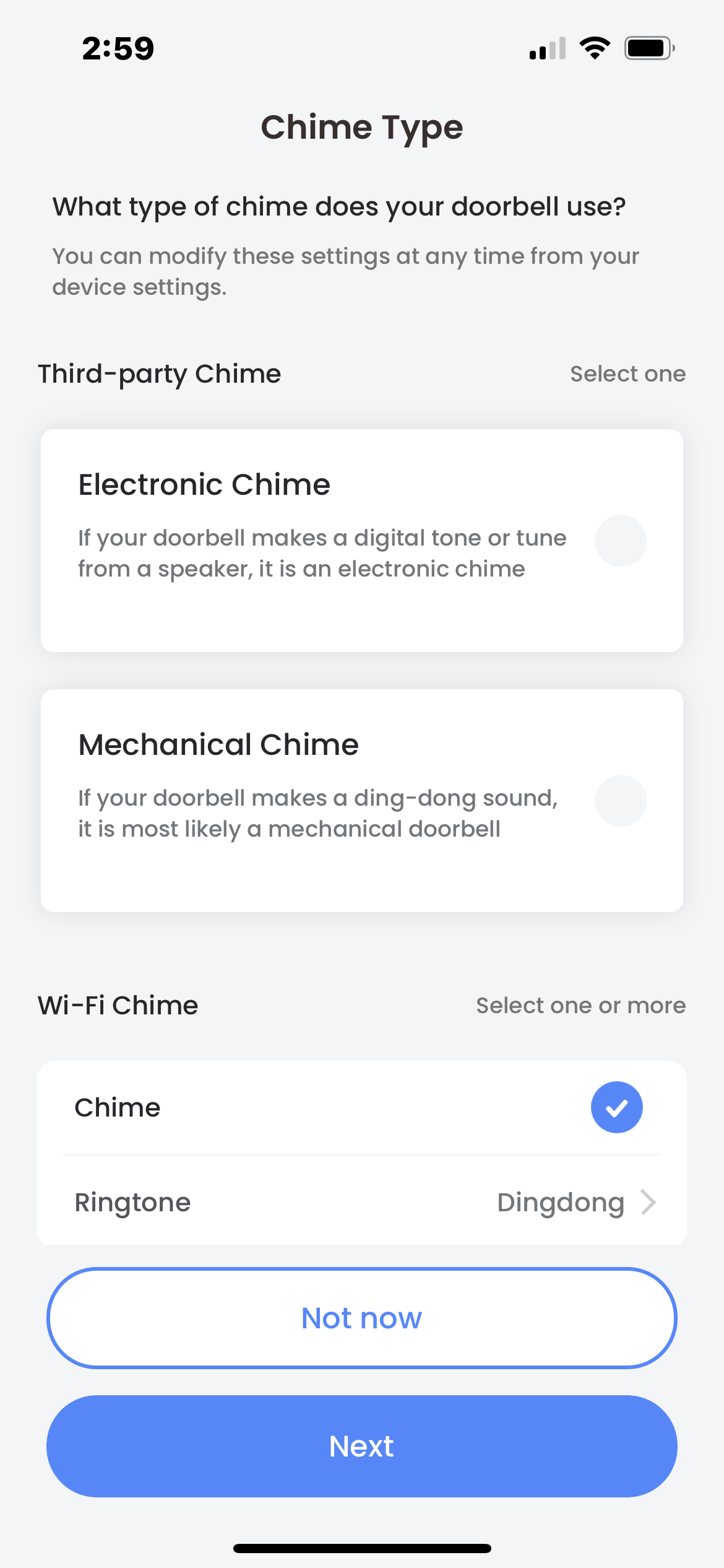

Just to let everyone know, I was able to confirm what @Revo2Maxx suggested in his previous post. The key is during initial set up to not select or skip the mechanical or electronic third party chime option. No resistor and no chime kit required. In the case of the Lorex firmware, once you have selected either option you can only toggle between the two options. There is no option to select none after initial set up.
LACK OF WARNINGS
My biggest issue is there is no warning in any of the documentation and nothing in the Lorex Home app during initial setup. Also seems like a design flaw that a device can be software configured in a way that causes damage.

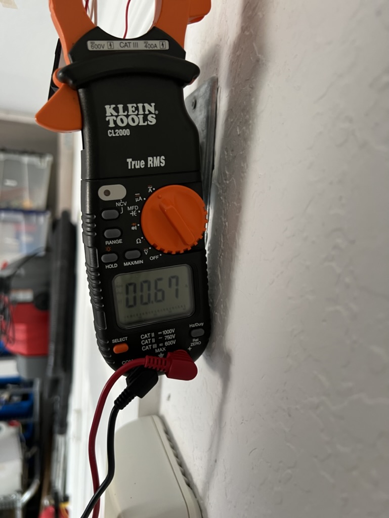

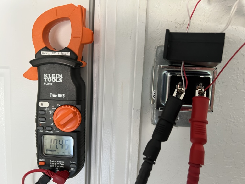

I have 3 Lorex B451AJD (Amcrest AD410), two are wired to a mechanical chime (front and rear), the other is wired directly off the transformer. All three and the mechanical chime are on the same 16VAC/30VA transformer.

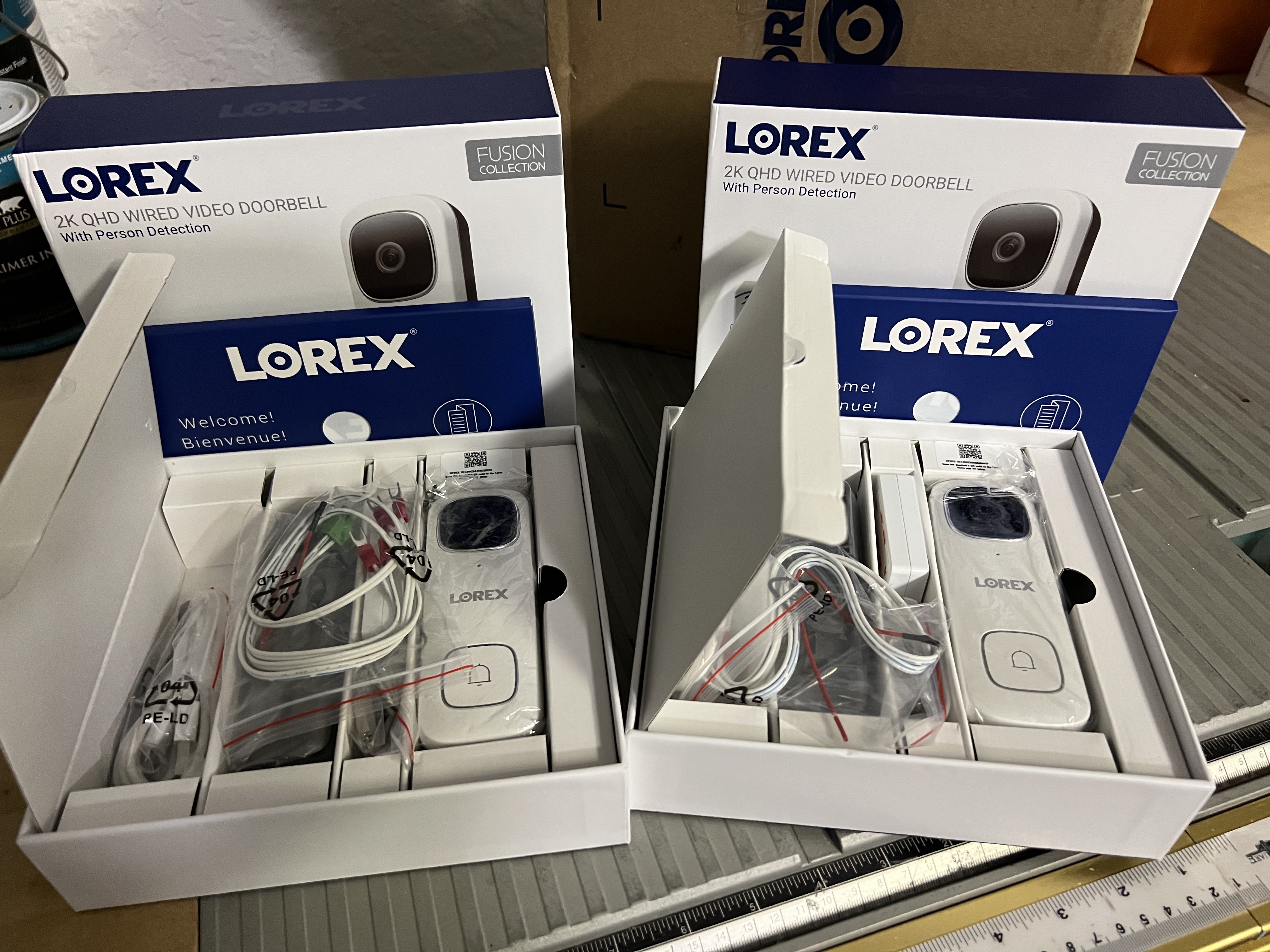

Since Lorex sent me two replacements under warranty and have not asked for the original units back, I basically have two AD410 (Lorex B451AJD equiv.) that are fully functional when powered via USB. I tried to PM, but I don't have permission. Let me know if interested.

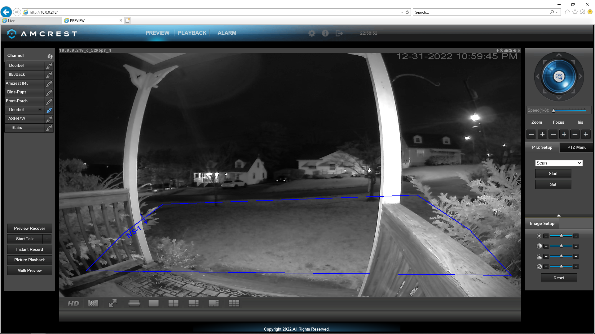

For anyone that might have a Lorex and have tried to get the Splash Text off. Not sure if there was other way already reported however I was able to from my NVR..
Keep in mind any settings you change in the camera VIA a 3rd party app or hardware is very Risky.
Just going to my 4108E-HS NVR on older FW and going to the Channel of the Doorbell camera, then changing to the Overlay area of the screen takes it out. I didn't even make a change in the settings I just went to the page. Oddly it does the same to the Amcrest AD410 as well lol..
