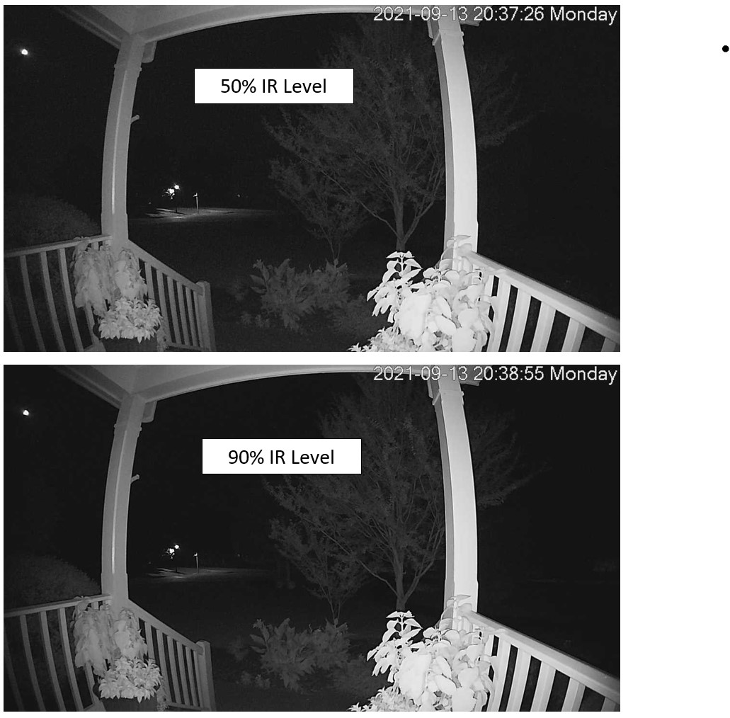

So I started getting disconnects again. I changed my Hubitat rule (see my post on July 26, 2021) to Light=50 about five days ago and I have been checking the Blue-Iris logs - no more disconnects. So I guess 90% brightness is too much. I can tell a difference between 50% and 90%, especially if I am monitoring the camera when the illumination is reduced. The video is more grainy, which is to be expected because there is less light for the camera sensor to use. But it is still good enough for me. Here are the two images - it is hard to tell a difference if you don't look very closely.
Of course the disconnects happened with the new higher current transformer, so that is NOT the cause of the disconnects. At least for me anyway.

Re: AD110 Doorbell Persistent Night Vision Off
Well if you tried a new Transformer and had the same issue I would check your Wiring. There is only a few reasons that Electronics fail. #1 Heat and with IR on it would cause some extra heat however if your nights are not normally hot already then the heat one could see would be the normal daily heat and with that should have issues day or night.
#2Power issues Caused by Transformer and or Wiring
Now I don't remember the Thread but I would also not rule out Blue Iris.. I wonder what would happen if you ran your camera at night 90% and only writing to the cameras Micro SD and not having it connected to BI if there would still be an issue.. as I said I don't remember the thread but I think someone tried that and there was no issues once removed from BI.. just a thought..
Personally Between your 2 pictures I don't really see an increase with 90 or 50 anyway.. It all looks the same to me..
Ok Blowing the picture up full size I can see some in the back ground in 90% that I can't see in the 50 but then again I don't know if that was caused by on coming car or just increase.. in truth your Scene has to much Reflection and with that causes some Reduction in Picture Quality with the Camera Iris and what not trying to change the scene for a good picture flow
