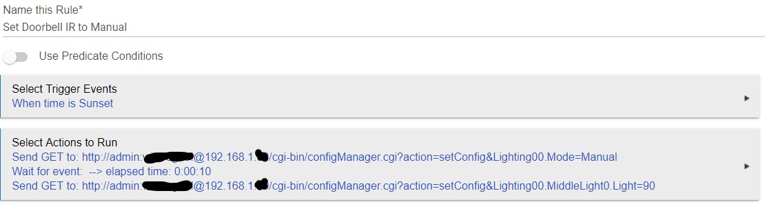

Re: AD110 Doorbell Persistent Night Vision Off
I created a rule in Hubitat that does the same thing @pcabral is doing. My rule runs every day at sunset. I tried to think of a better trigger mechanism, but it is no big deal if it runs seven times a week. I guess if there is a reboot after sunset and the values revert to factory settings, it will have to wait until the next sunset to correct. I will see if this is an issue or not.
BTW - I also have an insufficient transformer (10VA) so my issue may be related to that, instead of this. But I thought I would share what I did in Hubitat in case it is helpful for others. See inserted image below.
I tested this and checked using "http://admin:<password>@192.168.1.xx/cg ... e=Lighting" and the values do change when I run the rule. It is really easy to update it if I want to change the Light value, for example.
I put the 10 second wait in there just because I want to be sure the first one is committed before I send the second one.
