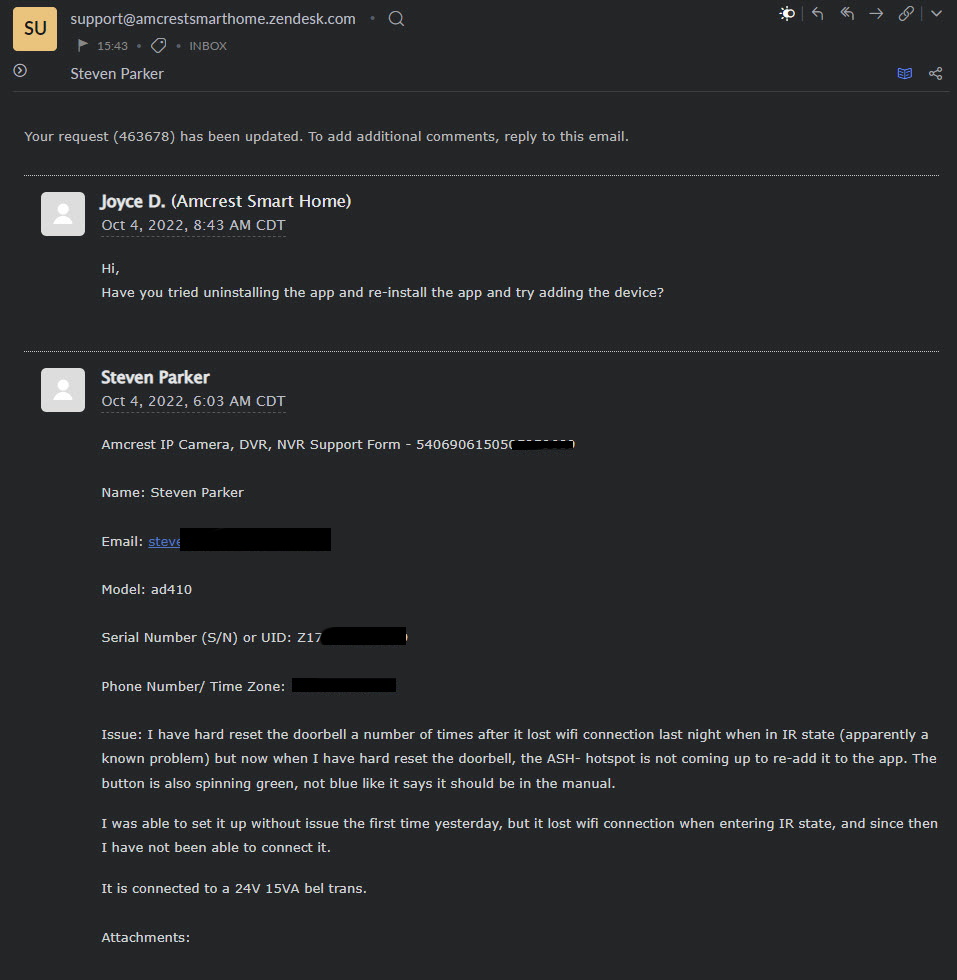

Well I removed the extra bell cable (so it is shorter) and now when it powers up the button is blue (it was green) I have tried to hard reset it but I am not seeing the ASH-########### hotspot appear for me to connect to and the button has a green spinning circle (not blue).
Man I wish I knew this bell had so many issues with it before purchasing, because I can't easily RMA it from abroad. For example, nowhere in the instructions does it say what it means if the lighting is green instead of blue.
I tried this method, but the hotspot isn't seen by that app either https://amcrest.com/forum/amcrest-smart ... tml#p40007
Really disappointed. I have also raised a ticket with AMCREST, but right now I am stuck.

Well customer support leaves a lot to be desired "try turning it off and on again" really??

@Revo2Maxx Thanks for reply, yeah I have tried that power cycling off for more than two minutes and I have hard reset it 20 times or more, because I read somewhere else that the Hotspot could start working again on its own if you hard reset a bunch of times. I actually moved from the doorbell wires to my PC and plugged it in via USB so I could reset it and power cycle it easier, nothing is helping though.
I called the international tech support and the Indian guy that answered told me that a spinning green light means it is trying to connect to network. For me it never spins blue. it is
Power on: solid blue for over a minute
"WiFi Hotspot is available" is said and it starts spinning green anticlockwise.
I contacted Amazon and they said that I should return it for a refund.
