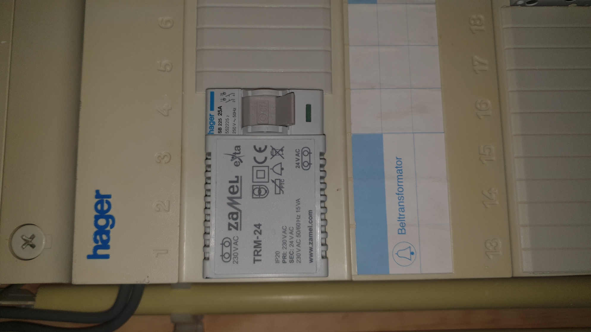

I purchased this doorbell too because my other doorbell (Hikvision DS-KB6003-WIP) got water damaged thanks to a 3rd party backplate wedge. I the AD410 imported from the United States to The Netherlands, so it wasn't cheap. I got it all set up today and now I am reading about how the night vision causes wifi disconnects, possibly also because the rated power isn't enough?
Mine is 24V 15VAC with mechanical chime. I installed the Chime adapter and everything was working until a few hours after nightfall.
Flashing green button, two red IR leds lit up and no connection to my WiFi (which is less than 4ft away).
Because it is night here I have turned off the bell trans. I will look again in the morning when IR isn't being invoked when I turn it on. Am I correct in reading that I will have to disable night view in order to avoid disconnects? Why hasn't there been a firmware update if this has been known for more than a year?

@Sparker Hello and Welcome to the forum.
I would double check the FW you have installed and double check the install of the doorbell camera and Chime kit from Amcrest. Looking at the data from the devices it should work without an issue with what you have for power supply now. The AD410 seems to take less then the first roll out of the Ad110..
Personally I don't use 24vac on my doorbell cameras anymore seeing the issues I had with the Ad110, I also have the Doorbell from Hikvision that you had before. The AD110 and 410 both are a better camera IMHO..
I have a 10VA somewhere around and I will try to find it and connect it to my Ad410, I have it right now setup as a Stand Alone on a 12vdc power supply and have been using it that way for over a year now.
Some things to keep in mind, While I know you said your Hik doorbell was working until it got wet, I would double check the type of wiring your using and make sure that the length isn't to long. While I know you said it is a short shot to Wifi there has to be some type of issue with voltage, I would if you have a Multi Meter, I would take the camera off the mount, and test the voltage at the doorbell I would also check that with the IR on. if the Voltage at the doorbell is out of range it could be to little wire gauge being used or to long of a run.
