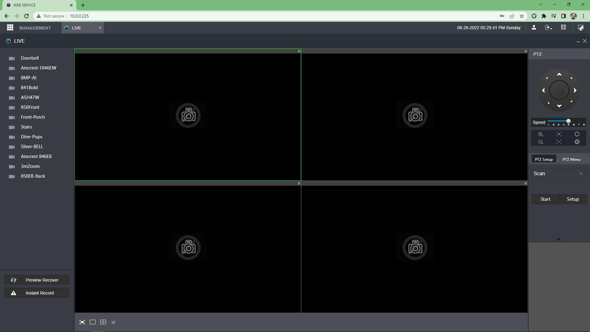

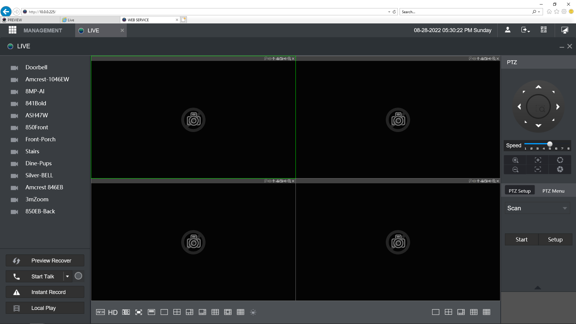

About the 4ch LIve view in WebUI. I am going to guess that your talking about while your using Chrome or Edge. It is kind of Sad that IE is going away and that the best view is while using IE..
When I log in one of my systems that I know for sure works with more then 4ch view in Chrome or Edge I only get a 4ch View. What are the options? As I was saying above ASP and setting up with P2P for your devices you won't have to port forward or do any extra setup in your computers to make things work. Next option is to use IE, OR IE tab in Edge or Chrome. Looking at the 2 pictures below you can see what one of my NVR's look like in Chrome and IE where IE is much better option with many more features offered.. Yes still will need to DL and install something so it works but it still works. Worse case IE Tab in Edge is going to be supported until 2029 the last time I looked.
1 last thing if you have the Preview Recover in your setup then you can click that to recover your last viewing setup... You can see that option in both IE and Chrome..
Screenshot (2770).png (72.32 KiB) Viewed 18803 times
