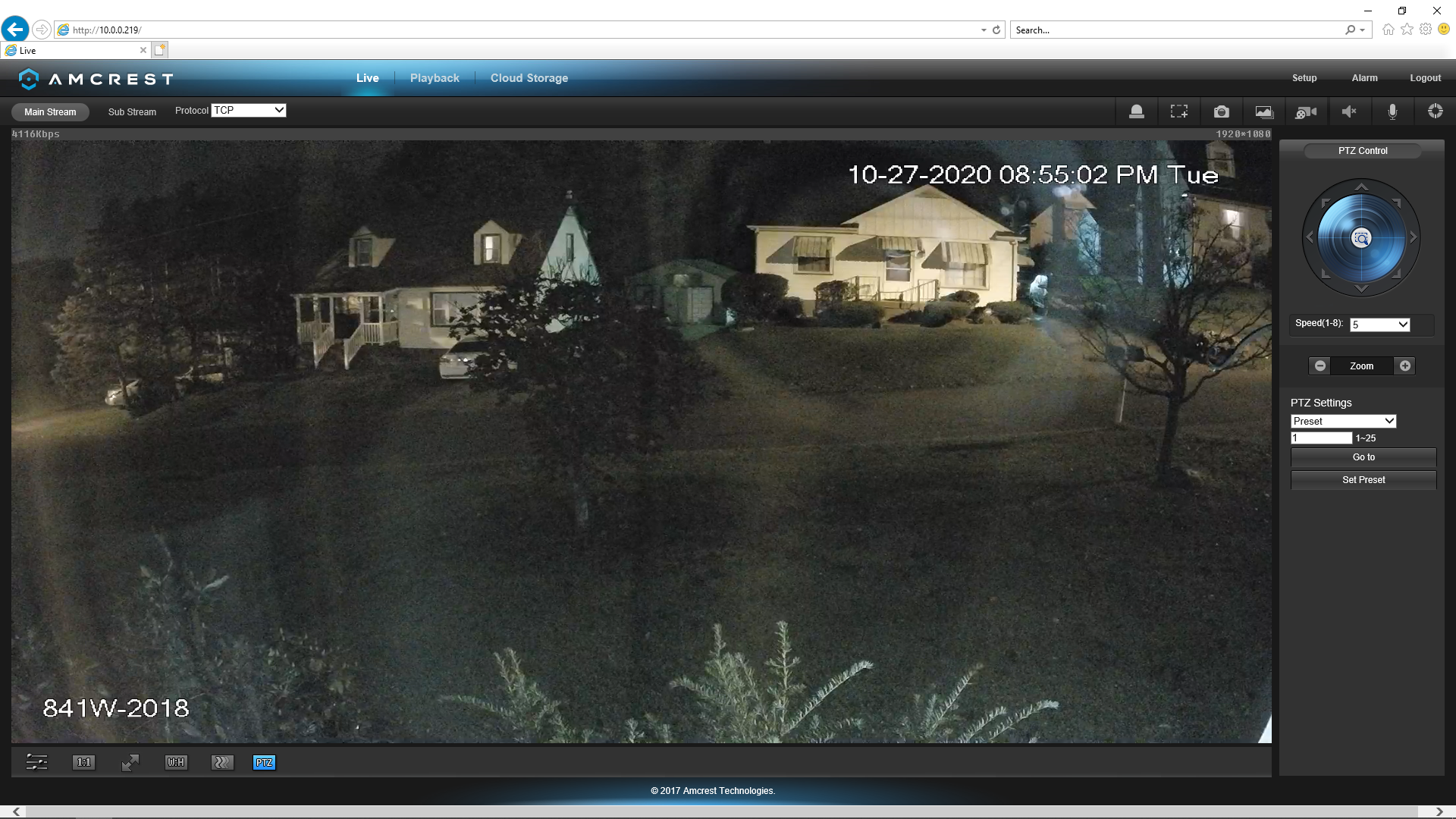

Re: Now that IE is gone, how do I log into my IP Cam?
That is an IE Camera.. You will need to have Amcrest Chrome APP for that FW camera.. YOu can also use IE plugin for Chrome or IE whatever it is called for Chrome.. But I still can use IE to log into my 2.520 version cameras
Screenshot (128).png (2.02 MiB) Viewed 8449 times
