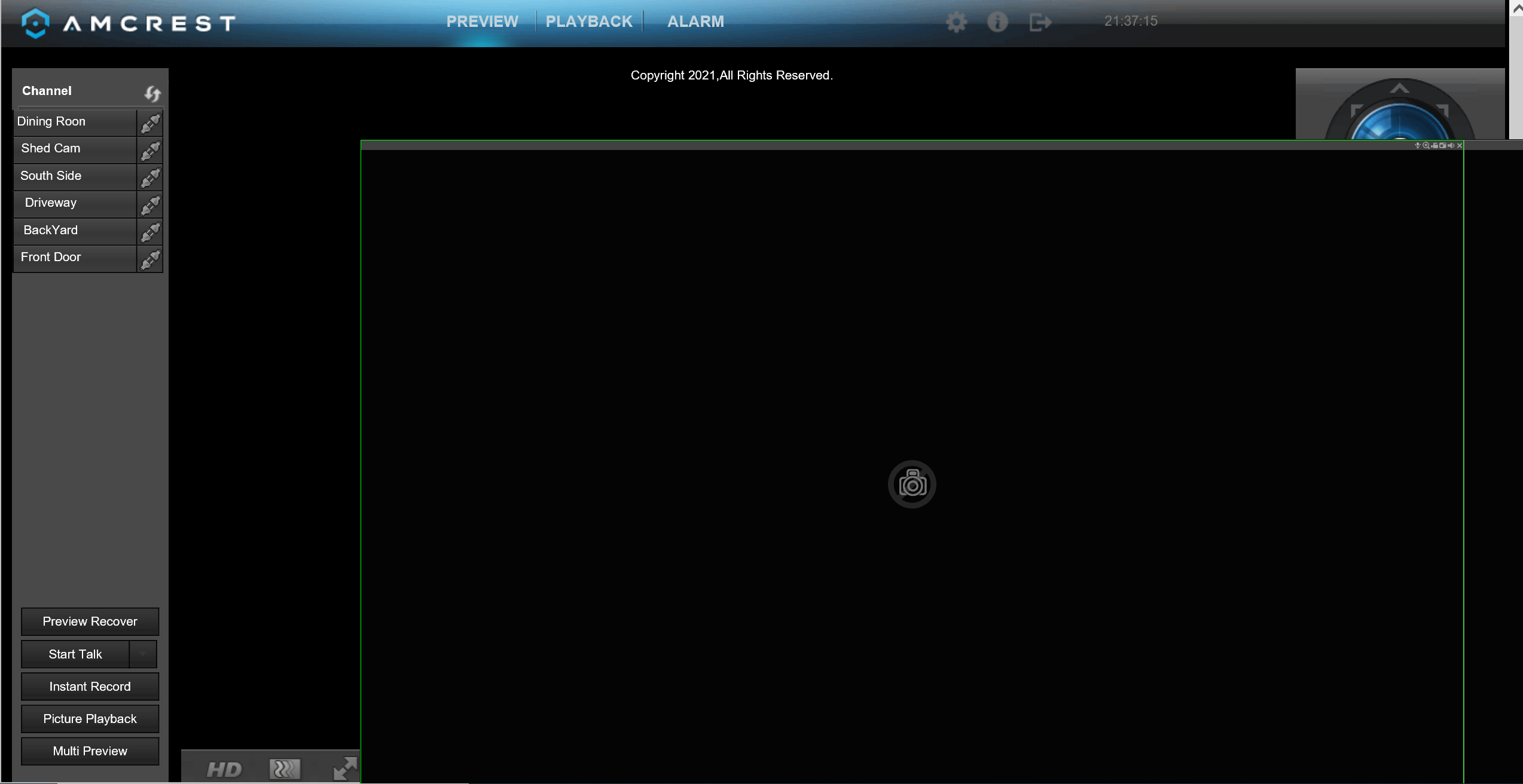

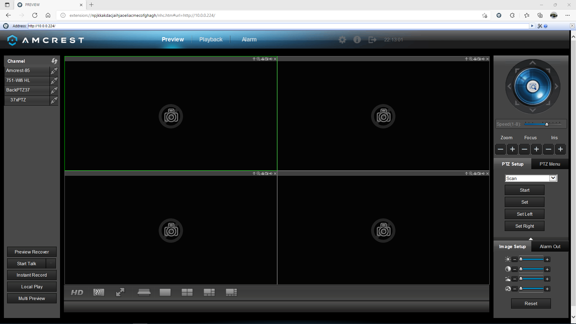

Sadly I just checked my 4216E NVR and while it will work in the IE and it will load a new window not a tab as it normally does in IE.. When I go to log in the camera after using IE mode the camera will come online just can't see anything because it is all out of frames as it normally is so far it looks like that option isn't going to work for Chrome in IE mode and loading a camera off the back side through the NVR isn't going to work...

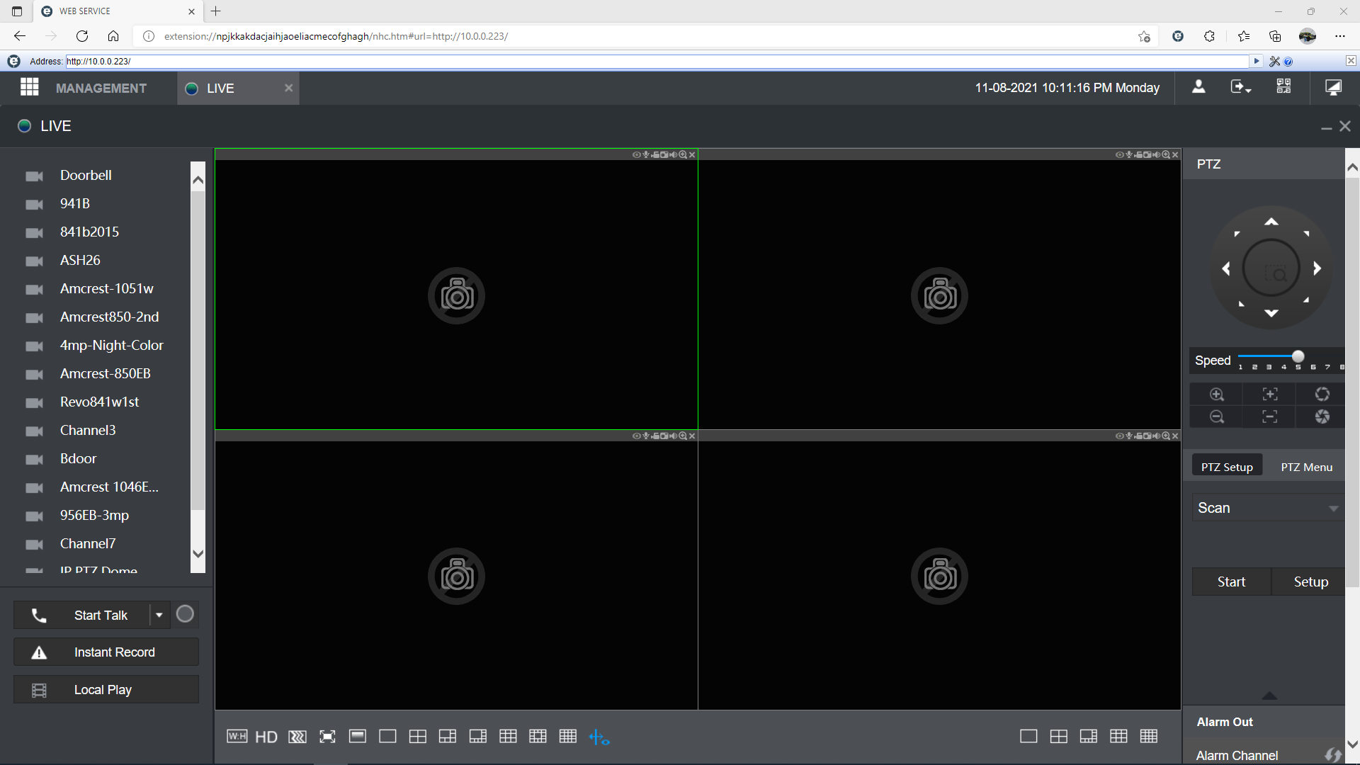

Just got the IE Tab it is 100% just like the Chrome one lol... Also sadly Edge does the same thing that Chrome does when I try to load a camera from the NVR's back side..

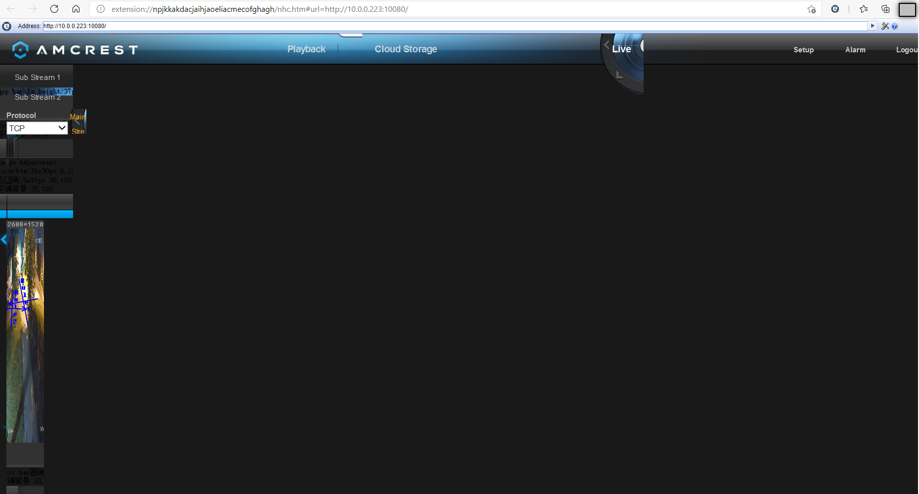

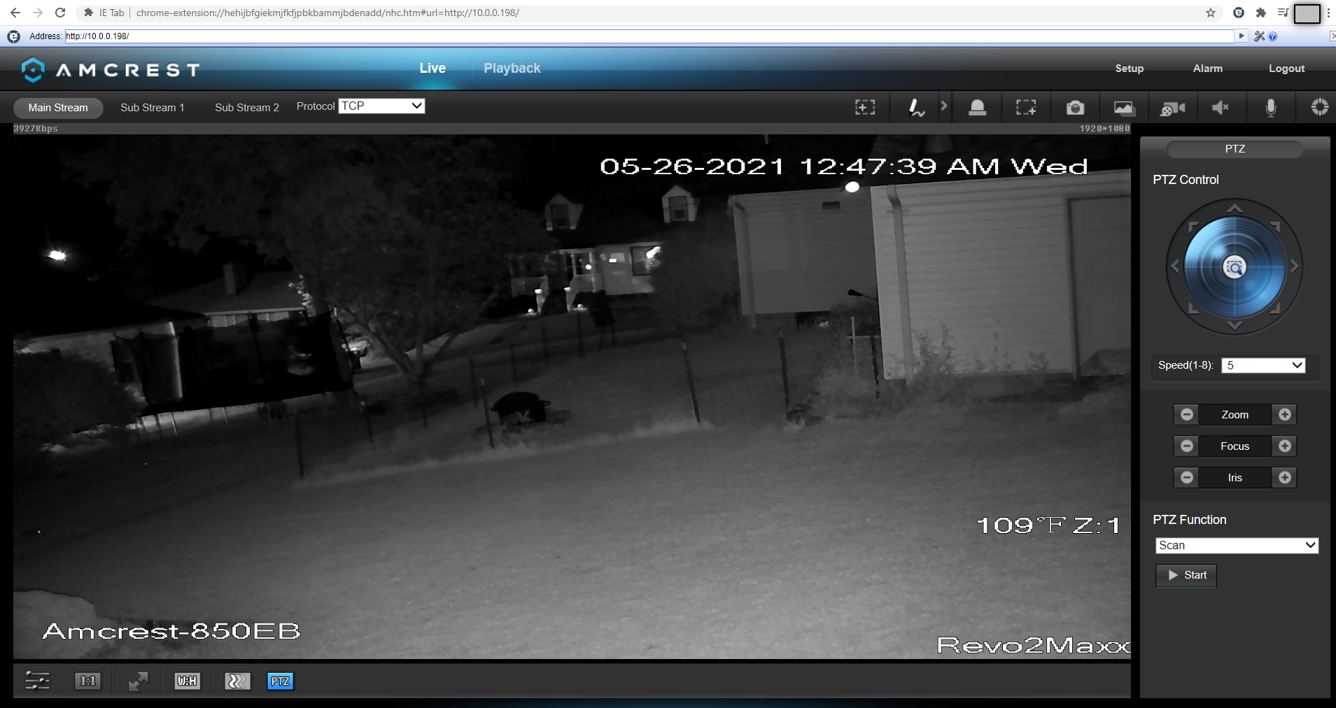

Sad this is what IE Tab does to both as I said above I only took the image from Edge and the first picture in my first reply is from Chrome connection to cameras WebUI over the camera on my normally network image below is from trying to access the camera that is connected to my NVR's POE port.. Works perfect still in NORMAL IE..

I have not tried a NVR, but in your second screenshot of Edge, I don't understand why you are apparently using an Edge extension (IE Tab)? What happens if you just put http://10.0.0.223:10080 directly in Edge and do the steps I mentioned to use Internet Explorer mode?
Re: New Edge browser IE mode
So in Chrome and in Edge that is what happens in both using the IE Extension aka Tab.. Yes if I put the camera IP address with port number in Edge it will work with that camera because it is able to work in Chrome and Edge however doing so will remove the things I like to use in the IE and was only for checking what would happen if I tried to load from my NVR.. I can use it on one as soon as a new window opens by the Direction of my NVR that is what happens.. It is only an issue for cameras that I can't use Chrome or Edge..
So I just thought I would try something else. Sadly it didn't work as expected either. Taking the IP with Port number as it showed there after loading from the NVR it started a different camera not the one I wanted and makes no since to me.. I will keep trying to find something that works.. What is odd and why it don't make since to me is when I click the camera it will load that camera however when I put in the port manually it just times out...
What is odd as well is camera that I tried to load was Ch6, However when I load after first logging into the NVR and want to see Ch7 AKA port7 it will have that same Port number if I look at a different one then it will be 10081 and so on.. Trying to load off that number alone results in a failed load
Edit: Ok just did it again and this time.. I logged into the NVR, I clicked the button, I then took that into a new tab, clicked the IE button again, then pasted the info in the IE Tab bar and this time it did work as expected so the good news is it does work just not as easy as it does within IE itself... I tried again a few other ways with either Time out issue or messed up screen as results.. After Click, copy link, past in new tab after pressing the IE tab button and that did work.. just a lot to do to make things work as you want it to

I have been using IE flawlessly on my laptop. Recently I am getting this screen coming up when I log in. I can't figure out how to get this screen back to normal, and Chrome sucks for Amcrest NVR, and Edge.... let's not go there. IE is working fine on the desktop just the laptop is hosed, and used to work just fine.
Can anyone please help? We had an attempted break in recently and I really want to be able to view this on my laptop

@jcrider74 Hello and Welcome to the forum
It is hard to say. I have a few Laptops and only ones I have an issue with is the ones with really small screens. I would double check that your Video Software is up to date.
Also I would look to see if your Screen ratio is set right.
What NVR and what Browser are you using?
Maybe for your Laptop DL ASP to view your systems..
THANK YOU!!!! I didn't even think about checking those settings, It was the screen resolution. Once it changed, works great!'
