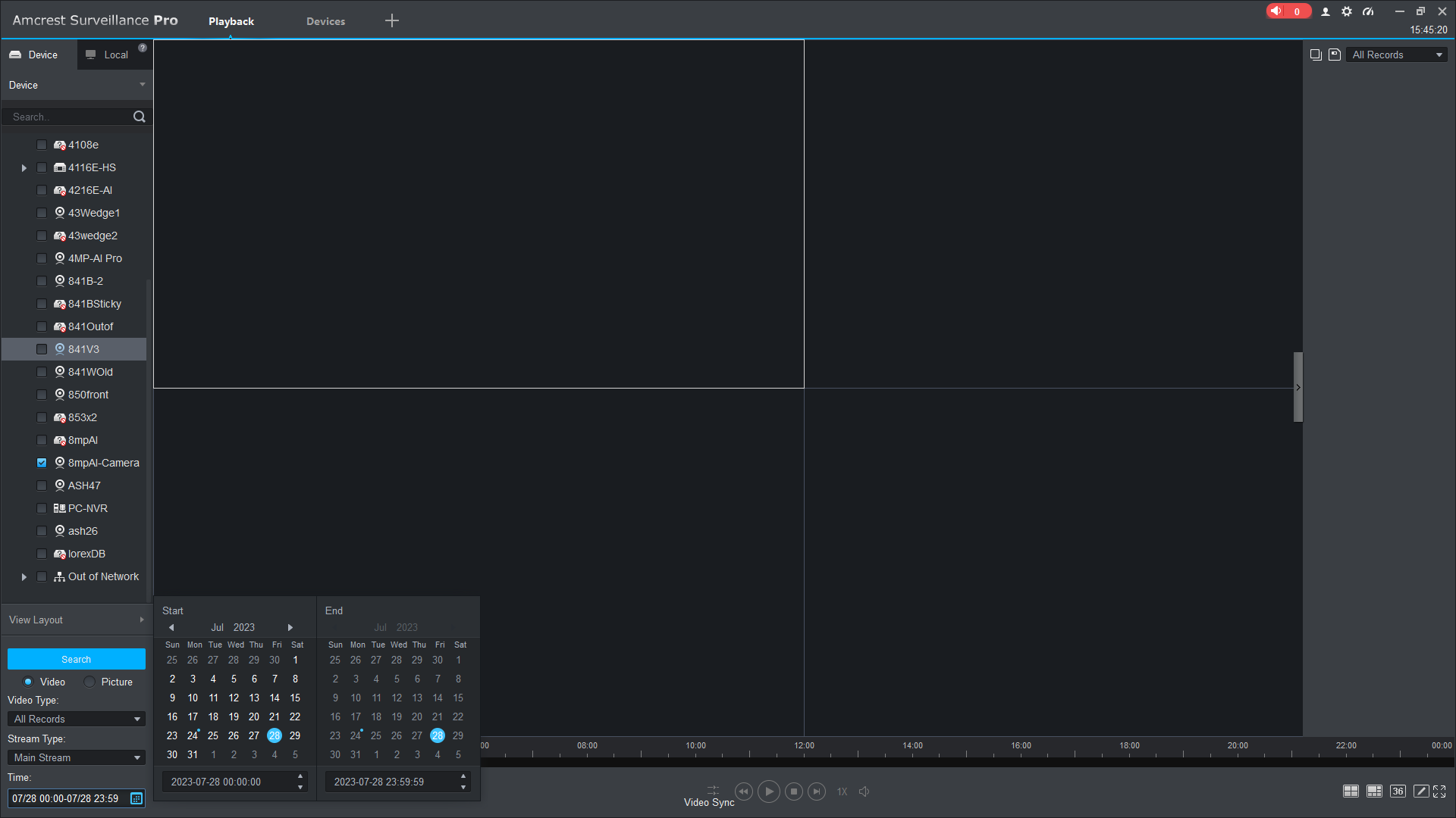

When I click on my ASP, go to Playback, I click on my camera I want to playback from I then choose the day I want to playback from in my case the camera is an AI camera and only 1 Event on the 24th since it was last Formatted and so when i click on the day tab to find the day it has a Blue Dot next to the days with footage. I click that day I do a Search and it pops up in the Right side the event. I then click on it and it loads and plays back...
Also setup to look at playback for my 841V3 camera that has more days and loads of events because it is motion enabled and my AI camera isn't..
Screenshot (4696).png (94.33 KiB) Viewed 15809 times
Screenshot (4695).png (94.64 KiB) Viewed 15809 times
