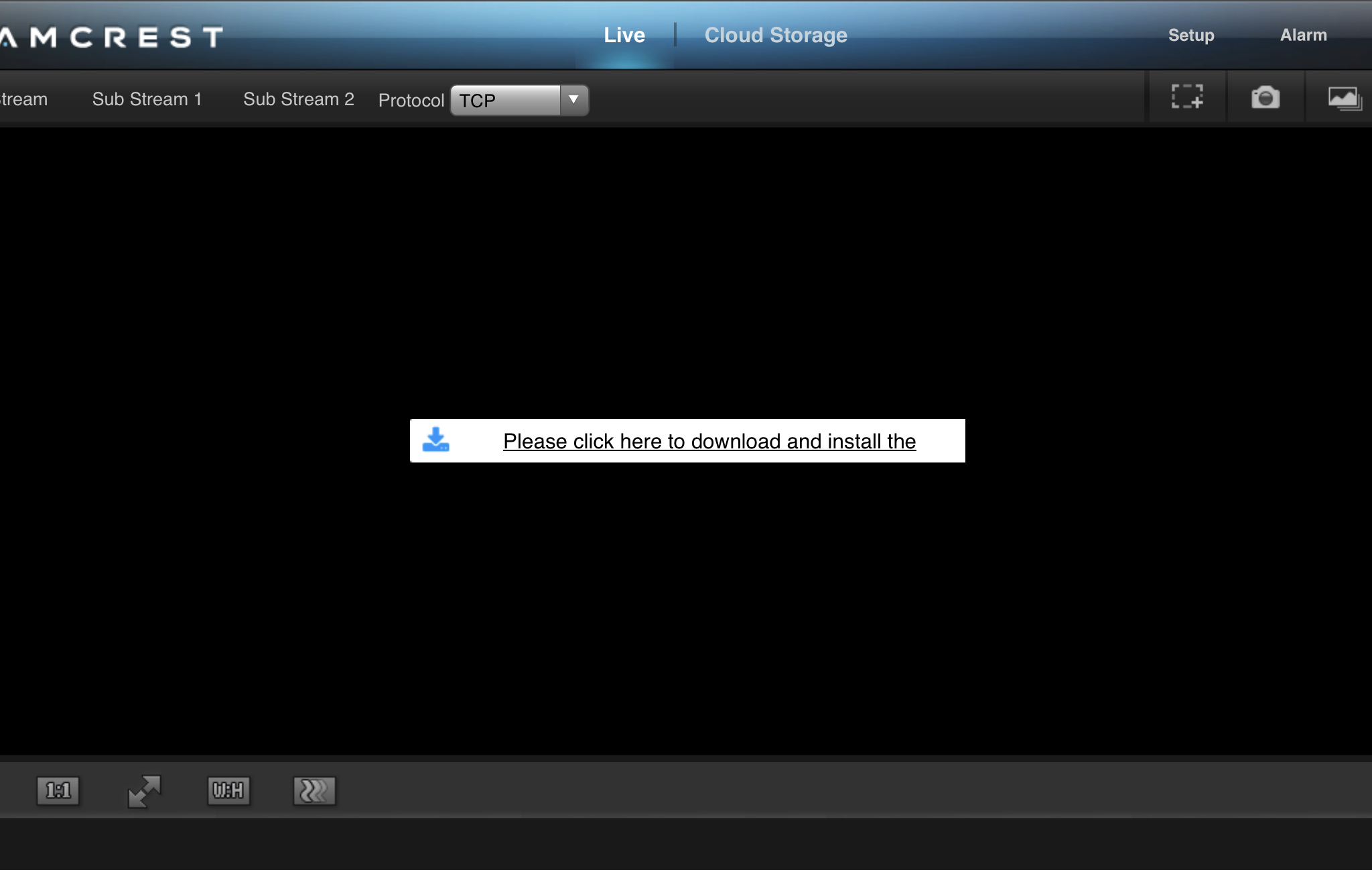

Could you tell me since when the firmwares do not require a plugin for web UI? Were they released after January?
- 294D56EC-245F-4F85-AC07-445837726172.jpeg (295.09 KiB) Viewed 11208 times
Re: Is IP5M-T1179E the only camera model does not require plugin?
The latest firmware for the IP8M-T2499E is V2.622.00AC000.0.R dated 3/20/20 and I'm sure that will be a javascript version (the same applies to the old thread which you mention).
I don't know off the top of my head when the change over.
Just bye the bye, you can still use IE or any other browser for the old firmware to change those settings that don't require a view of the video stream. Just dismiss the "plugin" message and the web UI still works as long as you don't need to see the video, not that that's much use IMO.

The JS and Chrome use started in 8 of 2019.. From what I was told then on no longer need a Plugin

My order of IP8M-T2499EW-28MM has arrived. I am happy to report that the WebUI works on Google Chrome running on a Mac with Amcrest Web View extension installed. While not the the best way html5 solution out there, at least it works on a web browser of 2020 albeit losing some functionalities.
