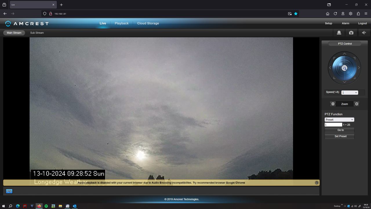

I see a similar message if I use Firefox to access one of my cameras -
The error message is very clear and if I use Edge or Chrome then there's no problem.

So yeah as Longedge was showing it is just the browser type. I was able to get one of mine to also get into this mode using Firefox on my Linux machine. The camera is fine and is recording on a NVR with audio without issue. So only issue is the browser you are using isn't in line with the Amcrest software.
