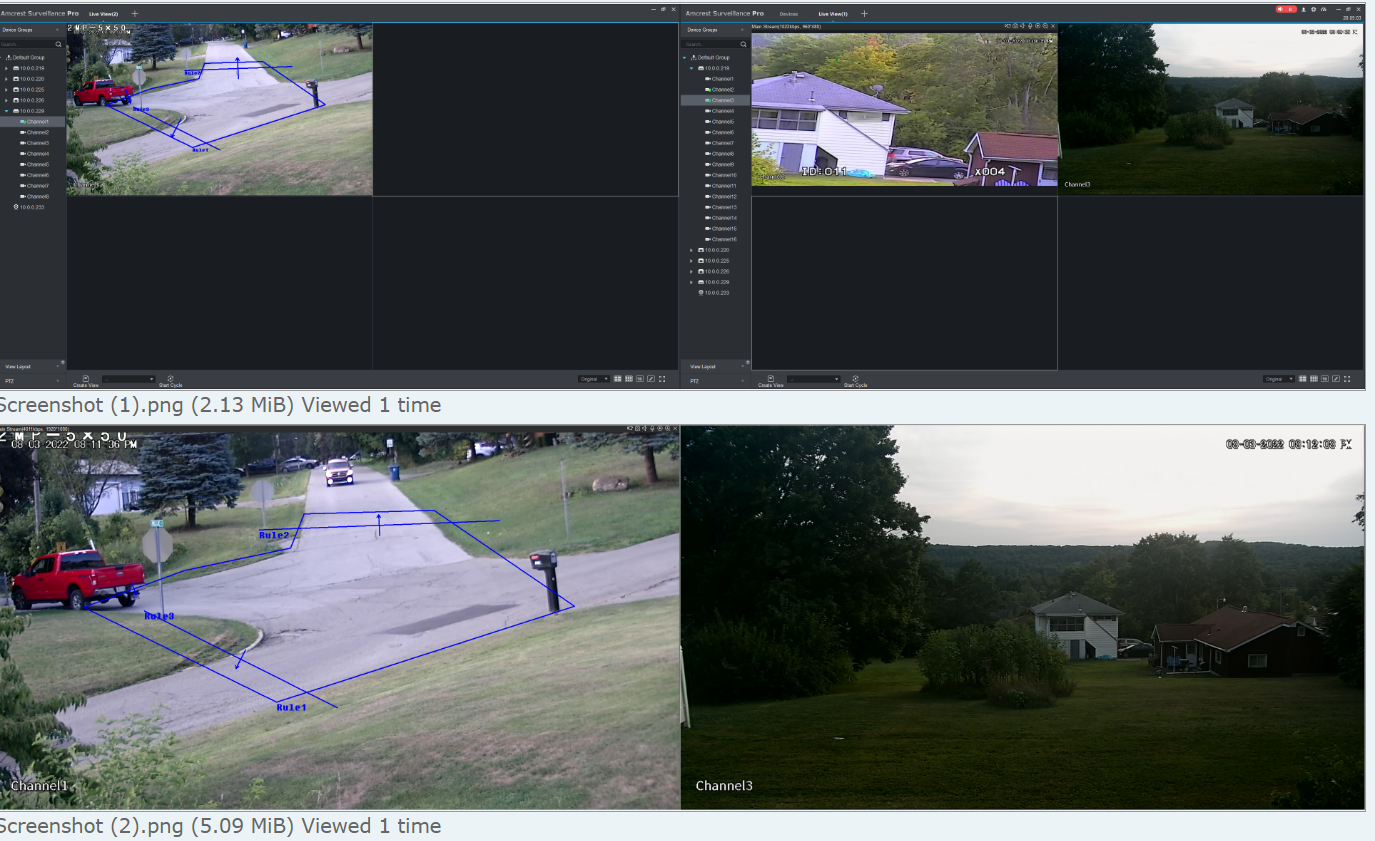

So ok Thanks now I see what is being talked about.. As jack said ASP would be best bet for a few cameras. Sorry thought it was related to a Recorder using Zero Channel grid. I don't use my Multi Monitor Computer for accessing my cameras and only used it in testing back some time ago with ASP.. However after logging into my system, using a older 850EB, and moved the window to the sub screen. Once clicked on for full screen it moved to the main screen full and left a empty window for control of the camera if it was like my 850 I was still able to control the PTZ on the second screen while using the Full Screen for large View.. So with that said I am going to guess the full screen to main is to leave controls behind for access..
Looking through the settings for multi screen I didn't find anyway to change that behavior here is using ASP with 2 of my Recorders and same could go with cameras as well one Full screen one normal screen
Edit, My images were online and was to large, I didn't feel right leaving them so I made a screen shot of them both and this image is only 1.2mb rather then over 7.. Other then that detail these are complete images from ASP using 2 monitors..
