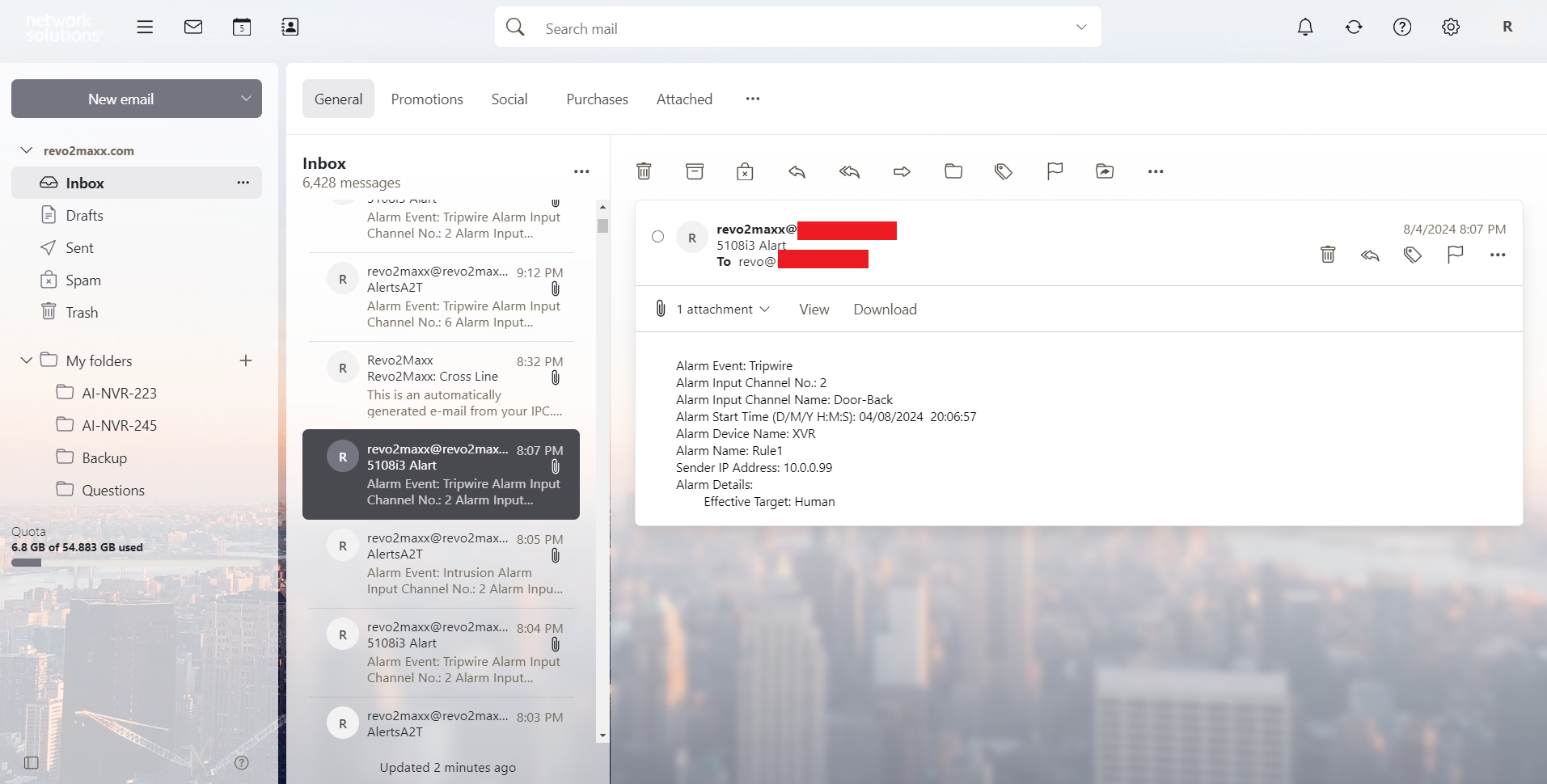

Last I heard yahoo does work if you setup it up to work with your device.. This is required to make a special password code for your device and it has been a while since I have used it so I can't say anymore why but I think it was that you had to do it every different device or the password was so complex that I couldn't remember it for the other devices lol. So I just have my own email server and ok I have 2 because the first I one I started with changed to some complex long SMTP server setting that wouldn't work in all my devices so I started to use an older one that does, So now I use one only for sending *Don't even look at the incoming email on that only use for outgoing* and use my strange one as the incoming lol..
Use them on 4 different Hikvision OEM recorders and 11 of their cameras, setup on Alibi, Dahua, Amcrest and a few other platforms and all work as expected. I will admit that one of the services in Nov 2023 changed how things needed to be setup and then my other server platform changed in Feb or march to use newer TLS format and gave until July to update so having your own service is great because normally the providers will give enough time to change over without having an outage.. I mean the last Nov was an alert for Feb or might have been by April I can't remember now lol.. But was a good lead time and so I do like that.
To be honest as I have said before there is nothing faster then Push that is able to be setup from all Amcrest devices in the app. Time that I get an alert in the App is about 10x faster then trying to get an Email. Plus using the Alert list I can look over what is what. I mean sure I can in my email as well. Just not as fast as Push. Plue keep in mind that Push is almost instant and with Email there is a Cool off time between each auto email checks. I mean sure you can press the refresh to get a newer alert in email but before I could do that I have it on my phone in a push alert..
Also need to make sure your devices are in A Vlan or a connection on your local lan that has access to the internet for push or email to even work..
