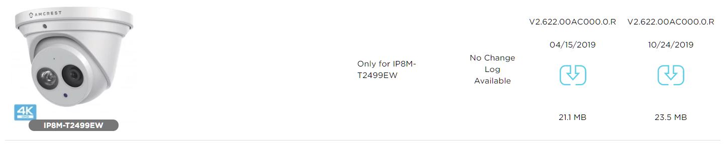

You may be lucky. It appears there is prior firmware available to go back to where you were before you upgraded. Go to https://amcrest.com/firmwaredownloads

Yes that was the original FW. For some reason the version number is the same. It just has a different build date. But with the original FW I need to install a plugin or something in Chrome. With the updated FW it just worked out of the box. So why does the new FW take away all those features?
