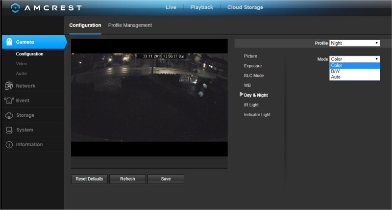

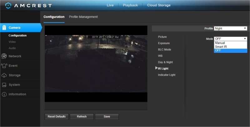

As you can see in my sig, I'm running my IP3M-941B's on the 'new' firmware and certainly don't have that problem as you can see from the screenshots. One thing I have found out recently is that if things have gone wrong then there's a good chance that a factory reset will sort it out (not just a reboot but a full reset).
