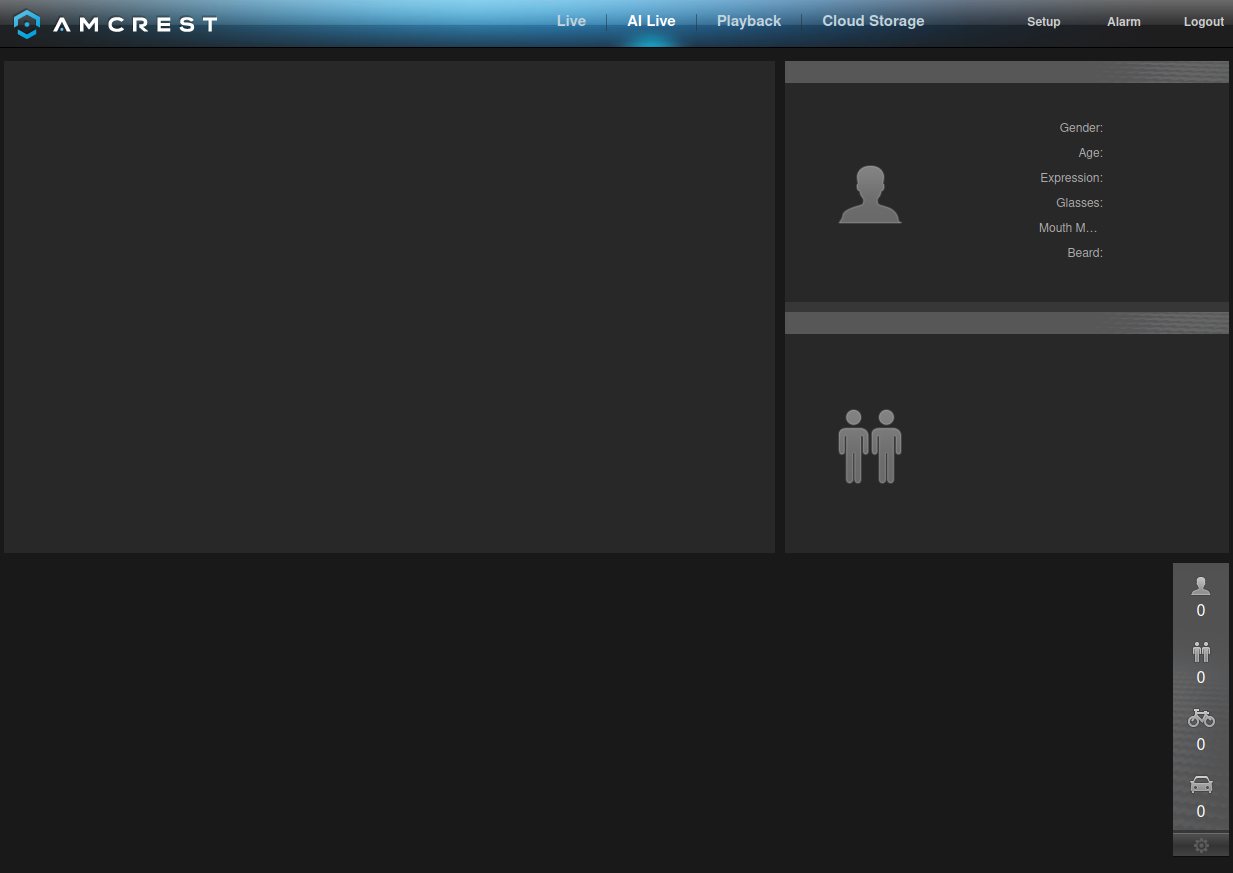

Hi, my camera is an IP4M-1063EW-AI, and the web interface has two modes "Live View" and "Ai Live View".
Live view works fine, but "Ai Live View" just displays a picture which is black.

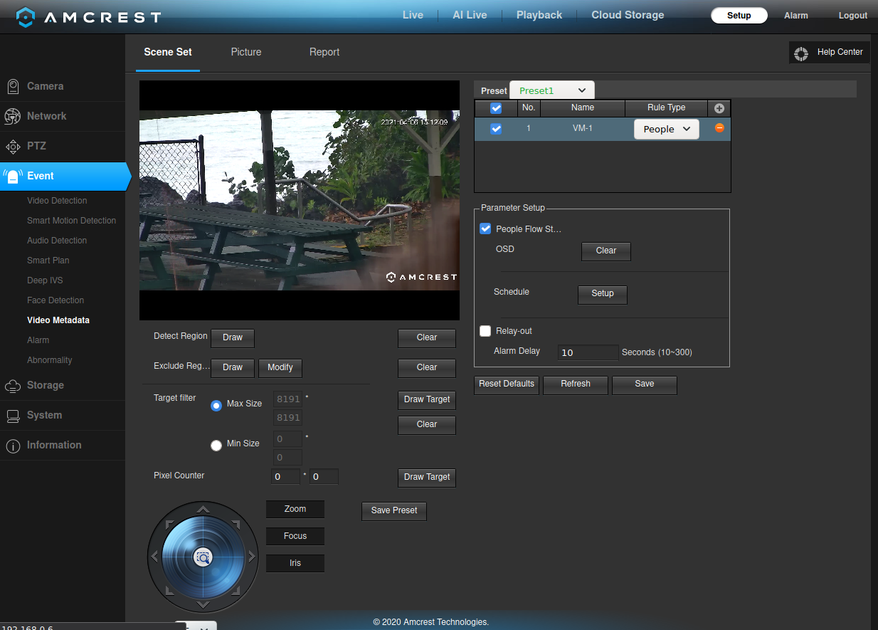

I've tinkered with adding "Smart Plan" presets and "video metadata", still no clue the "ai" functionality of seeing people is active.

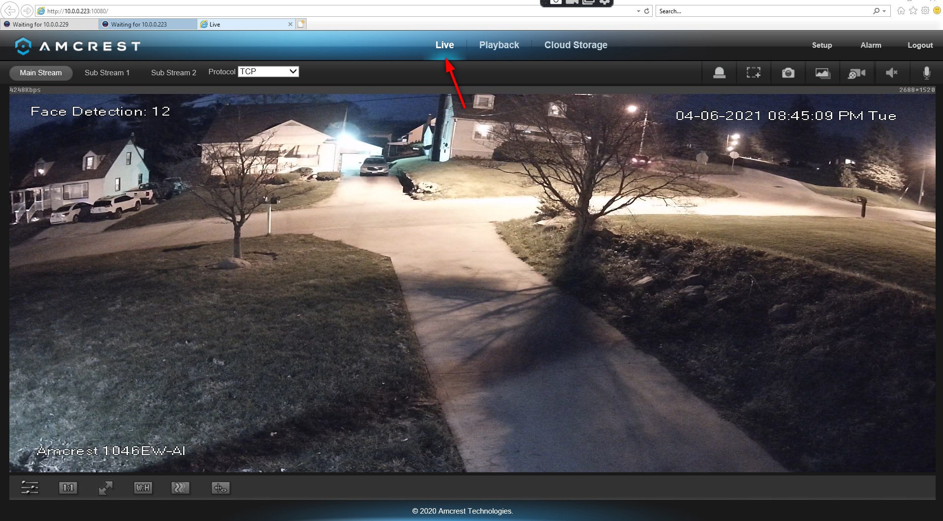

Can you take a Snapshot and let us see what your seeing? Looking at my camera and I understand it is a different one mine is a 1046EW-AI I don't see a AI Live VIew for mine? I know my AI DVR and NVR has a Live Mode, and Preview Mode that is General or AI Mode
Does yours offer a different ICON at the TOP? where I have the Red arrow?

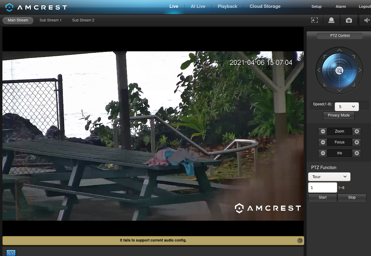

Yeh, it looks real swift ... but it doesn't appear to do anything.
- Screenshot_2021-04-06_15-12-15.png (336.68 KiB) Viewed 16171 times
- Screenshot_2021-04-06_15-07-09.png (638.38 KiB) Viewed 16171 times
- Screenshot_2021-04-06_15-07-47.png (68.07 KiB) Viewed 16171 times

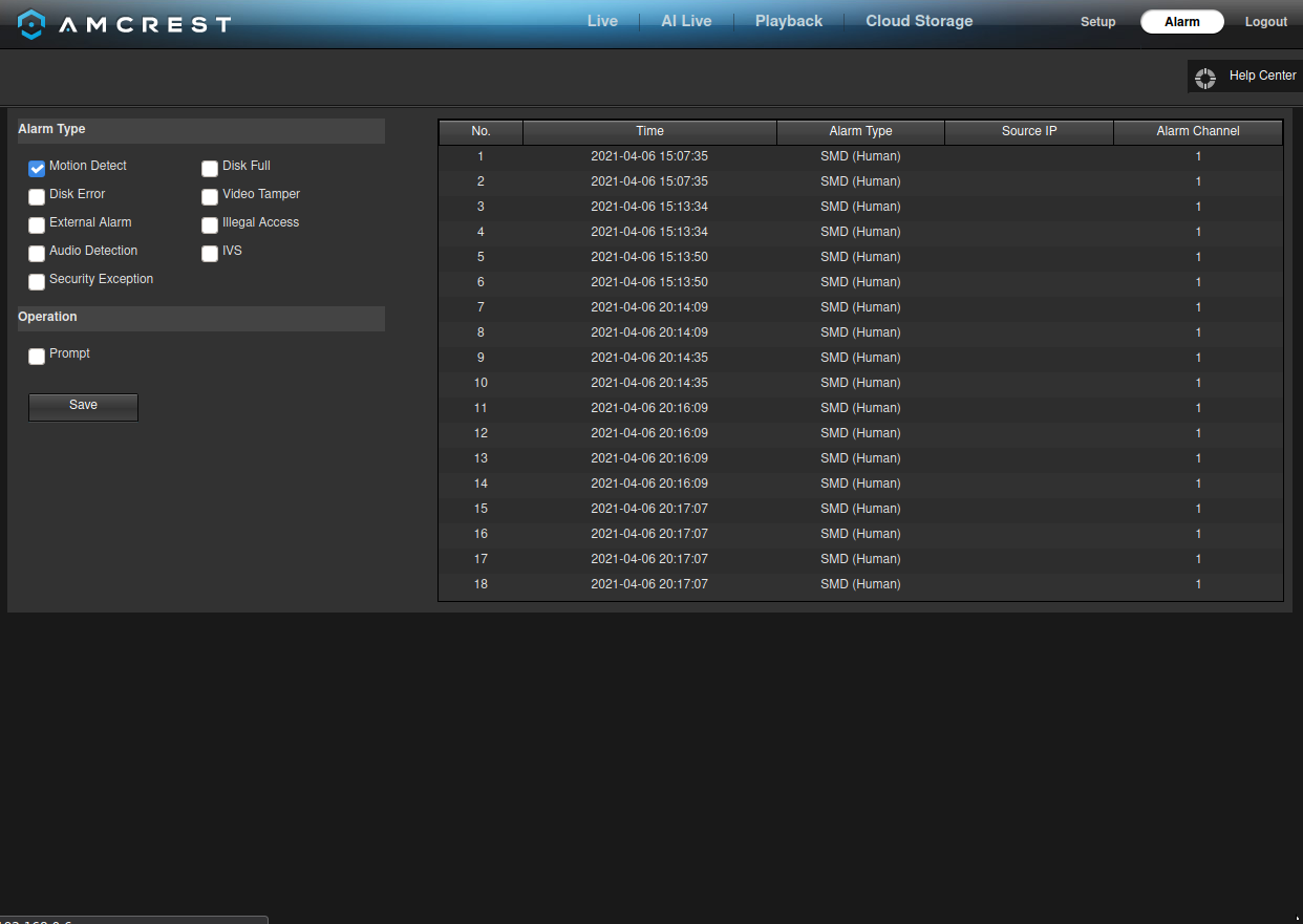

There is *some* sign of life, under "Alarm"...
- Screenshot_2021-04-06_15-17-37.png (108.83 KiB) Viewed 16171 times
