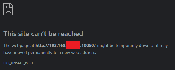

NVR: NV4108E-HS IP address 192.168.xx.111.
Cameras: IP5M-T1179EW-28MM (port-1), IP5M-D1188EW-28MM (port-2), IP4M-1026EW-28MM (port-3)
All devices have been updated with the latest firmware. All cameras are connected to NVR's PoE ports. I am trying to access the camera's webpage by clcking on the 'e' which directs me to
192.168.xx.111:10080 (1179 camera connected to NVR port 1)
192.168.xx.111:10081 (1188 camera connected to NVR port 2)
192.168.xx.111:10082 (1026 camera connected to NVR port 3)
My laptop has Windows 10 installed. I have tried browser(s) Chrome (without amcrest plugin) and Microsoft Edge (no IE compatible mode). On each camera, I am shown a login screen. I enter my camera's user/password. I am able to see the 1026 web GUI and I am able to get to the 1026 setup settings. However on the 1179 and 1188 when I click on the 'e' I receive this message. I don't get a popup where I can accept and continue to the camera.
I know the 1026 firmware is older than the 1179, 1188 (which use the same exact firmware). I understand you have been successful getting to the latter camera's web GUI via :10080 address.

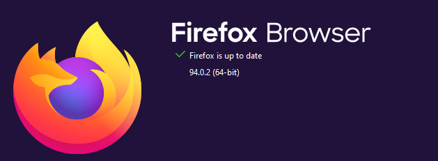

Success. I downloaded Firefox and I am able to login to the cameras plugged into the PoE ports by clicking the 'e'. After downloading Firefox
Firefox by default blocks 10080 10081... ports. To unblock the ports follow instruction found in this link.
https://support.mozilla.org/en-US/questions/1083282
when asked choose 'string' and enter 10080,10081,10082,10083,10084,10085,10087
