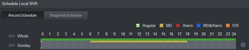

1. Storage - Record - MD
In this screen shot, I have Regular recording 24/7 and MD recording 6:00am thru 6:00pm.
I understand this setting schedules recording to the hard drive, but is does not stop sending notifications or sending e-mails during MD events.

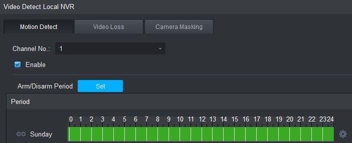

2. Event - Video Detection - Motion Detect - Arm/Disarm Period - Setting
In this screen shot, the period is set 24/7.
What does this setting do?
Does it control when notification, e-mail and motion is stored?
Thank you
Re: NV4108-HS Motion Detection Schedule
No in that Schedule it says when you want the system to work with Motion events
So above you have in Record Schedule that you want full time 24/7 and motion from 6 to 6. In theory you could change the Motion Detect area to work in 6 to 6 and have motion Record full time and you would still get 6-6 recordings because that is when you want the system to use motion..
Now in Recording that is when you want it written. Motion Detect is when you want it used. With it being 24/7 you can do other things on Motion but not record it, like PTZ a different channel or even that one on motion, log on motion, Maybe Snapshots only on motion or even alarm out on motion (If you had system with Alarm in or out) Show Message or even tour that channel (Pop up channel full screen for Anti Dither time) but only want it to record from 6-6
Nice to clear that UP I was just about to reply to something that was just kind of talking points of what I already said..
Then sadly no that isn't how it would work. If you setup turning off in the Motion Detection even though you are asking for MD to record it wouldn't record even if setup if you turn off Motion Detection in Scheduling.

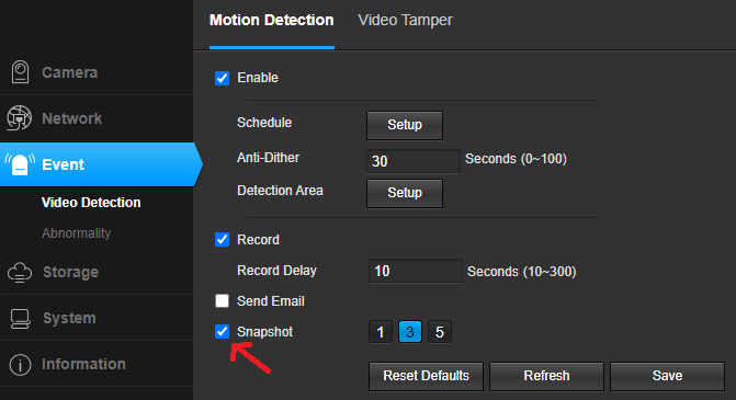

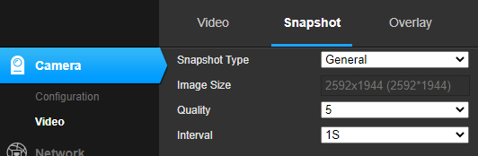

I connected the camera to my PoE router (not to the back of the NVR) and logged into the camera's webpage.
Is this the setting to enable snapshot in the camera?
Camera - Video - Snapshot
or this
Event - Motion Detect - Snapshot
Thank you,
Yes that is however the issue is that you need to adjust for Event that is General. The General would be full time snaps..
Where it says General click that and changed to event
Then yes you will need to enable the Snap on events. Then in the NVR you will also need to do it again for each channel you want setup for snap on events..
