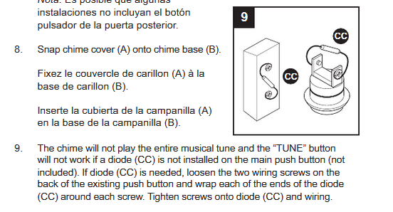

sorry i have an old maple chase mechanical chime that works well with the ad110. your electronic door chime manual mentions a diode would need to be part of the circuit for the tune to properly work. sorry i'm not much help.

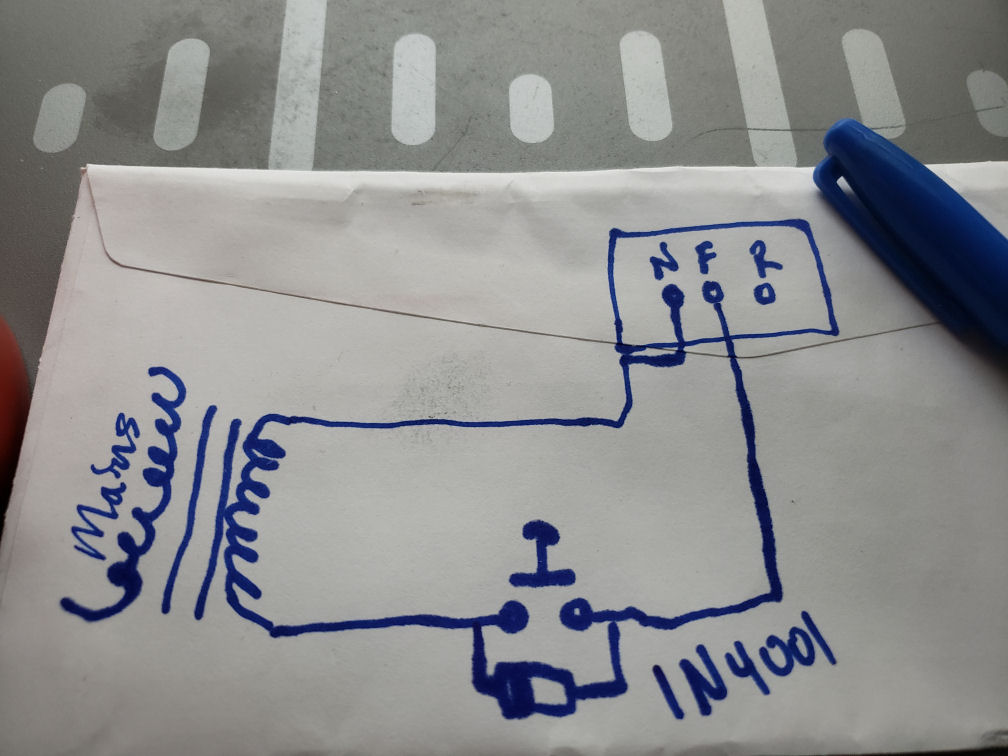

So tossed something together fast.. In this diagram it would be the Normal 16 - 24Vac Transformer to Door Bell and Switch.. This shows N F R on the Doorbell for the ones that have front and rear or might be B for back been a while since I seen one... Anyway this is for Front hook up very simple with just the Transformer wire going to N and second wire going to one side of Switch the other side of switch going to F of the door bell. Before it was that simple however now with things that last longer then just the Press of the BUTTON because really it was only a Magnetic Switch normally that would have a Spring so when you Press the Button it would PULL the Pen and hit the Tone bar then it would drop and hit the other one.. So new ones needs power to keep flowing this is not full power mind you by adding the Diode your only sending part of the wave form to the chime but the part that matters... This dirty and first drawing on a Envelope not to any scale.

Unfortunately this project had to go on hold for a bit ill revisit it next weekend. I understand your pictures and wiring. The chime I bought was used. I put it on the test bench and all was well with a normal mechanical doorbell. Short tone till I found a diode (used didnt come with 1) then it acted as normal. Now my question is where would the diode go with the new video doorbell?

Well I am going to guess it would just be Screwed down to the Terminals on the back of the Doorbell button as normal. There have been times I have seen some odd things where it did matter the position the Stripe was on. I think that had something to do with the Internal part of the Chime it self... Last kit I installed that needed a Diode was about 4 years ago. Some Chimes will come with one incase needed
Infact that picture that was put out I was just looking over at Home depot just now and the Hampton Bay Chime kit is where that comes from CC it comes with 2 and said to put it just as the picture shows from the other poster...
