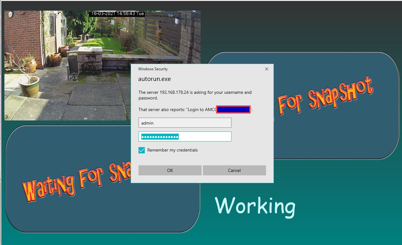

I'll explain my own post a little further and I was guessing that it was a similar situation/question that was being raised.
I take regular snapshots with my cameras, change the file names to a static name and then upload them to my web space. The web pages load the new images when anybody visits my site because they have static names i.e. always the same.
I've created my own app which almost does all this automatically without any intervention from me but the stumbling block is the Windows Security challenge. This screenshot shows what I'm talking about, here I've already clicked OK once and now have to click OK again to grab the second and same again for the third. The call that gets the snapshot is - http://xxxx:xxxx@192.168.178.26/cgi-bin/snapshot.cgi (where xxxx is username:password) and the result is saved to a folder where each is renamed and then ftp'd to my webspace. As I said all without any input from me except for clicking OK 3 times.
The ultimate aim was to leave my app running 24/7. A timer would run the process perhaps at half hourly intervals.

I was answering the OP on how to pass credentials to the camera via http CGI API, which you are already doing. I should have added that if using cURL in an app, digest authentication is specified this way:
curl -g --digest -u <user>:<password> "http://<camera-ip>/cgi-bin/.../.../"
In your case, I guess the Windows authentication prompt is from the connection to a Windows server to save the files?

Thanks. I'd tried that already with no success. Apparently, none of my browsers support that authentication method any longer.
I was able to write a powershell script though and pass the creds that way (had to remember to use https instead of http or it wouldn't pass the credential).
