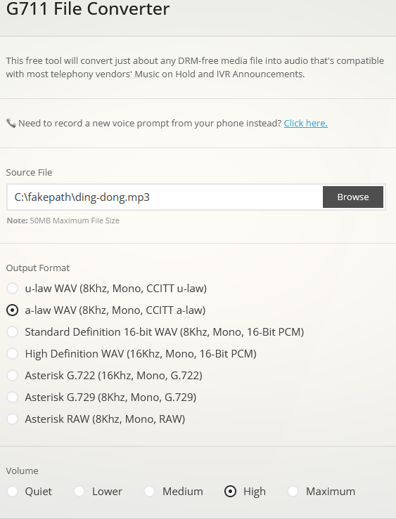

Hey - this works great! It took me a bit to understand G.711A audio formats and what exactly this Sox app was doing. Just an FYI - I found a free online tool at G711.org that will convert MP3 or other sound files to a compatible file that is a simpler alternative to installing Sox.
The 3 second max time works just fine to complete the POST operation. There is an alternative way to send a multipart stream where the second part is a boundary that will terminate the POST. That's a bit more complicated to deal with and not really needed for AD410 announcements.
Here's a screenshot of the G711.org File Converter free online app:
