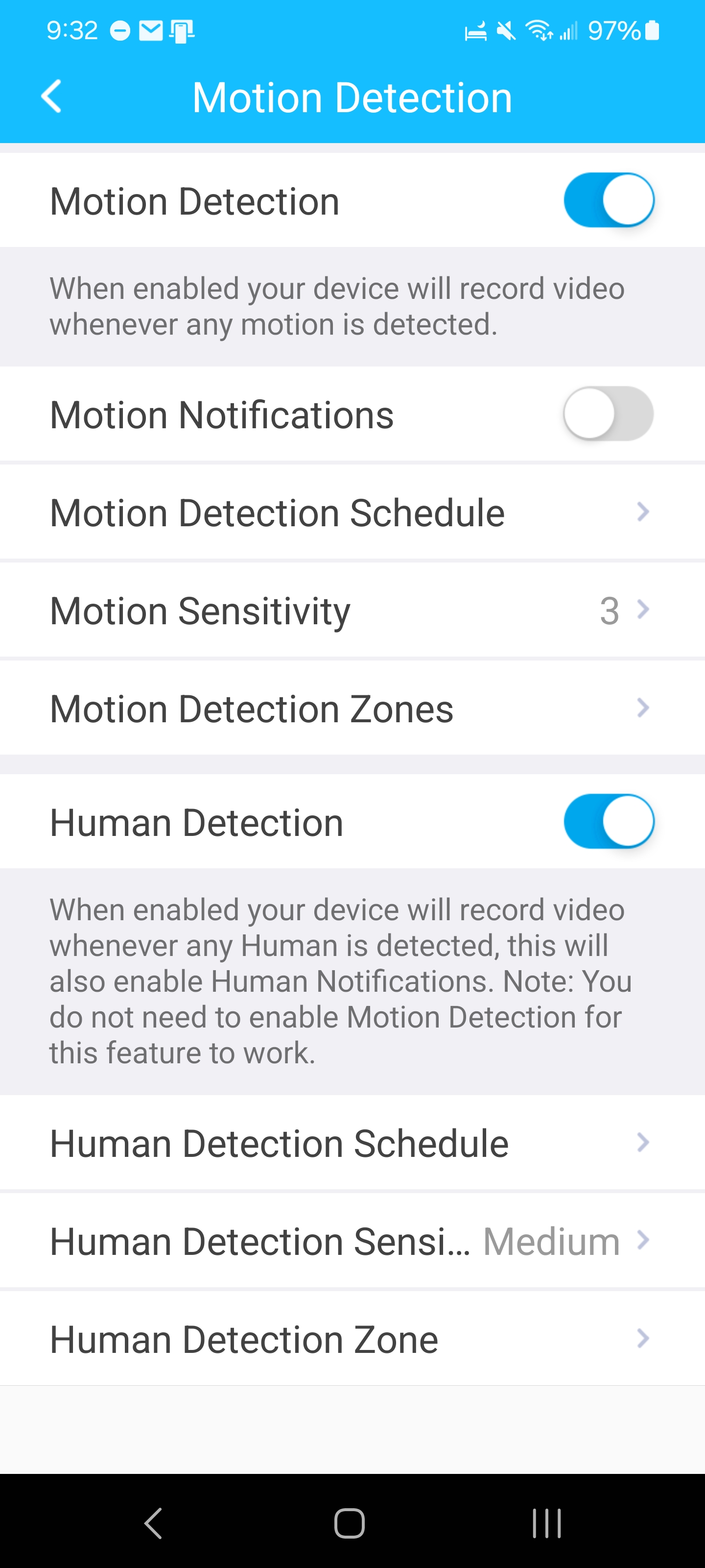

I would double check you have motion alerts enabled. Might be with some alerts that was nothing you wanted to see you turned off the alerts for motion. I have mine turned off for that reason.
Screenshot_20240703_093255_Amcrest Smart Home.jpg (591.12 KiB) Viewed 40423 times

Thanks, it is enabled. I checked it before, and just to be 100% sure I just checked it again.
I even tried the typical IT workaround. Disable it, and enable it again. No difference.
