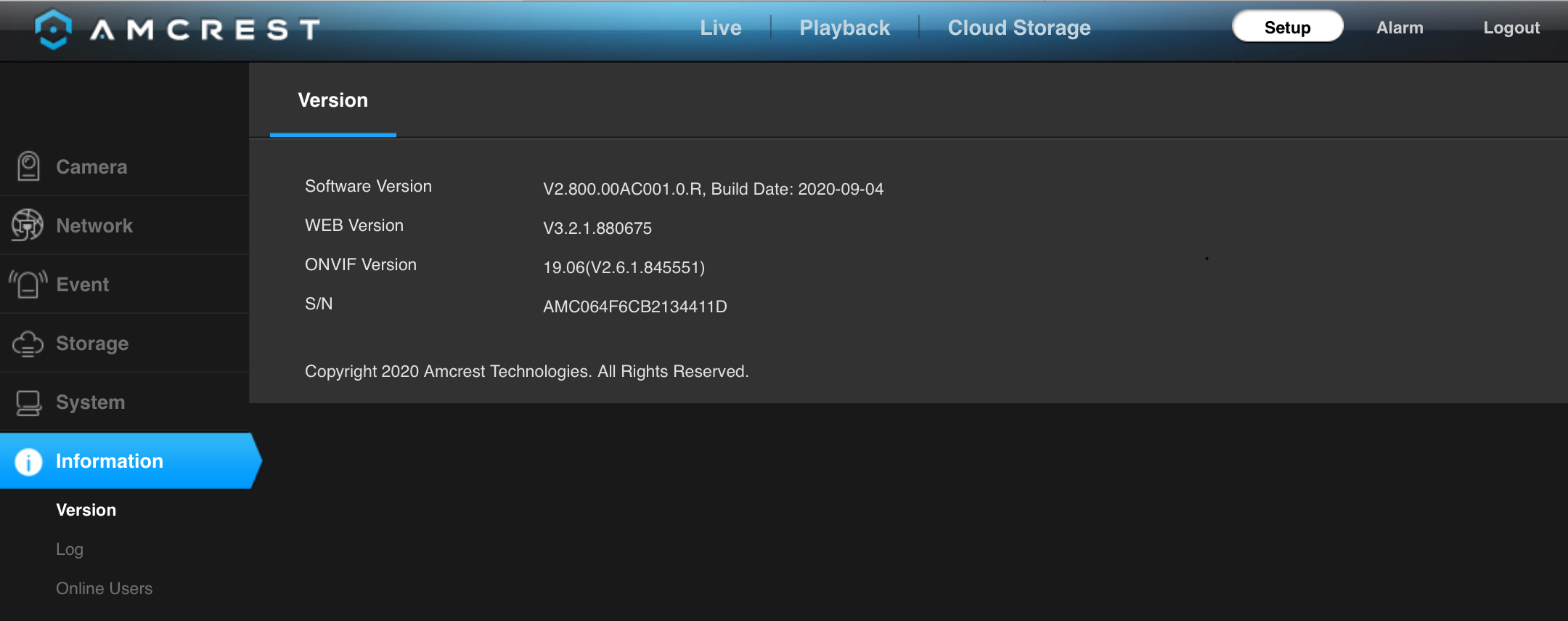

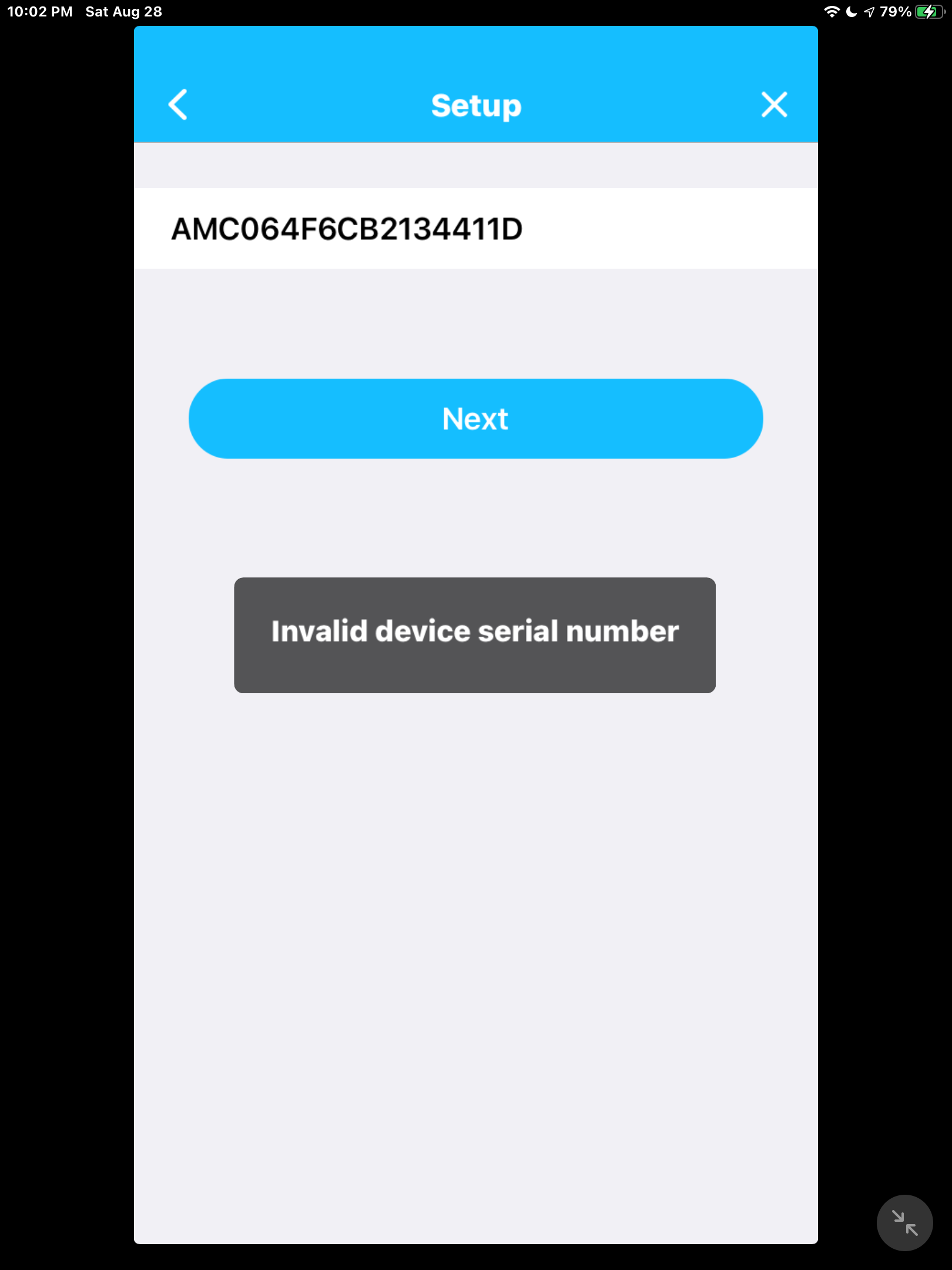

Trying to add my camera to the smart home app. The app will not accept the serial number. It says it’s invalid. I am able to add it to the view pro app with no issues.
The serial I’m using is AMC064F6CB2134411D. As you can see from the pictures, this should be the correct number.

The sad truth is that your 8MP camera isn't a Smart Home device so it will not add to the Smart Home App. You want to add a camera to Alexa then you will need to buy a Smart home product that can work with Alexa..
2 different Products and while some Smart Home devices can work the other way around, RTSP, ONVIF CGI and the like, Smart home products are a line of its own.. They won't let people use normal cameras on the Smart Home app.. Different servers, different codding. When the Product first was released it did work with normal IP cameras however that was found to be a Fluke as soon as it was noticed Amcrest did a new update and had moved the ability to work backward cross platform..
