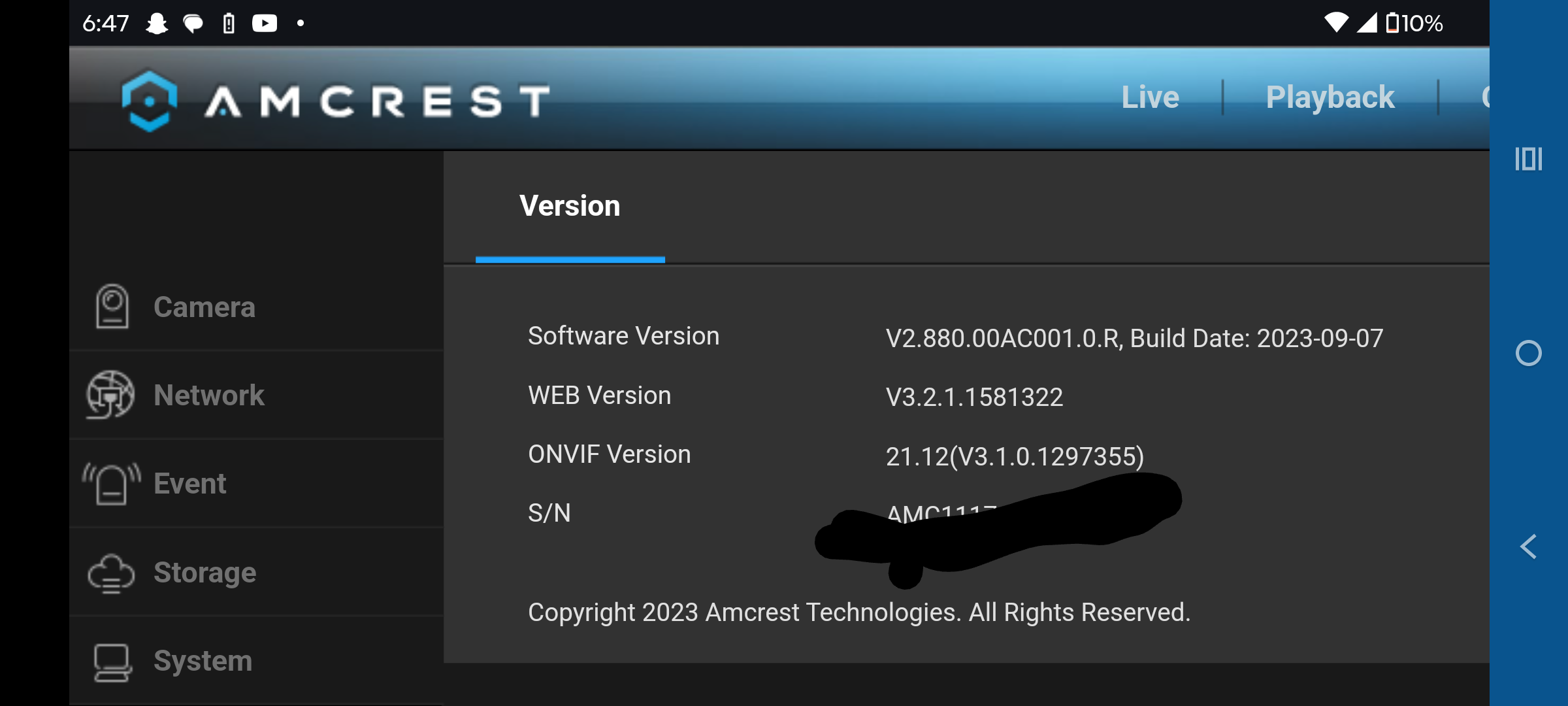

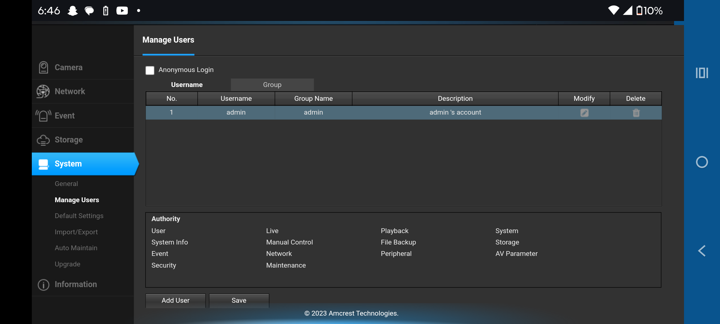

Could you provide a picture of your camears WebUI, Setup, System and Manage Users?

Here is a couple pictures..
- Screenshot_20250123-184651_Chrome.png (198.44 KiB) Viewed 10855 times
- Screenshot_20250123-184734_Chrome~2.png (264.44 KiB) Viewed 10855 times

So by Chance was Anonymous Login enabled by chance? If it wasn't please do a Factory Reset and see if the camera has the same issue after doing so? If it does then I would reach out to Amcrest Tech Support, I will pass it along and see if it can get into the hands of someone up the chain as this is not a great issue for sure.. Let me know what you find out so I know where to go from here..

No I dont think so. I tried to update the firmware through the web UI but it said no updates. But I just went to the firmware section of this website and I do think there is a firmware update.
The new version is:
V2.880.00AC002.0.R
10/24/24
I'm going to try to update the firmware and I'll report back.

So I upgraded the firmware and it shows the new version but the problem persists. I'll try factory resetting one but I don't believe it will fix the problem. I'll contact Amcrest.
Edit: I factory reset the camera (with the new firmware) and changed the password but it still persists. I definitely think it's a bug. I sent Amcrest a message so hopefully they can figure it out
