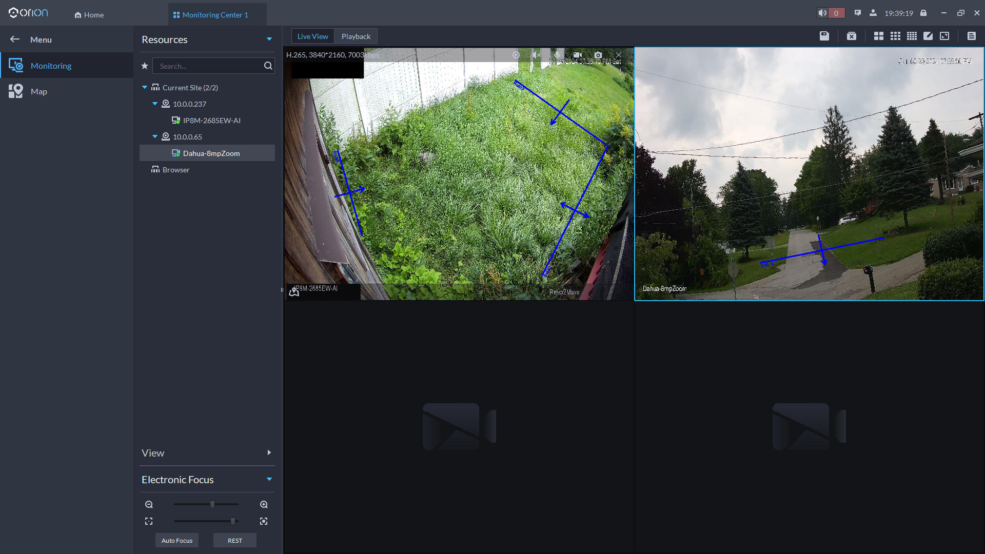

I personally don't know why there might be an issue. I have 2 8mp cameras right now one that is 20fps and one that only supports 15fps and both are on h.265 and have them both working in Orion. Is the issue while in full screen or in Grid view? or in both? My 20fps camera don't get much traffic so I can't say that it is working perfect. My 15fps is a Dahua Zoom camera that is facing the road at 12mm lens or there about. So I guess I could zoom it out and see if the images are the same after taking it back to 2.8mm. The reason I say this, Right now I have not had any issues on Orion in the current setup and or view area. When a vehicle or person goes by the image is clear and there is no issues with choppy view.. Now this is with Orion running on a I7 10700 16gb ram and video is a Super RTX2070.. Not that the hardware matters much.
Re: Anyone setup Orion yet?
Right click and view in different tab to see full screen but here are the 2 cameras so you can see they say they are in h.265 I hover over both screens. No issues in Grid view or full screen.
Screenshot (1986).png (1.51 MiB) Viewed 15749 times
Screenshot (1987).png (1.51 MiB) Viewed 15749 times

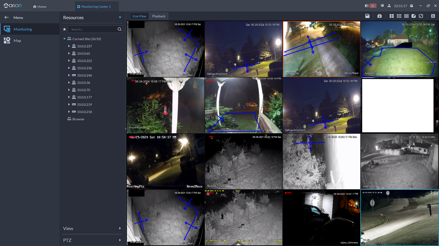

So I did have to reinstall my Orion today because I forgot the user name being used lol.. So I added in the first 2 8mp cameras.. I just added in a few others and while I will admit before adding them I was 55 to 65 % memory use. After adding still the same.. So I removed one of the channels because I don't display that one normally and forget not to add it.. But the bottom 2 pictures is with others added in and the other shows CPU data..
Screenshot (1988).png (1.49 MiB) Viewed 15748 times
Screenshot (1989).png (861.99 KiB) Viewed 15748 times
