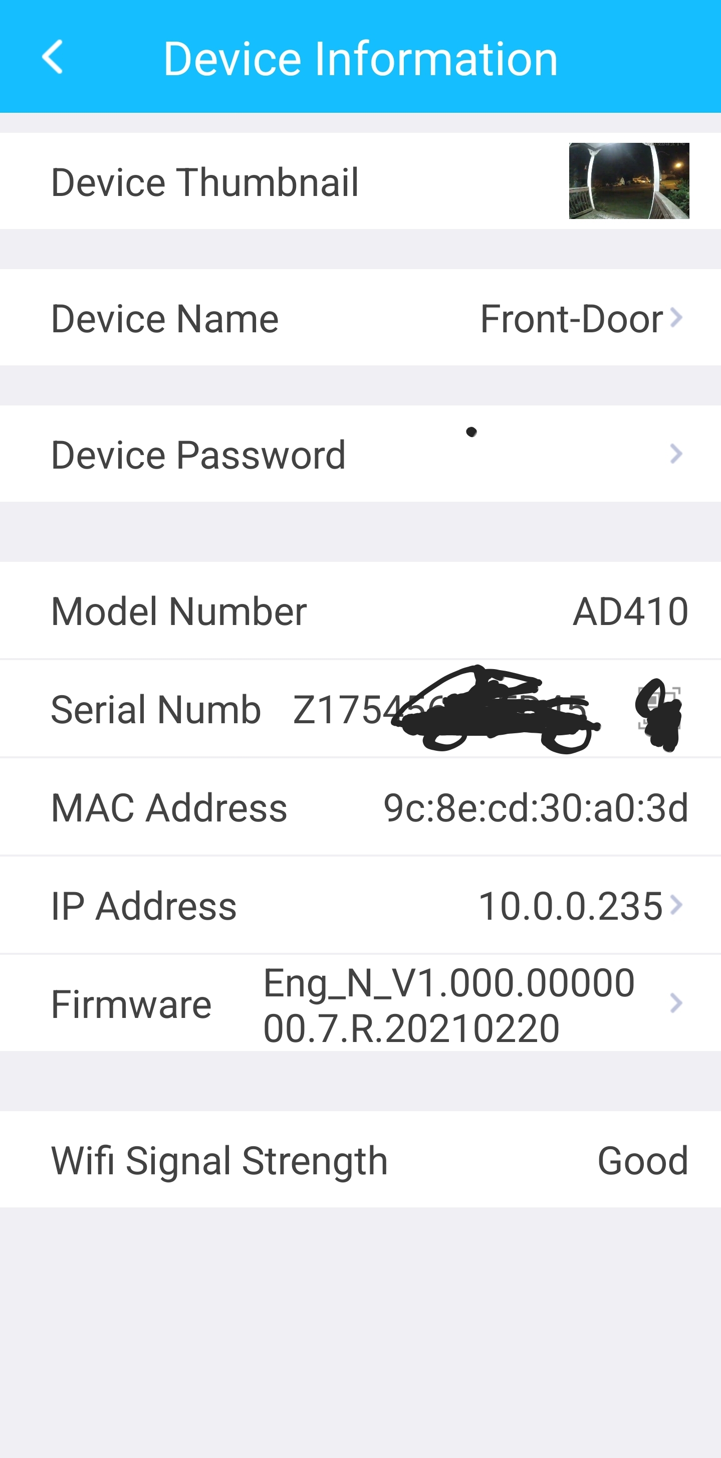

I have an amcrest ad410 door bell.
I am usable to connect to home assistant.
The amcrest smart home is installed on my android phone and work as expected.
In home assistant I enter admin as user is that right?
I enter the password that I wrote in android app.
The firmware version is: ... 7t210220. Where can I find the latest? How can I install it?
Best regards
Thierry Vorms
Re: AD410 Not able to connect to home assistant
Hello and welcome to the Forum.
My guess is the FW is Current however I will post a FW page that does have some Smart Home products on. My AD410 is said to be current and as per picture looks like yours I am guessing.. https://amcrest.com/firmware
