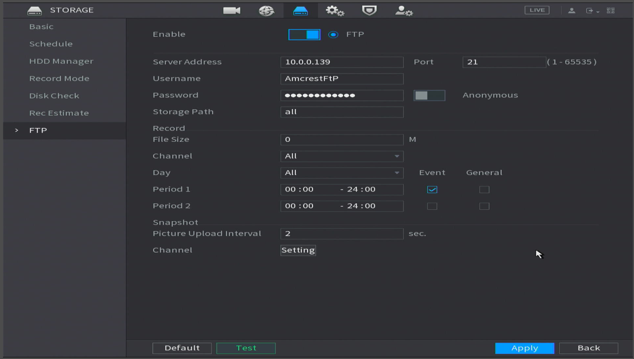

Personally I am not sure ASP will help you much outside of Playing back files that you have on your NAS.. I know within a IP camera there is an area that offers NAS as a Storage Device. Most times you will want to use the Device it self to setup going to a NAS not having ASP trying to make it happen..
From a DVR and only thing I can find on any of my Amcrest or Dahua DVR's is FTP and I know that you can setup a NAS system as a FTP server as well.. That might be the way want to try and work this..
I do know that my Hikvision products have the ability to connect to a NAS on my Dvr's but to be honest with all the issues that I have had with that system as a whole I am not sure it would work as simple as just typing in the IP and port and give permission in side of the NAS for such.. I say this because that device has issue trying to save to my Local Computer when I connect over WebUI.. It worked 1 time until I changed the Folder I wanted it saved to. Since then it has never worked again.. Even Reset back to factory 5 or 6 times since and the same result. Strange part about it is now all Hikvision products OEM or non OEM will now all fail it is like my Computer has made a rule never to let any Recorded file enter the computer or picture GrRR..
About the Amcrest.. My guess is I would try and setup your NAS as a FTP server and that would be the fastest way to do it.. Then in your DVR, go to Network, FTP and put in the data needed to access it and you should be golden.. Personally I wouldn't change the File size just leave it 0 means it will record and transfer the size needed. When I have tried to change mine seems I get issues, after going back to 0 it works just fine..

So like I was saying I wouldn't personally give up on the idea if there is something that you feel needs to be Recorded and kept more secure then your DVR I would set FTP.. It is something that is able to be done from all of my DVR's and should be an option in yours as well..
So for me I have mine setup for Motion, I have had it setup full time but there was no need for that on my DVR because all my Audio is on my NVR's these days where in the past I had some Mic's on my DVRs so I would have full time recording setup FTP sometimes it isn't always what you can see but what you can hear that can be Helpful...
So for Snapshots I have all channels setup there as well. Now to be Honest if there is no 100% need for all your channels to get FTP for Longer secure storage then in there I would only choose the ones that are most important.. I have the Recorder doing Motion and I have my NVR's on the ones I feel are important setup Full time Recording but motion is best for most..
Anyway I would setup and test that it works at least it will give you some peace of mind that the most important cameras to you are being backed up even if you don't have to look at the files once you make sure they are being stored.. At least they are there if you ever need them to be...
