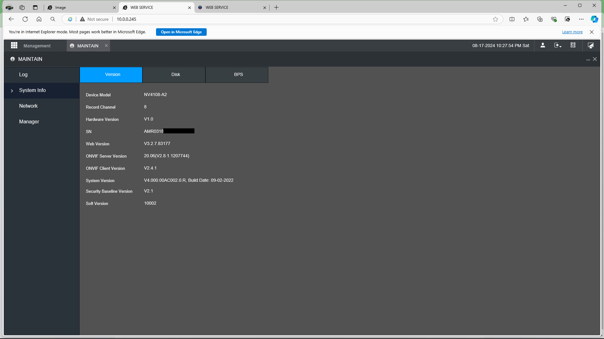

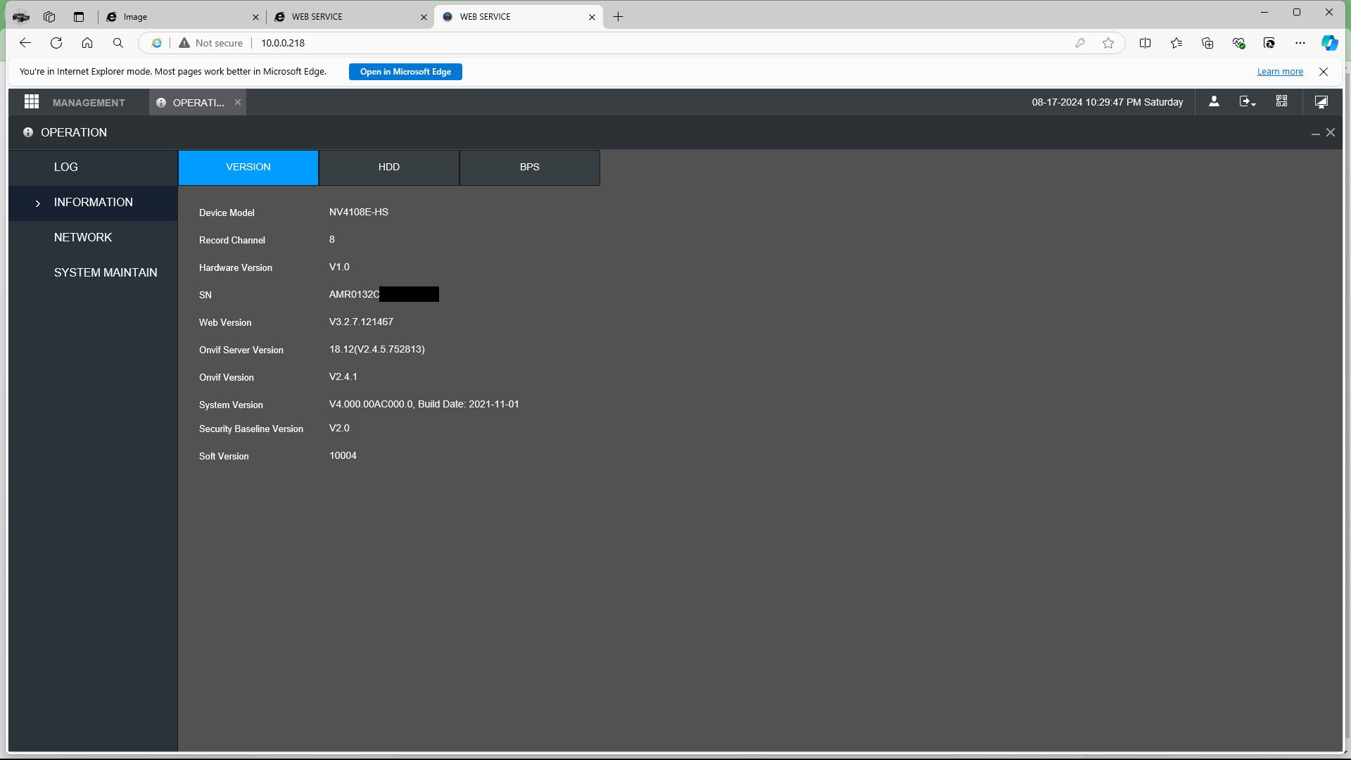

First 2 pictures are of my 4018E-HS and my 4108-A2 NVRs, In both places using WebUI, from the main menu click on Operation in 1 or Maintain in the other. it looks like a icon of the main page with a Speedometer, Both of them stay view system info, system update and so on. Then click on the system Info page and in there as you can see from the pictures below it will show the Firmware that you are using..

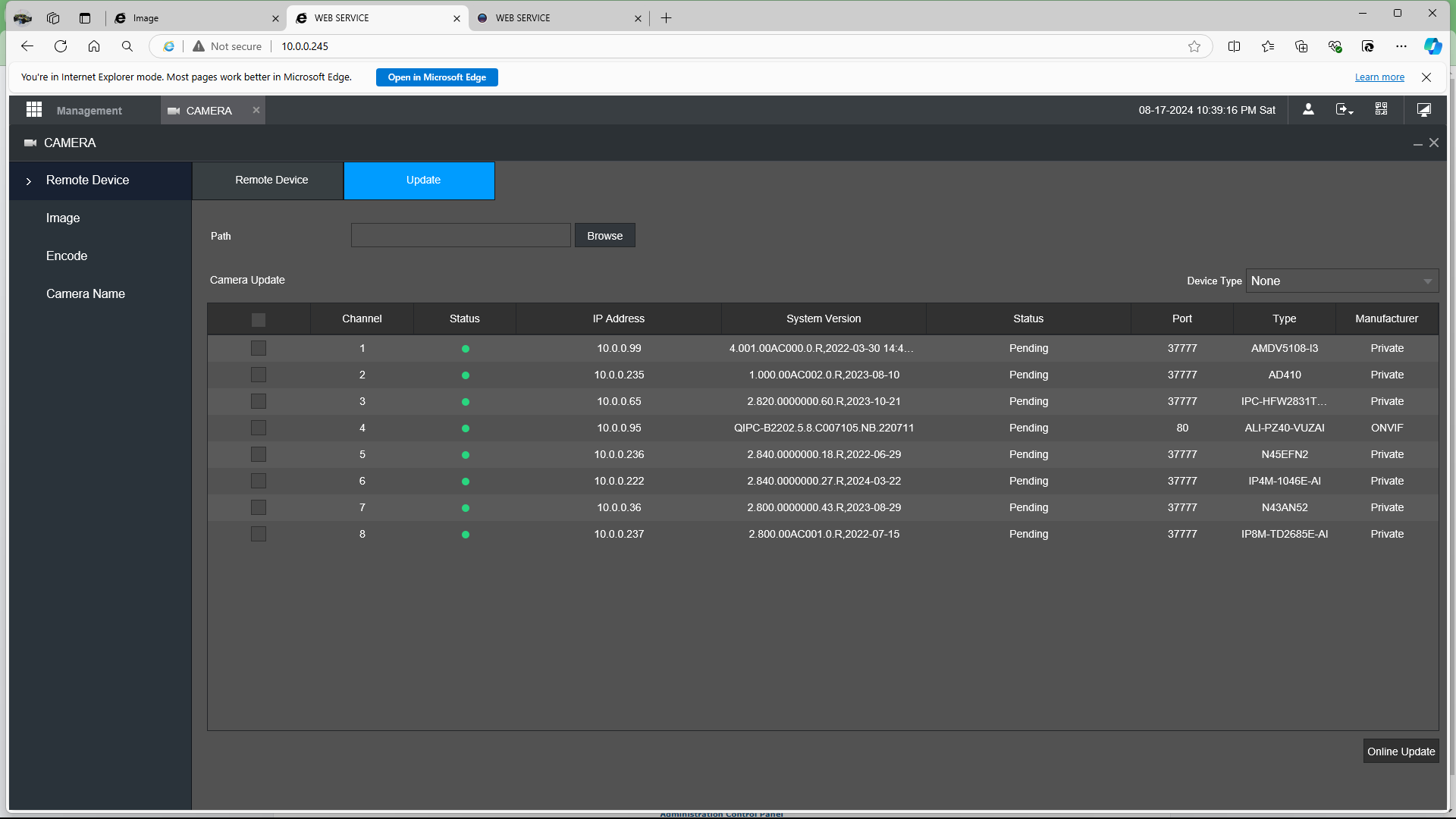

When it comes to your cameras? This might be little different! With cameras connected. You will want to again from the main menu of your WebUI of the NVR, this time click on the top Management, then click Camera. Then at the top of the page there will be Update that is the second tab next to Remote Device see the 3rd picture. This is showing my 4108-A2 NVRs page..

Which one of those numbers is the firmware version?
Re: What is my current firmware version?
The one that says System Version and in the cameras list the FW numbers is the number after the IP addresses for the cameras..
