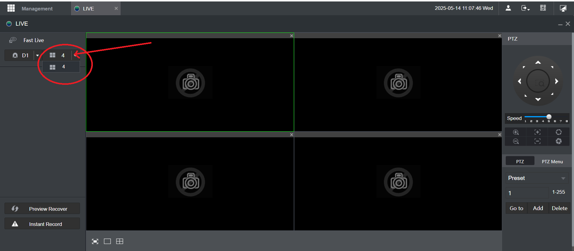

However.... trying to work and access the NVR from comfort....
When I access the NVR via the browser window, I am only able to view one or four channels. I have not found a way to increase that.
This is the screenshot, red arrow shows button press. Circle shows option.
What am I doing wrong? :mrgreen:

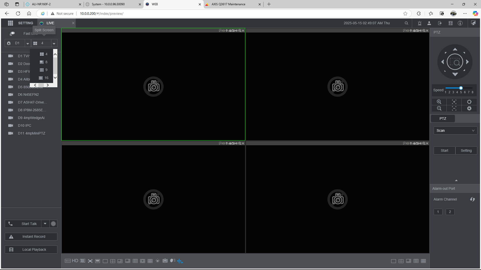

You will want to access your NVR using Edge in IE mode.. As you can see from this picture I can access many different options that is not on the Chrome or Edge Normal access..
Screenshot (388).png (105.81 KiB) Viewed 9748 times

AH! Yes. I had read of 'advisements' towards using Edge/IE. Did not realize they were more mandatory!

I imagine the problem with not being able to use port 10080 is also not an issue in Edge/IE?

Re: Web access of NVR NV4116E-A2
Correct. 10080 works in ie of edge. Not in edge normal. When I get to my computer I will reply a way to bring ie to your desktop. Win 10 and 11 ie is still there just hidden
