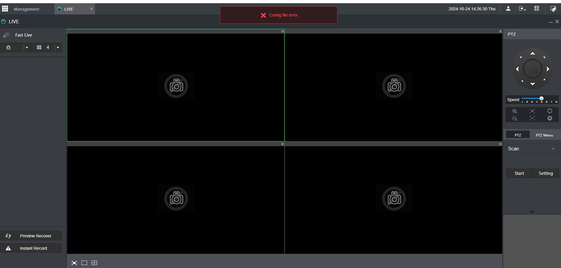

This was working and then the http interface now does not show the cameras anymore.
using the console all seems fine. I have tried multiple browsers and well as rebooting the NVR
Any way to fix this?
Brand new NV4108E-A2
was working now "Config file error"
- live.jpg (59.18 KiB) Viewed 3498 times
Re: was working now "Config file error"

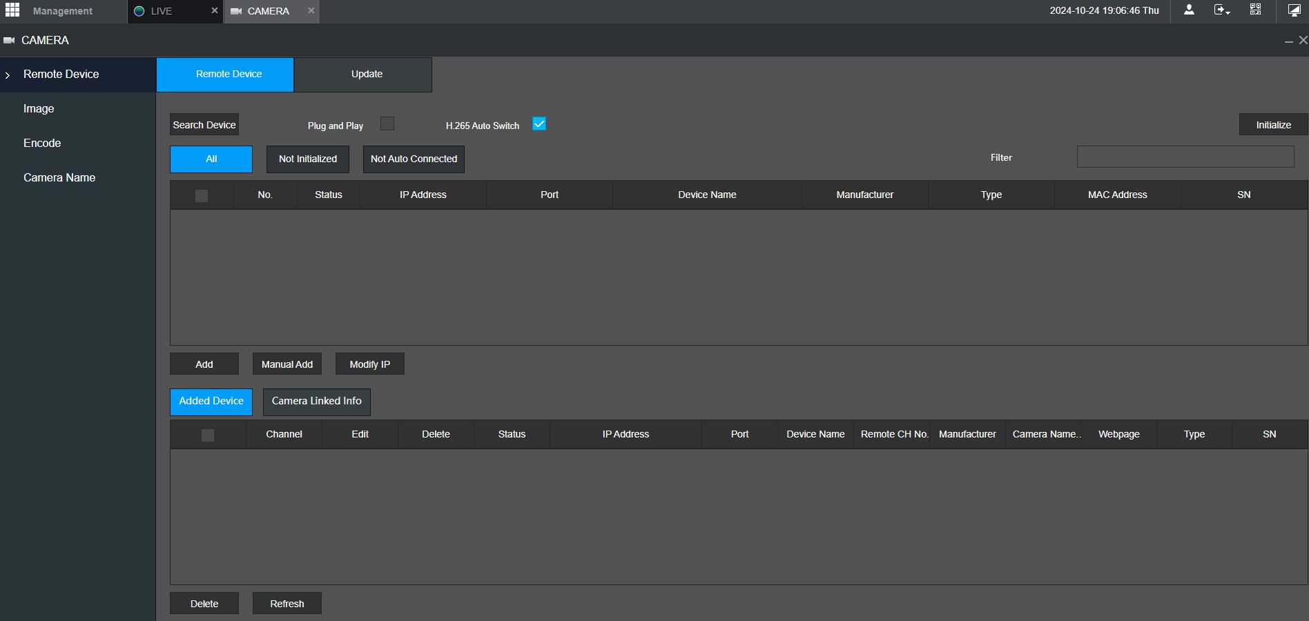

I am now testing with only one POE camera, I changed to H.264 per your recommendation.
all works fine on the console but even "cameras" on http shows nothing, not even the POE camera.
- cameras.jpg (70.12 KiB) Viewed 3482 times

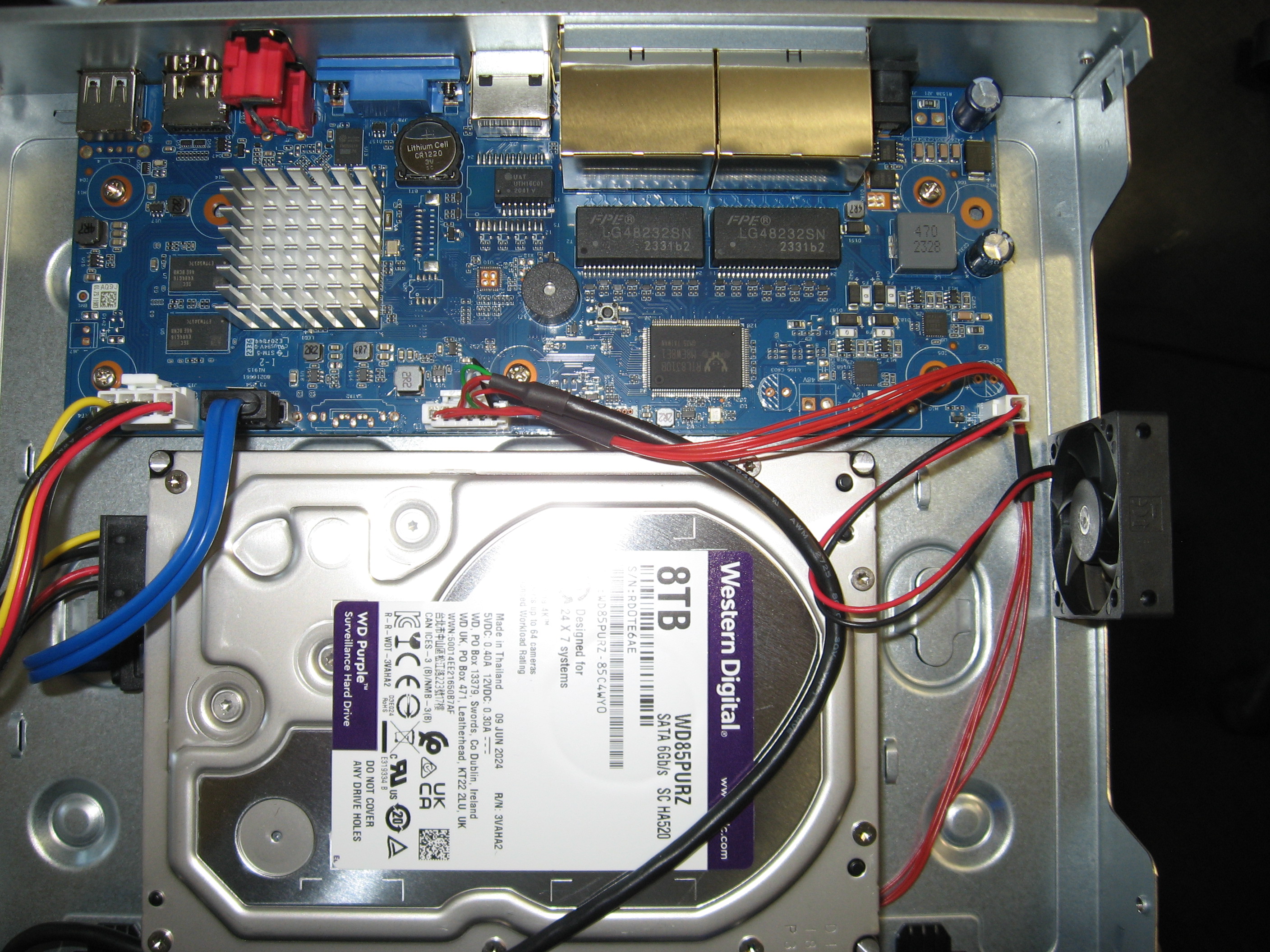

I there is a button on the circuit board. when pressed it does nothing. I also tried holding it down on powerup, again nothing.
The button is near the buzzer.
- IMG_0029.JPG (1.74 MiB) Viewed 3481 times

Here's how to use the button. It's not reset until you hear a beep.

So not sure if the page mentions it, If following the steps and the system don't do a Beep normally within 20 seconds after you turn the power back on it more then likely failed. If it fails, I would try again. Steps outside of what I am sure is posted but something to try. If it loads back in without a Reset, wait 2min, then reboot the NVR. again wait 2 min. Then press and hold the button for 15seconds, then remove the power, *Seeing you don't have a power button this part can be tricky* Yet you need to keep the reset button pressed while you remove the power, Wait another 15seconds and plug the power cord back into the NVR, Once the cord is restored hold it until you hear a beep. Normally winin 20 seconds. If you don't hear a beep until the screen pops up then the reset failed.. You will know if the reset was good because it will be back to a Set up NVR screen and not the Grid
Next if it failed remove the power and data lines from the HDD and do it again. The HDD has nothing to do with the software in the NVR and isn't needed to restore the NVRs factory settings..

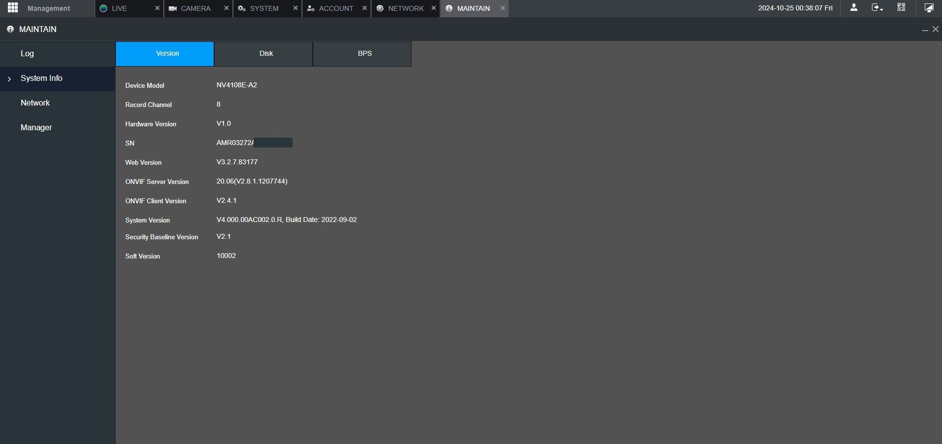

since this only affects the web interface, is my Web version v3.2.7.83177 the current version?
