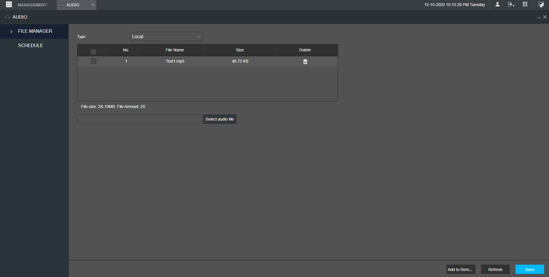

OK Thank you sorry I have not tried to use that and after that I have personally uploaded my First File into my NVR.. I am not sure what or how or why your MP3 isn't working. I did just make a MP3 file that is rather small and short and uploaded it to my system and now in my 0 to 20 I now have 1 of 20 loaded..
I am going to guess that it might be a Size issue that the MP3 format your trying to upload is to large maybe here is my test upload on my system

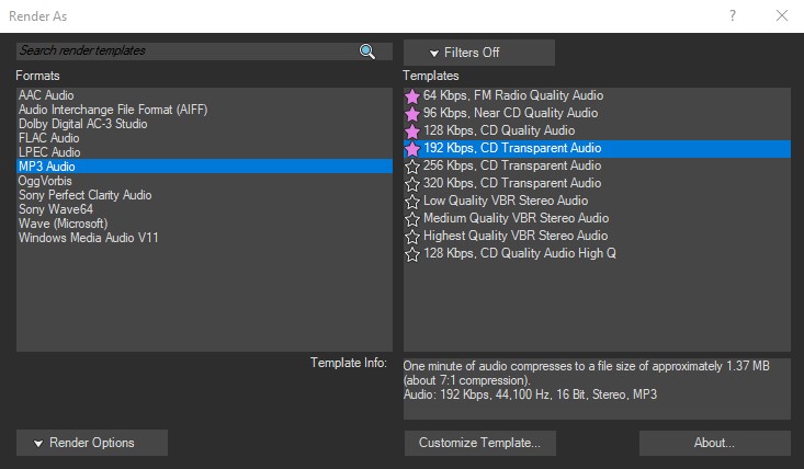

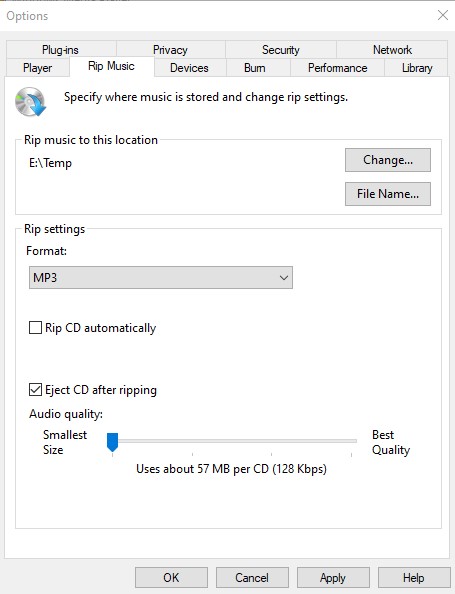

Still not working. I have tried MP3 file size between 100KB and 20 MB and MP3 quality is between 64 Kbps and 192 Kbps. I tried MP3 files from Amazon and also with Windows Media player ripper and Movie Studio version 16.0.
MP3 Import always failed. Where do you get your MP3?
- MP3 Windows Media Player
- mp3-wmp.jpg (43.22 KiB) Viewed 1048 times
- MP3 format Vegas
- mp3-screenshot.jpg (54.47 KiB) Viewed 1048 times
