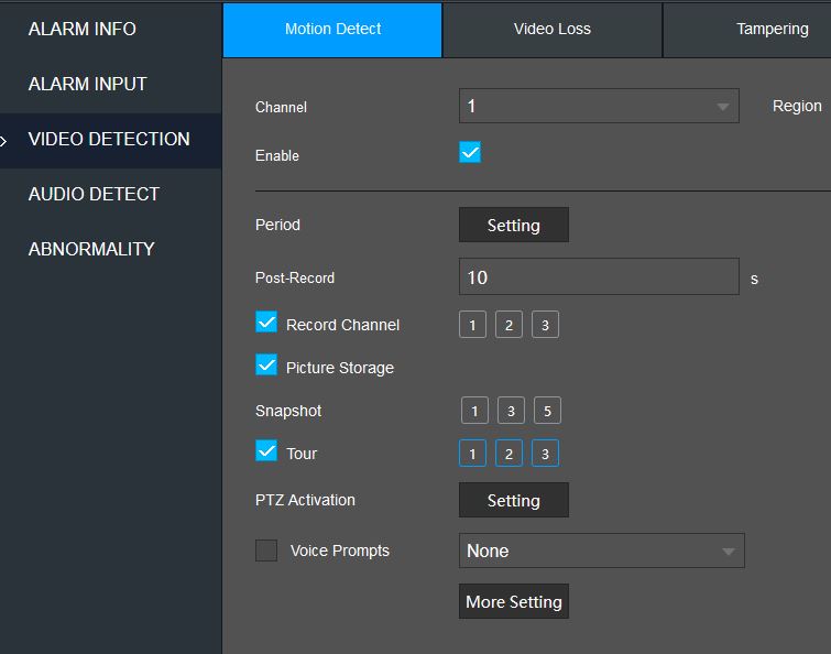

I made the mistake of upgrading the firmware of my NV4108E-HS to version V4.000.AC000 (dated 5/21/20)
On the bright side, there is no longer a need for the Easy Viewer chrome plugin to access the Web GUI.
However, I have lost a key feature -- the ability to send snapshots as an attachment via email when Motion is detected.
Curremtly, when motion is detected, the NVR dutifully sends an email. But NO ATTACHMENT is attached.
Anybody knows how to get this fixed with the new firmware? This used to work perfectly with the old firmware.
- I tried to downgrade the firmware, but that fails.
- I saved a backup on the config, did a factory reset of the NVR, then imported the backed-up config. this did not fix the problem.
I have attached a screenshot of my ALARM -> VIDEO DETECTION --> Motion Detect page.
Any help would be appreciated.

- nvr_motion_detection_settings.JPG (43.59 KiB) Viewed 1647 times

Re: V4.000.AC000 firmware no longer sends snapshot with email
@Revo2Maxx thanks for your reply.
But no, Image Quality settings did NOT make a difference. I tried all quality settings, from 1 through 6.
Again, let me point out that this all used to work just fine before.
Something in the new firmware has broken this feature.
I have sent support email to Amcrest, haven't received a reply yet.
As instructed by Amcrest support I did factory reset (no config restore and backup). That solved my problem.
To do factory reset --
OPERATION --> SYSTEM MAINTAIN --> DEFAULT
Ensure all checkboxes are checked.
Choose "Factory Default"
Thankfully my individual cameras retained their settings (name, sensitivity, threshold etc) but I did have to go through manually restoring all of the other NVR settings
Now it works correctly
