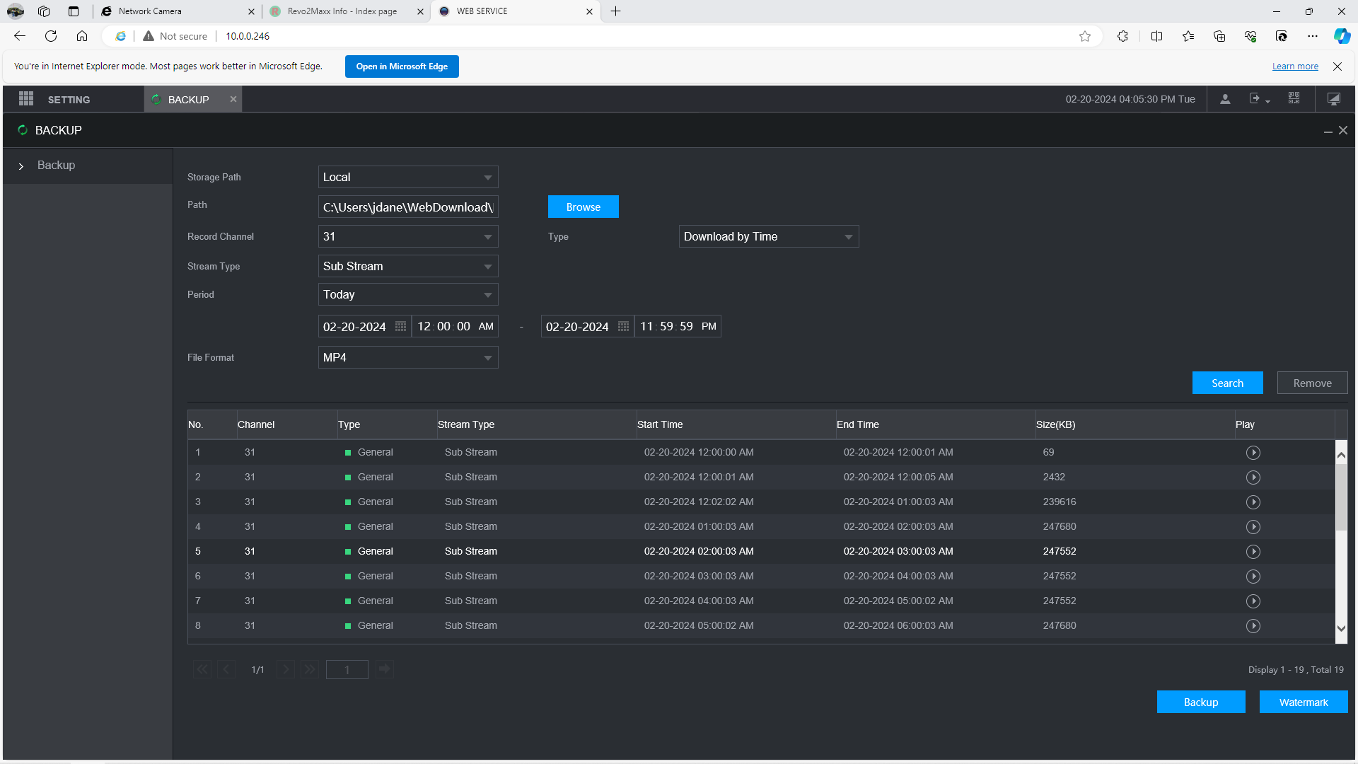

I would look at buying a 4 to 16 gb Thumb drive to transfer files. However if you are looking to do Mass amounts of footage then I would look to connecting to your local computer by going to the NVR's WebUI. Then in there you can dl the footage to your Local Computer. There are a few different ways you can do it. Looking at the picture below is from the Backup, On my ch31 and from full time recorded Sub Channel feed. Then you can pick the ones you want to save or DL them all.
