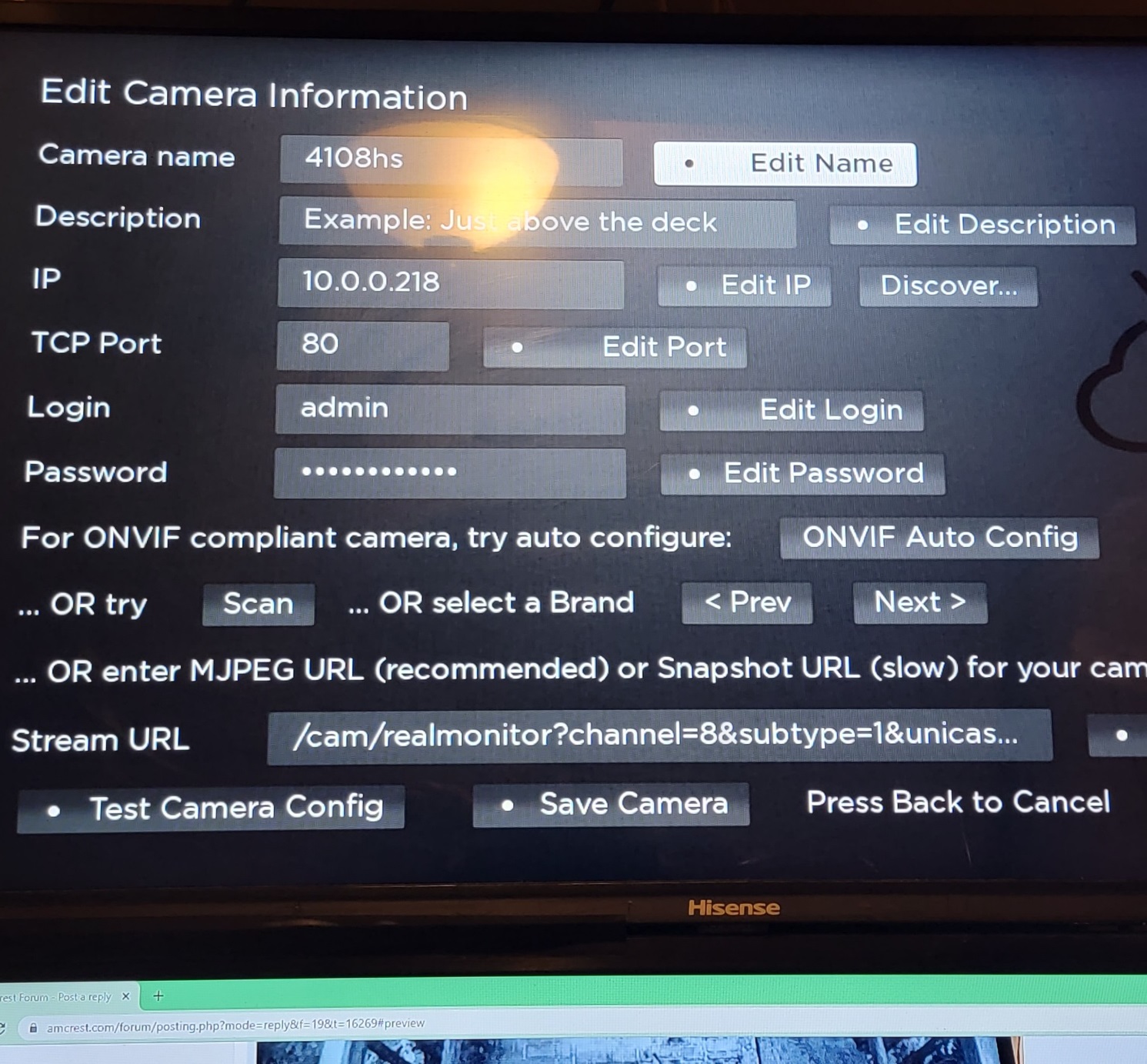

So yeah I have tried a good few times to add different systems. So after you post I moved it from one of my Axis cameras to a Amcrest camera. Now I will admit that I did try again to do a few different ways of connecting to all of my systems. None of the newer FW ones wanted to work.

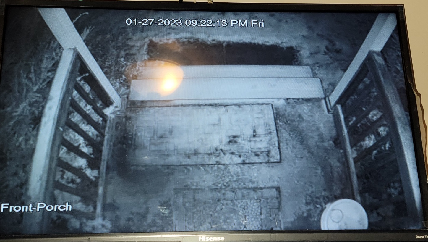

So then I went to a Camera directly and was able to connect to my 941 that I have on my front porch. Using this URL sorry about the picture quality but is what it is.. IF you right click the URL and make it large even though I made it 30% the normal size picture it is still big enough you can make out the URL..
So then I tried again a few different newer FW NVR's and couldn't get it to work. Then tried my OLD FW 4108E-HS and it setup to use CH5 and found that odd but was nice so it did work. I then tried all other channels before I found out what happened. One, when I make a connection to the 941 it changed the settings for my Sub Channel to MJPEG, So I change the Encoding to a few others for testing and sure enough I can stream full time video of any channels that works in MJPEG format.
Yeah I know I never took the plastic off my old TV lol. Normally only using it for one of my Security monitors so I don't care it is there lol..
Does your TV no offer Auto? I mean I did mine with what I remember using before and was able to get it to work. I tried Auto and was able to pull a couple of my other cameras that still work with the info from my TV. If you TV has the ability to search for URL, or even for IP devices I would do auto for both to see if it pulls in what is needed. I am using PORT 80 on mine.. Even tried it in 554 however 80 works fine.. Maybe it is just as easy to change your sub channel to MJPEG format Encoding. However if on newer FW might need to turn off RTSP Digest and make it lower security if there is an option in your device. I will try again on my DVR's In the last picture I have it working on Ch8 of that NVR where before changing the Encoding it would give a Broken LInk. NVR wouldn't let the system change the encoding and worked on Ch5 to start with because it was my 941 that had changed when going to it Directly.

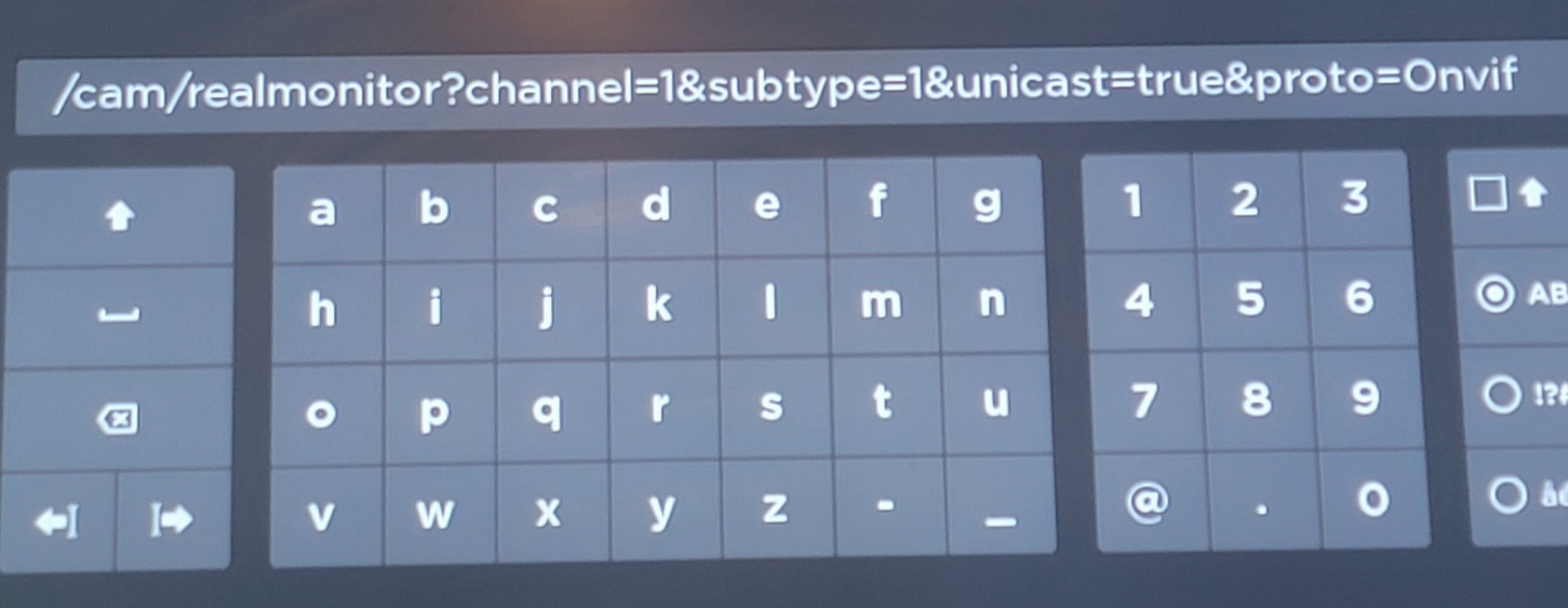

I noticed if I use the IP View App on Roku and hit "Discover" the app is able to correctly find the Amcrest DVR ip from the network. After filling out the details, I tried to use the "ONVIF Auto Config" but that did not discover any device. I also tried the link you sent manually:
/cam/realmonitor?channel=1&subtype=1&unicast=true&proto=Onvif
but that also did not connect anything. I noticied if I hit "Scan" the TV does discover the Amcrest link I tried using last-time:
/cgi-bin/mjpg/video.cgi?channel=1&subtype=1
But of course, after clicking "OK" to that link and then clicking "Test Camera Config" I still don't get anything.

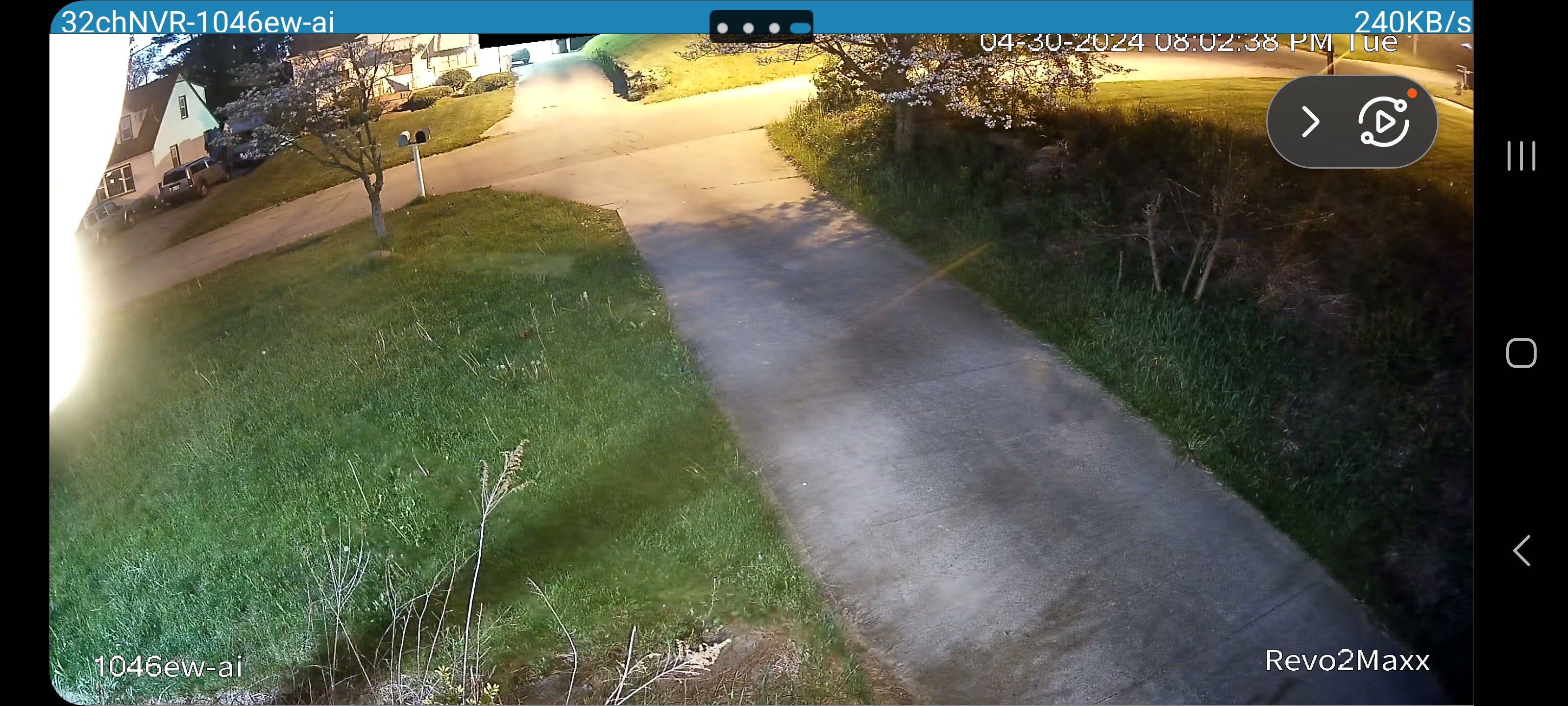

Tbh why degrade the feed Pogo had right idea about many option much better then Roku, this is from capture of my phone casting to my Roku TV. This is full size screen with quality image on the TV.
Screenshot_20240430_210239_Amcrest View Pro.jpg (2.35 MiB) Viewed 5478 times
