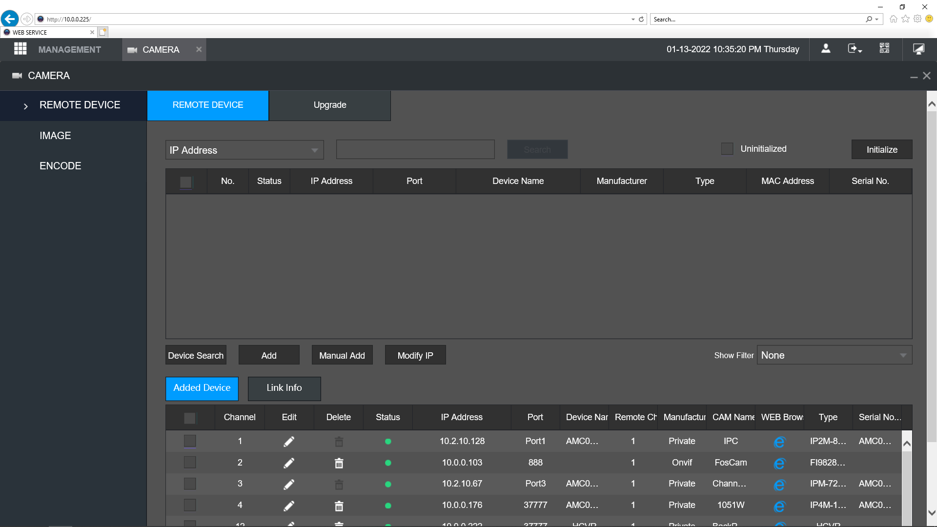

Then as I was saying When you add your cameras it will be like Magic and come right online but that isn't secure please log in your NVR's WebUI and go to the cameras menu and click on the e for the camera it will open a new tab with new port for the camera on your NVR's IP but different port number that will forward to your camera. IT will ask you update your cameras password Please do it.. Then exit the webUI after you look around if you wish but what is important is that you get back tot he NVR's camera list and click the Pencil and edit the password to the new password so the NVR can keep recording the camera..

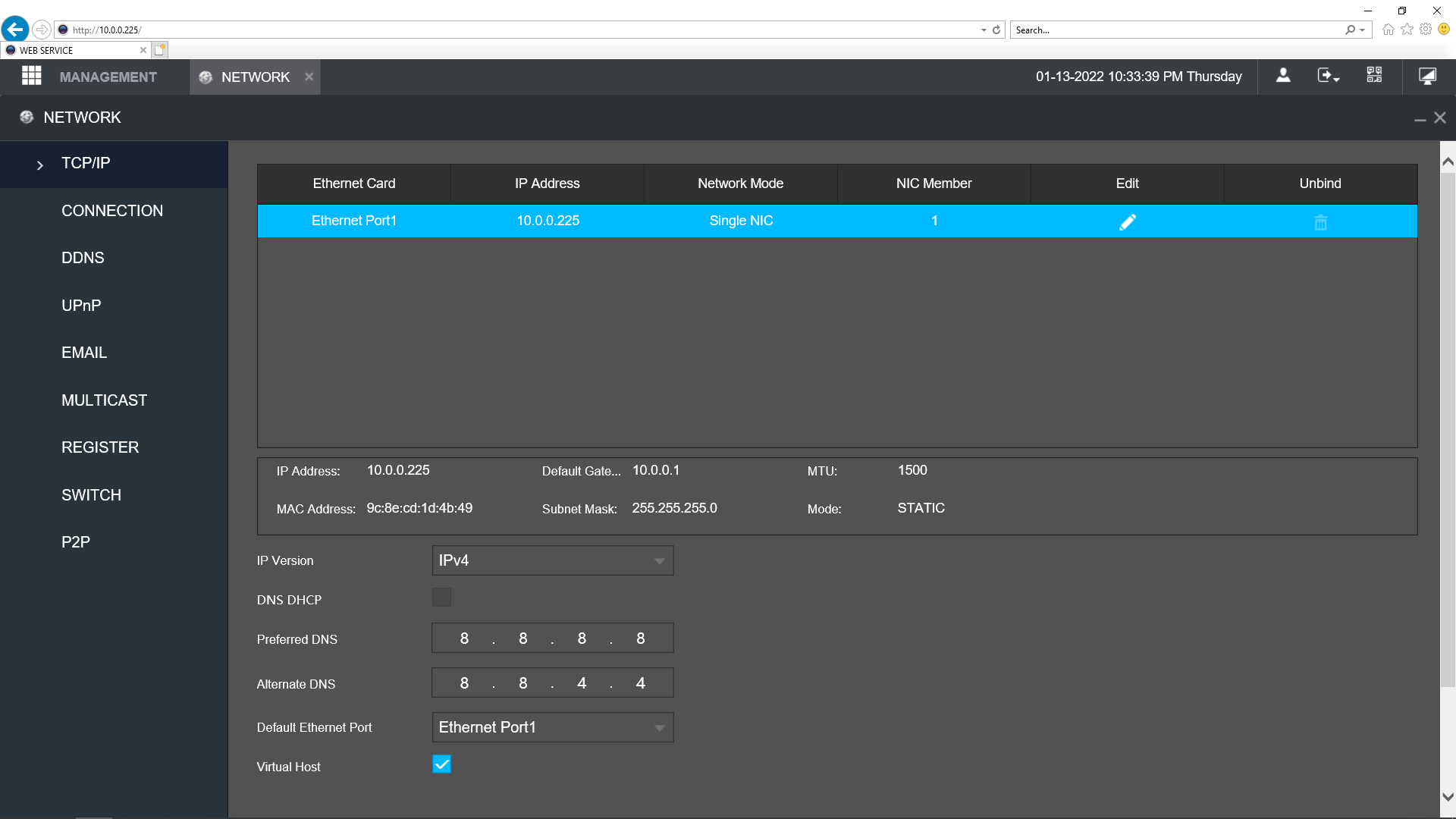

In your WebUI of theNVR there should be e if not then the pictures I have of my 4116E-HS shows where in 4.0 to turn on Virtual Host, First Picture is of my 4216e-AI NVR and realized that it has V host turned on by default... No on or off button on that NVR..

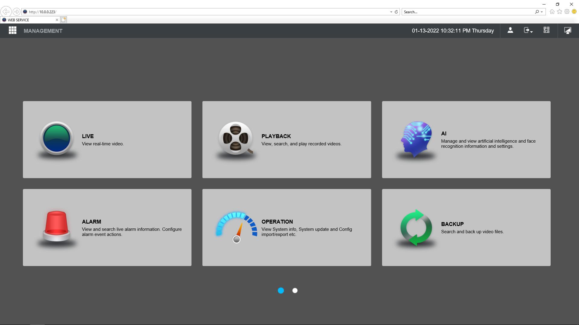

Main 4.0 page only different in non AI is the IA icon isn't there..
Screenshot (1777).png (169.72 KiB) Viewed 5874 times
This is where you would click the e in the NVR WebUI to gain access to the cameras WebUI over the NVR's IP:10080
Screenshot (1779).png (104.69 KiB) Viewed 5874 times
If you look at your camera area on the NVR and you don't see an e on the right like the picture above then make sure this is enabled
Screenshot (1778).png (77.27 KiB) Viewed 5874 times
