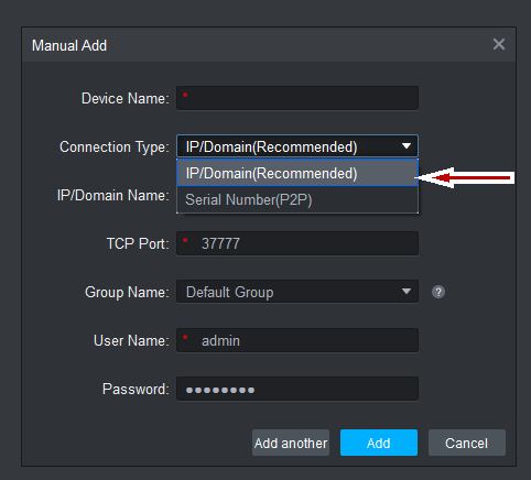

Hello and welcome to the forum.
The problem is almost certainly because you added the device/s to ASP using the P2P option. Try deleting the devices and then add them again but using the option "IP/Domain (Recommended)"
add device.jpg (22.93 KiB) Viewed 2185 times

Re: Surveillance Pro Access with/without internet
Yes the issue is as longedge has mentioned. However be it known if you take away the P2P you use to access the system your Remote connection will fail only Lan based connections will be able to happen...
So there are some things you can do. 1 Setup a System for Local access, Then Setup a System for Remote access that will have different phone or Tab to access your Remote session..
OR lets say you only have 2 cameras that are needed while away you could setup the 2 cameras in your phone as P2P that would be different to your ASP setup all together.. So as said before Setup in ASP using IP/Domain then in your phone setup your cameras that you want remote access to with P2P option.. Then your connection is to the 2 cameras you wanted...
But yes if P2P is used for access in ASP then your system will not work even local when the Internet is out or on slow speed...
