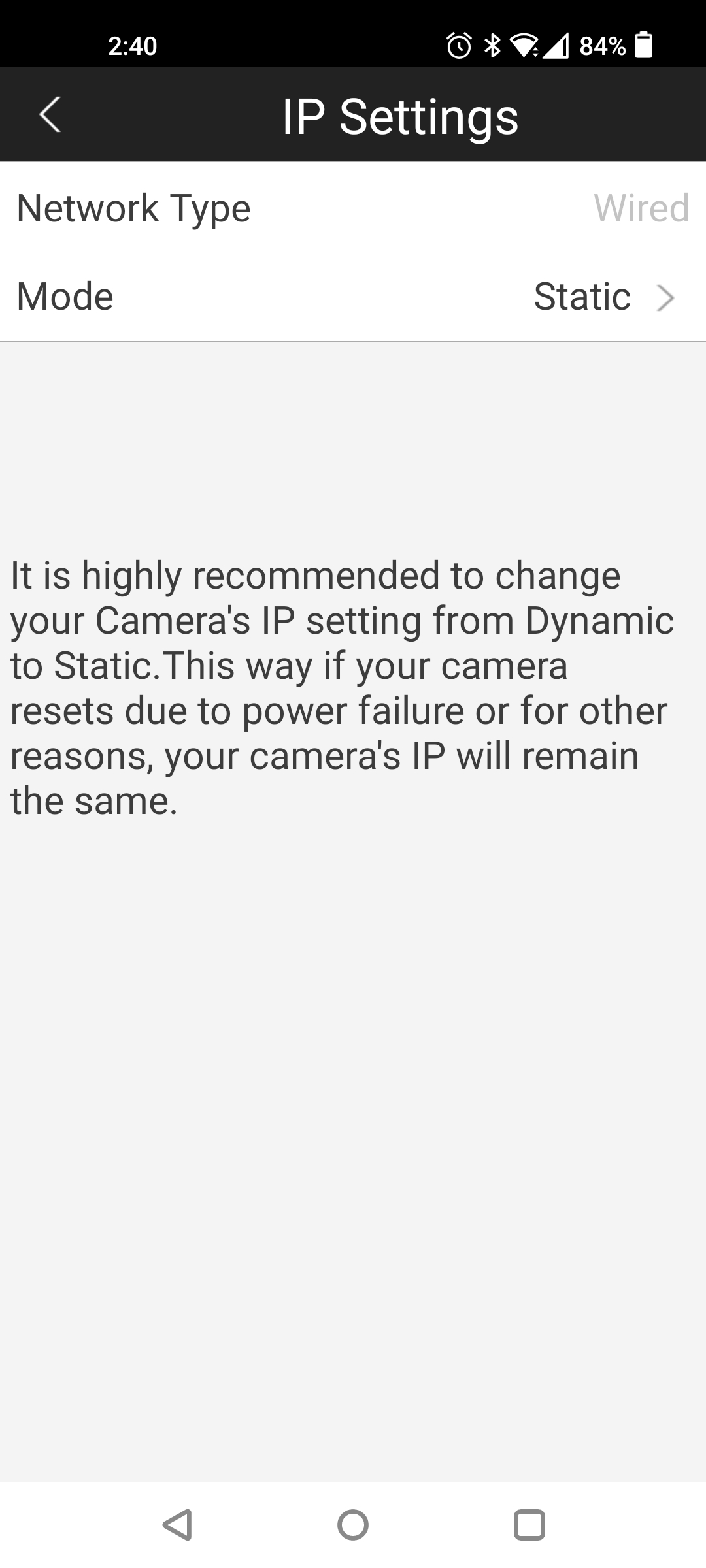

When I use the Amcrest View Pro app on my phone and go to the menu (upper left), then Configuration Center, then IP Settings, there is a message that it's recommended to use a static IP address for the cameras to ensure the addresses don't change on a reboot of the NVR.
Is there a way to view/change this setting somewhere in Amcrest Surveillance Pro on my PC? I went into the Device Config page and went through the various sections of settings but can't seem to find it. The only setting I could seem to find was the static IP for the NVR itself, not for setting each of the cameras.
BTW, I am using 5 Amcrest cameras connected directly to the NVR's POE ports, so the NVR is setting the camera IPs rather than my router.

Thanks for your quick reply. In the Android app, under the menu, I choose "Configuration Center", then "IP Settings", then my NVR name ("Home") and it shows the attached settings page and message.
So are you saying since my cameras are connected directly to the POE ports on the back of the NVR, if the NVR loses power and reboots, it will reassign the same IP addresses to the cameras and I won't need to go back into the NVR and replace the old camera entries?
Or, does it reassign new IP addresses and automatically update its internal camera list to reflect the new IPs?
Either way would be fine, as long as I don't need to re-setup my cameras in the NVR every time it loses power.

- Android app screenshot

Oh ok. Yes that message is normally for anything else. The NVR says it is setup Static already..
So yes the NVR gives the Cameras a IP address Per it's PORT. So starting in Port 1 that would read normally 10.1.1.65 and port 2 would be 10.1.1.66 and so on. However as I said if you took a camera from port 2 and put on port 4 or some other port then it could change to a higher non used before port like 10.1.1.128
When the NVR Reboots or you shut down and start up again as long as the Cables and cameras are not changed they will start back up where they were assigned to start with..
