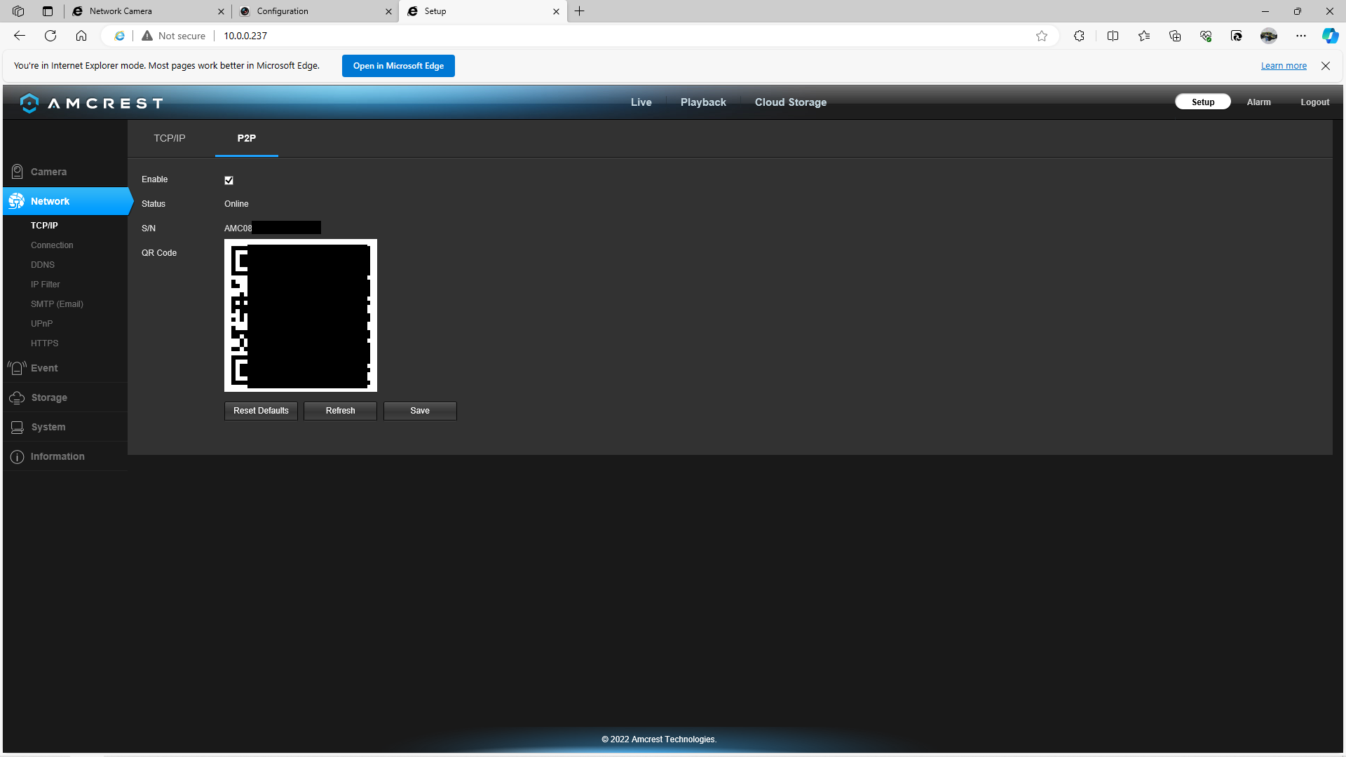

If you setup your camera with IP address then that is what your missing. You will want to remove the camera and setup using P2P by scanning the SN for the camera. or you will want to bring up the camera WebUI and go to the P2P area of the camera and 1 make sure it is turned on and second at that point you can also scan it if you are not able to scan the SN for the camera on the device. You can most times scan it from the Network P2P page on the Cameras WebUI..
Screenshot (760).png (113.63 KiB) Viewed 5063 times

Thank you Revo2!
That was a quick and easy fix...took less than 5 minutes to get me remotely viewing.
