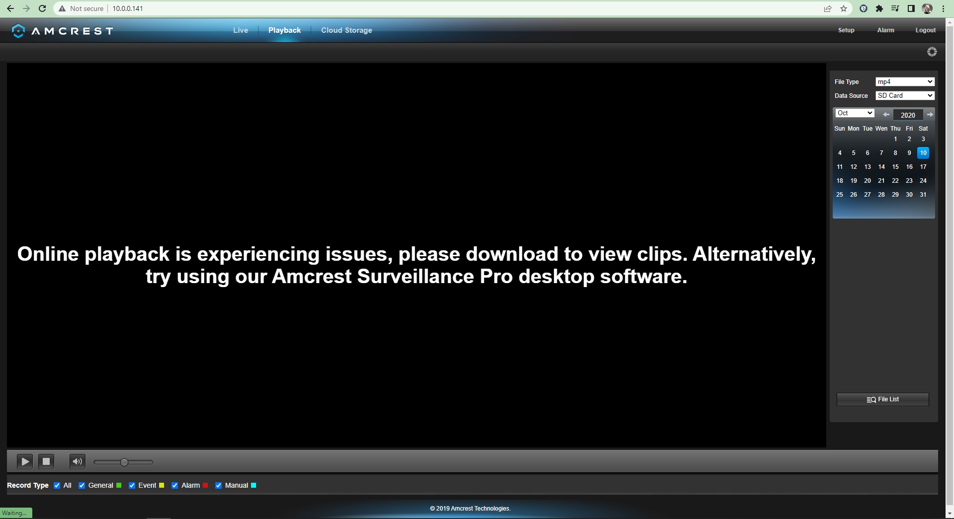

So I did test an 841 normal, and sure enough I was able to playback a few clips or a min or so of a few clips without an issue, Then I get this message in the Picture below.. This is Firmware from 2020..
Screenshot (3225).jpg (204.86 KiB) Viewed 2935 times
