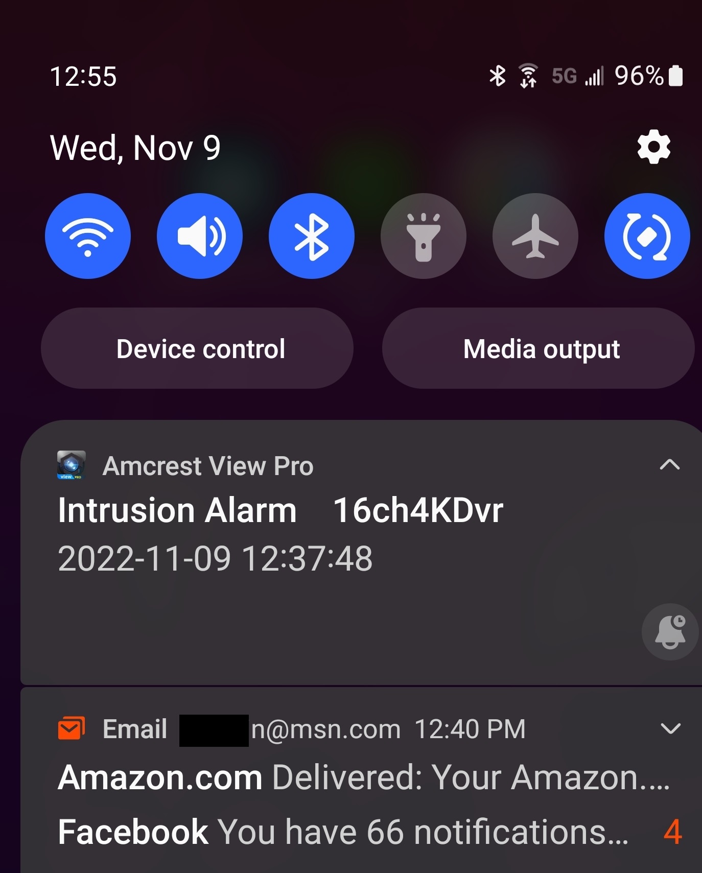

So right now I am using it on a Samsung 21 Ultra, It also works on my Samsung 9. So on my 21, I just turned on for a Delivery that was coming today. I got the Notice from my Amcrest DVR..
So I do have another device also chose and at first it didn't work, I had my son trip both areas that I have setup right now and now both are working as expected. The problem is when i first setup my DVR to alert on the Driveway, It didn't work and the other one stopped working even though the back yard alerted just a little while ago.. So I had to go in and setup them both again at the same time even though it is different units (One is my DVR the other is a NVR)

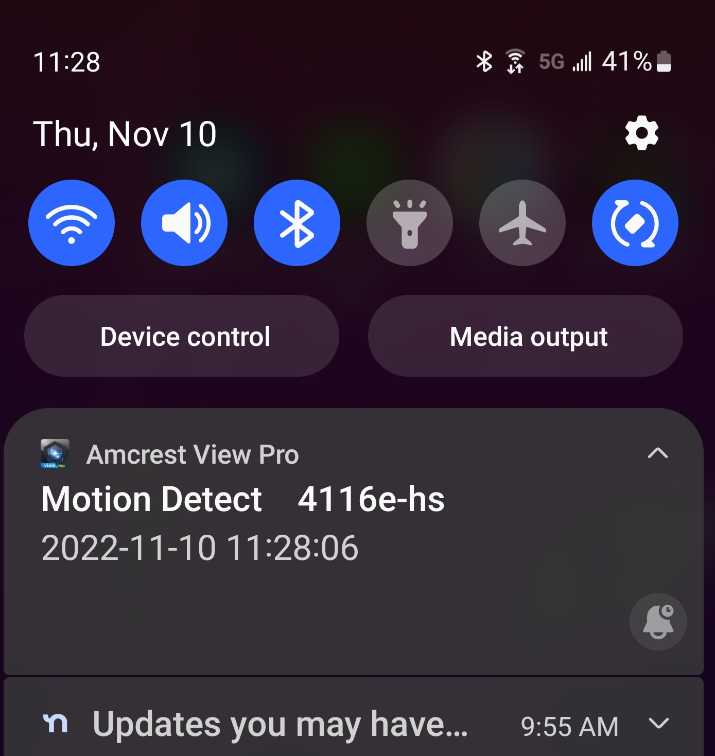

Sorry to hear that, It sounds like you having other issues that isn't related to Push at all.. So I have just now entered a new one and this one is for Motion only on my Doorbell camera that is on my 4116E-HS NVR Ch1. I don't normally use Motion but it is the fastest one that don't require someone to set it off other then normal traffic. Right after setting it up, I got my first alert. It is for Motion as that is what you had said your using..
