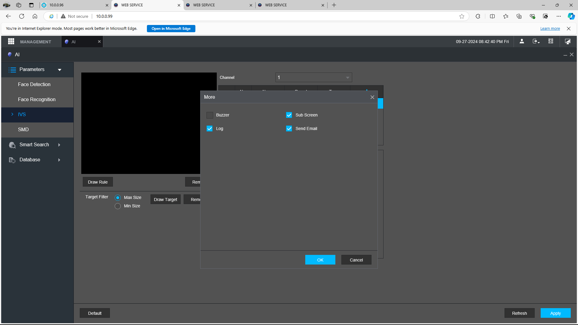

Re: Public email servers working in 2020?
Well if you get a email from a Test then you should have no issue getting the email from the DVR/NVRs and or IP cameras event. Setting up the email server isn't only thing you have to do, In some devices on the email page you have to enable it. In all devices you have to setup for what event you want email for. So take my DVR, setup for email, I want events emailed from my recorder on a Tripwire event, So I go to the channel with Tripwire setup and I click the email box and then when there is a trigger for that tripwire I will get an email. Then on the SMD page if I want an email for that again I go to the page on my DVR for the channel I want the email from I click that and now all events SMD for that channel I will get an email for..
Now on my Driveway, I have it setup for 2 different tripwires for one of my cameras, On that I have it setup that I want emails for humans that are coming into my Driveway.. If I had it setup with only 1 tripwire and setup for email I get both humans and vehicles, this way with 2 tripwires I get only emails when a human comes down my Driveway..
I would double check that your email is in fact enabled and that you have also setup the event you want emailed to you has a check mark..
